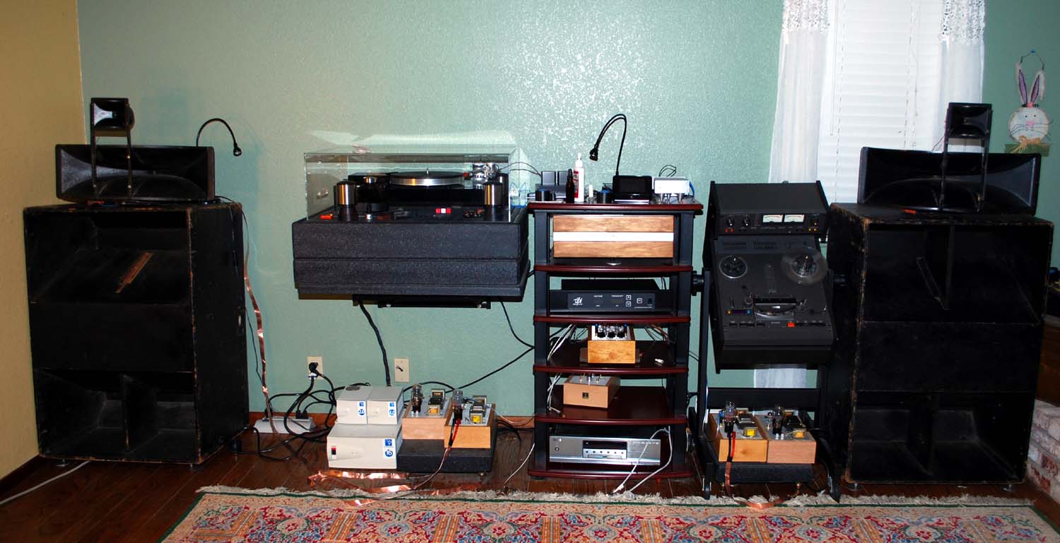

What I hear is marvelous. Approximately 102dB 1w/1m is really amazing in terms of dynamics. I really like the horns. I could probably live with the bass, but the bass bins are huge. As one can see in the pic, there is nowhere for additional subs! So, I am going to indulge on my wife's tolerance and let the new parts in Sentry's burn in for awhile. Still need to work on mounts for the horns. Clean up seems to be never ending as every time I touch the speakers I find new nooks and crannies full of decades of vintage crud!!

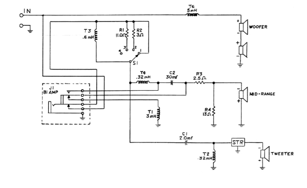

Simplify Crossovers
The original crossover can be switched in by inserting a dummy 1/4"phono jack into the J1 bi-amp switch. This takes the woofers, out of the x-over circuit. To bi-amp one would need to provide an external crossover and amp for the woofers? The mid/high's would be driven from the stock crossover input? I plan to reduce the x-over to eliminate the tweeter level switch,bi-amp jumper and the STR. Without the level switch the frequency versus power handling for the tweeter is 10w@15K. (See Curve 1 on chart)
This is my revision. This layout can be strapped for single amp or bi-amped. I dropped the .6mH,(Not sure why it was there!) coil in the switch circuit and added a 3uF cap in the mids to maintain 2nd order roll off. These values are basically the stock values. When I model, the crossover points are more like 500Hz & 5K Hz, 2nd order Bessel. The spec's call out 400/3500 Hz.
I am definitely not real experienced playing around with x-overs. The plan is to replace the current x-over box in it's entirety with the new crossovers, rather than hack up the stock units. Does it look reasonable? How can I improve the design,without getting too complicated? I would appreciate thoughts, suggestions and comments.

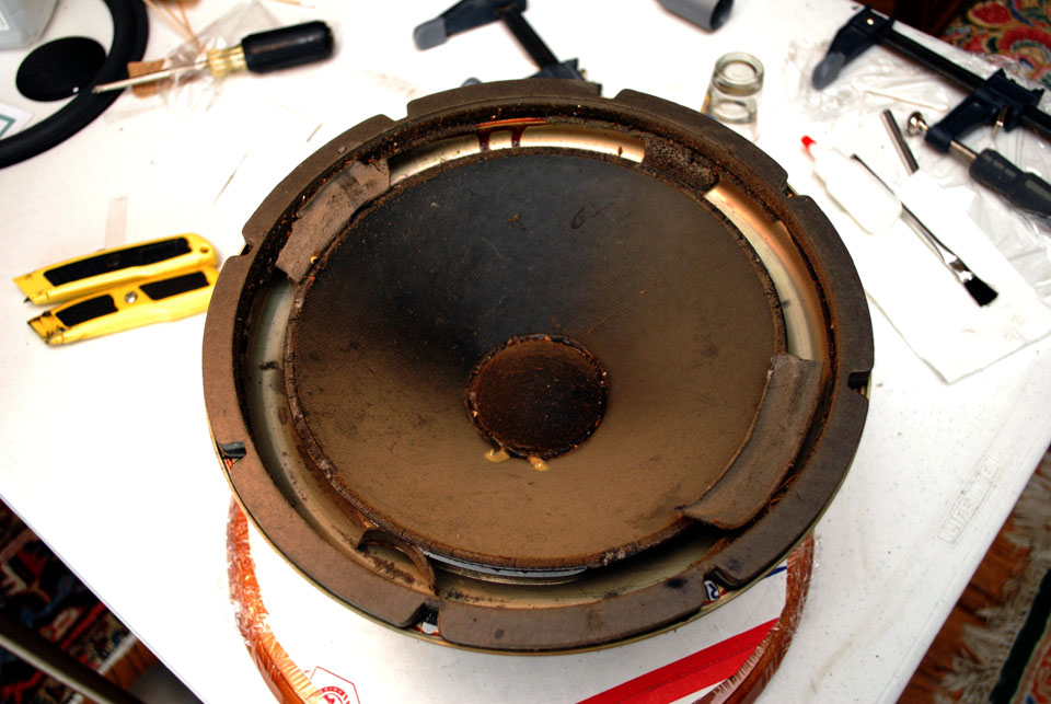

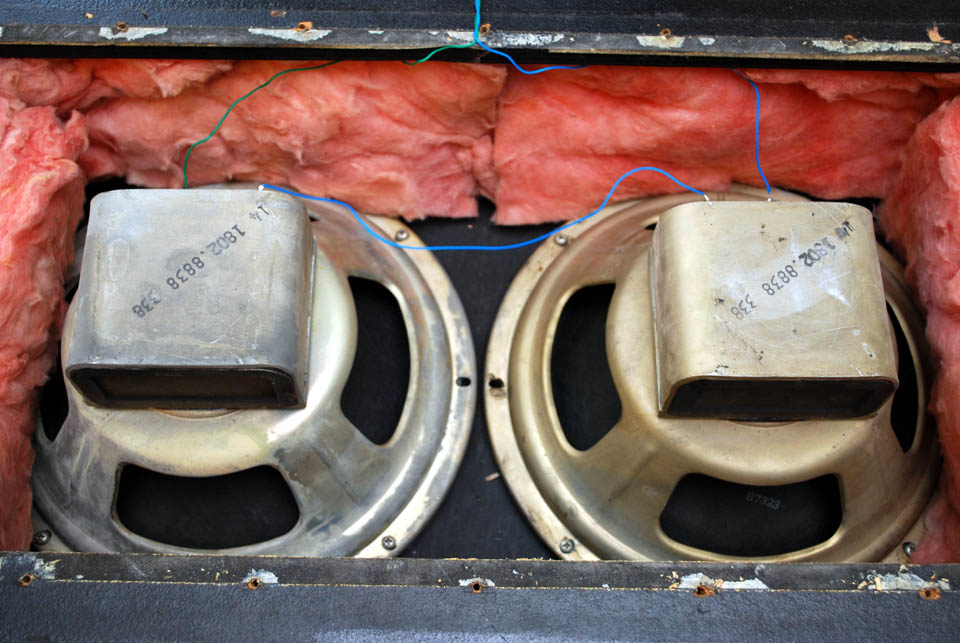

Here are my before and after pics on the Gefco woofers!

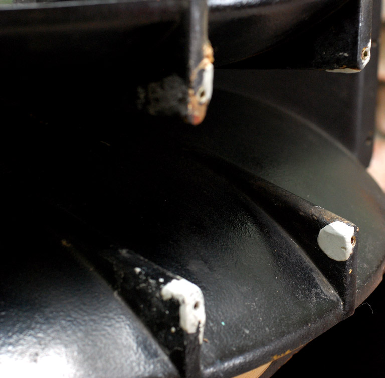

Here are the mid horn tweeter rails repair in process:
They just kept using bigger wood screws and more glue! 😱 I replaced with 8-32 threaded inserts and SS cap screws.
Roughed in repairs with 2 part epoxy putty. I used small brass wood screws to form foundation posts in the broken out structure.
Cleaned up wood screw holes in the "undamaged" horn, screwed in threaded inserts with Gorilla Glue.
