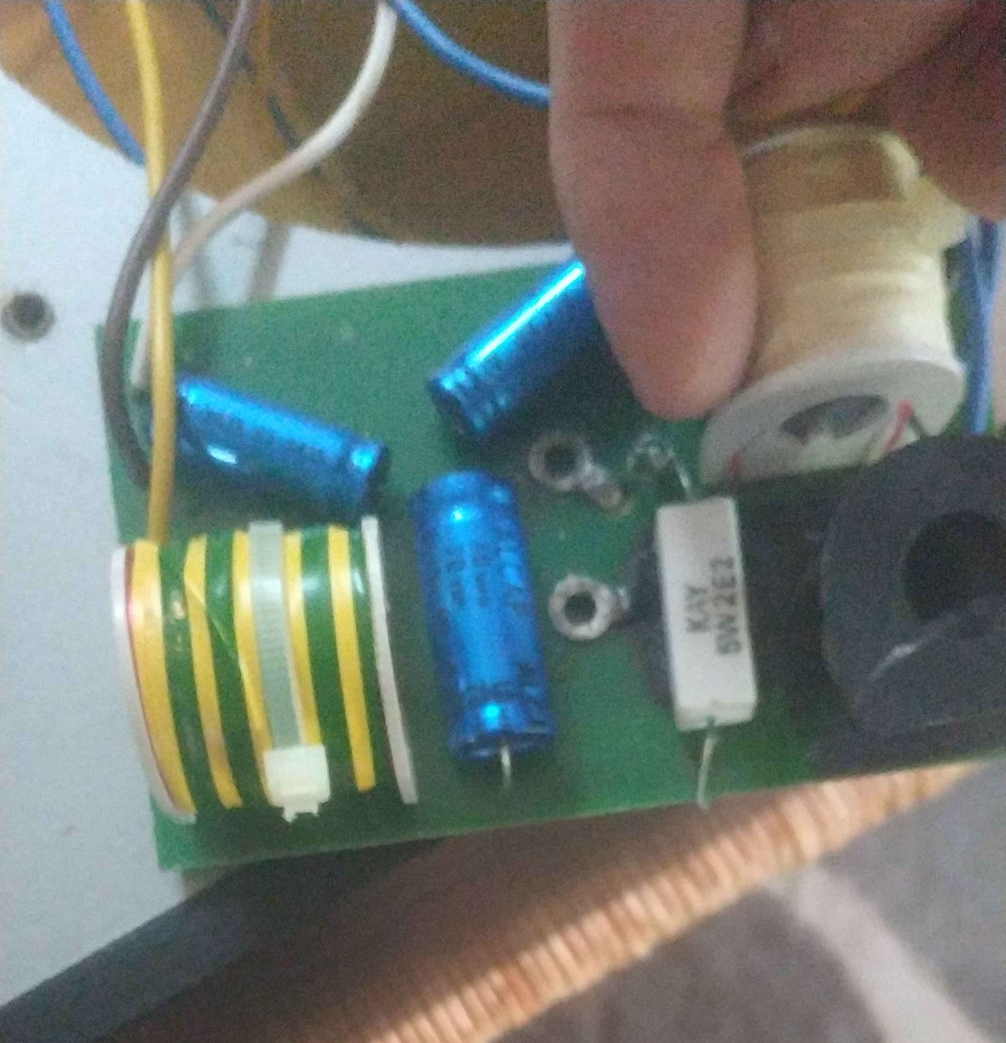

Help fixing crossover
Hi all, new here, looking for little help. I know this thread is quite the dinosaur but hey, thought I'd give it a shot...
I picked up a pair of DM330's for free - one of the tweeters not working. A quick test shows both tweeters actually work the problem is the crossover in one of the speakers. In fact in that speaker some one had previously replaced one resistor and did a brutal job of it... One leg wrapped around the edge of the board and soldered on the under side and the other simply wound around what was left of the leg of the old resistor... Not even soldered!
So I need to replace that resistor and I'm going to replace the same one in the other speaker - it doesn't look very good. Funny spots on it.
Am I right in thinking the resistor my finger is pointing to is a 5 watt 2.2ohm resistor?
Thanks!
E.

Earlier in the thread someone volunteered advice that Wilmslow Audio could supply replacements.
Any replacement driver would change the voice of the speaker. If the driver is faulty, I would recommend having it repaired. If it only needs the voice coil re-centring then that would not affect the voice of the speaker.
Similarly, be careful when replacing caps. B&W would have chosen the components with more than raw uF in mind.
Thanks for the quick replies! I was considering replacing the caps as well, but given how easy it is to get to the crossover I think I'll first replace those resistors and then see how things work. If the speakers sound good at that point then I might just leave them alone.
I think the drivers are all okay - at least a quick test they sounded good. But further testing required once I've got those resistors replaced.
I'm in Canada - Ontario, need to see where to source the resistors here. I like to support local when I can! Otherwise I guess it'll be an online order...
E.
True, I serviced a pair of B&W DM110 before, they had 9uF (two in parallel) in one channel in 10uF (single cap) in the other - in the same position. I did get lazy and replaced both as 10uF initially. Old caps measured low on capacitance. Speakers sounded good to me though once replaced so left them as both 10uF. Maybe wouldn't measure as well matched as new, but better than being worn out!
On resistors any 2.2R 5W ceramic resistor, or higher wattage, would work. Any decent electronics shop might have some (although they will likely just get them online).
