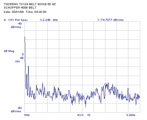

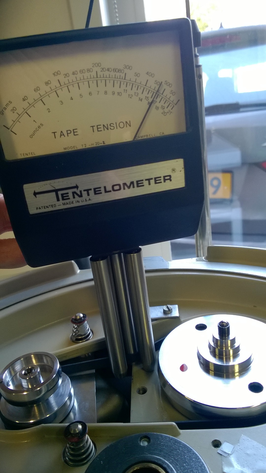

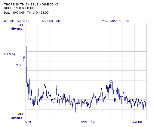

Belt noise 50Hz /60Hz motor pulley
Beltnoise with the Schopper belt measurements show there is lesser noise with the 60 Hz pulley ( turntable running on 120Volt 60Hz ) . Clearly audible .
Belt tension 50 Hz pulley 475 gr.
Noise spectrum

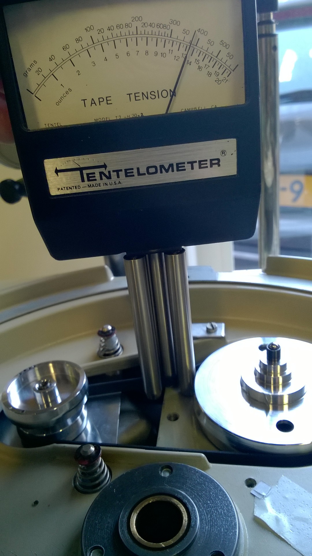

Belt tension 60 Hz pulley 375 gr.
Noise spectrum 60Hz
