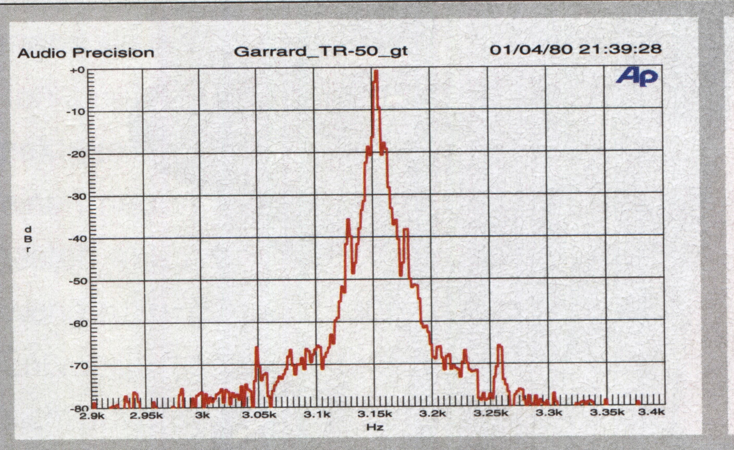

Interesting discussion I think they used the DIN 45545 Gleichlauf-Mess-Schallplatte there is no reference indication on this record I think its 5.42cm/sec can check it later.

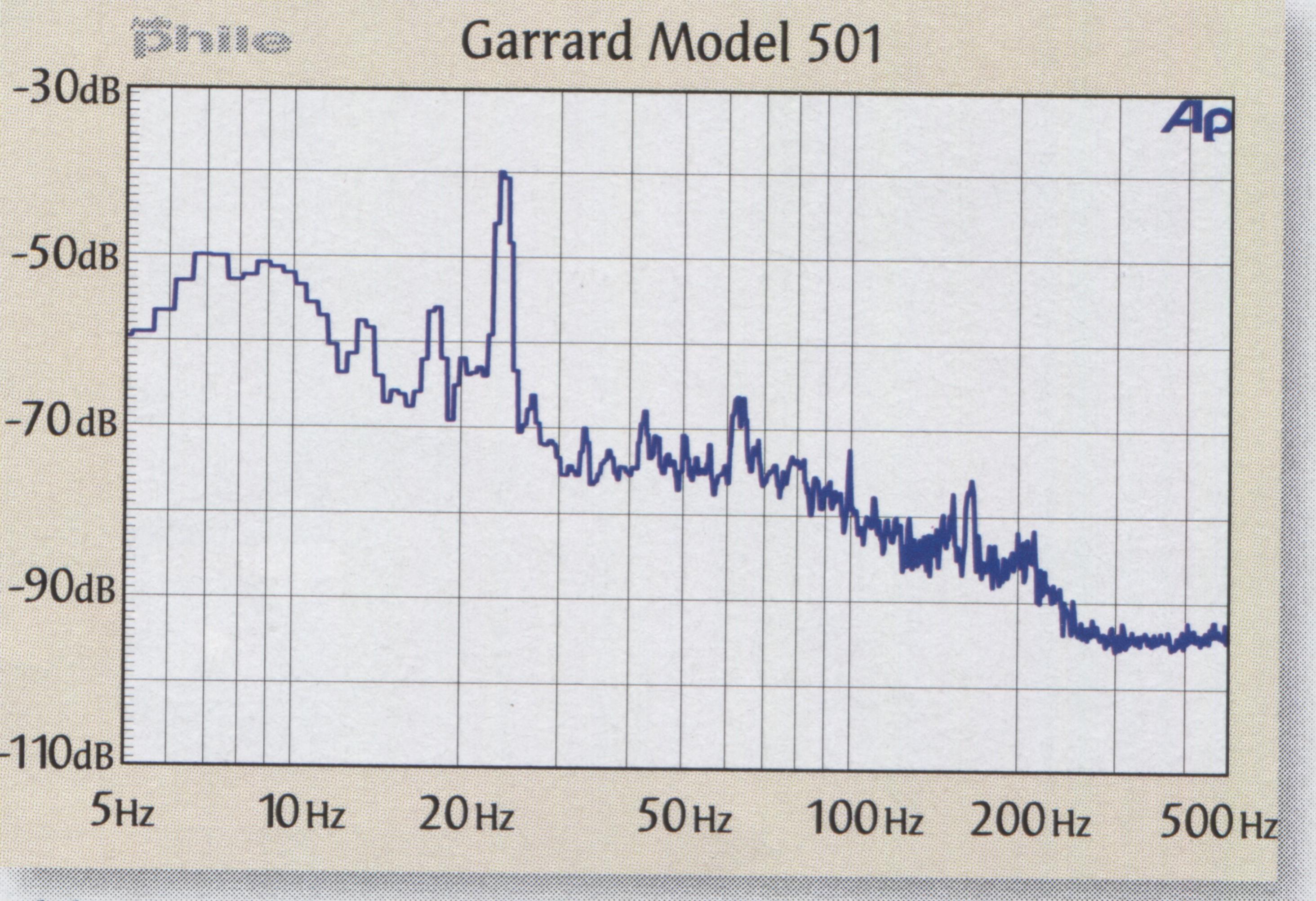

Concerning the rumble measurements on the 501 and the influence from the motor the first spectrum shows the rumble measured in 1999 by German Audio magazine both with messkoppler .
The horizontal resolution from the AP is not high enough to be able to read the exact frequencies.

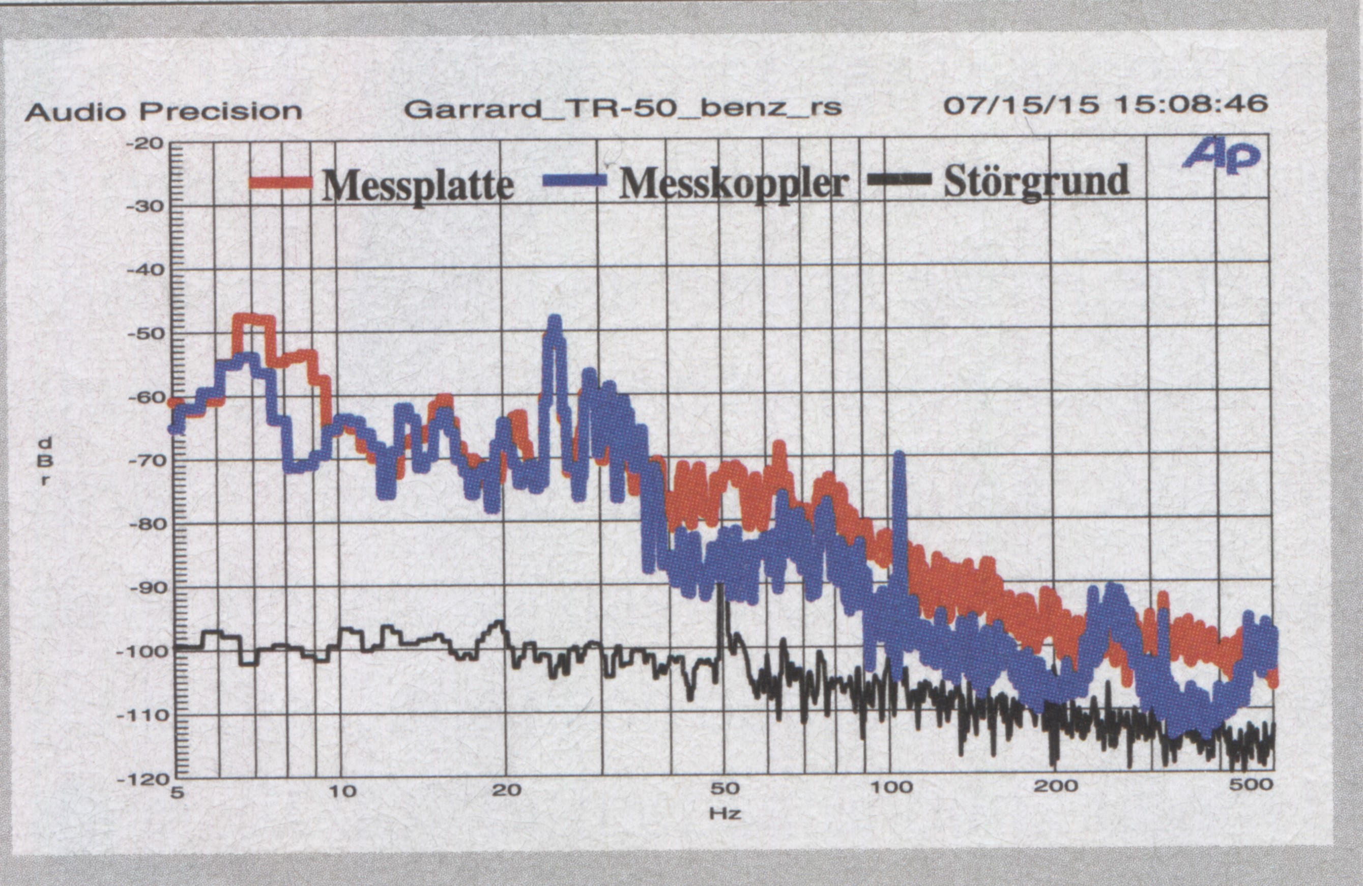

Problem with this measurements by messkoppler stays the cartridge/tonearm resonance influence on the measurements .
I use higher accuracy vibration measurements in addition to the standard W @ F measurements
Motor freq.about 24 hz at -40 db Motor Vibration 2xfl at about 100hz -73db.
Later version the Transcription Reference in 2015 ,blue spectrum messkoppler, motorfreq. about 25 hz now at -48db Motorvibration 2xfl about 105 hz -70db

Thorens TD124 Garrard 501 speed spectrum
Motor vibration 2xfl at 100Hz , with a span from 500Hz the peak is sharper !

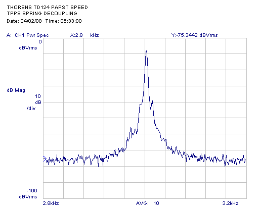

Thorens TD124 with Papst motor spring motor decoupling span 400 HZ

Garrard 501 speedspectrum span 500hz !!
