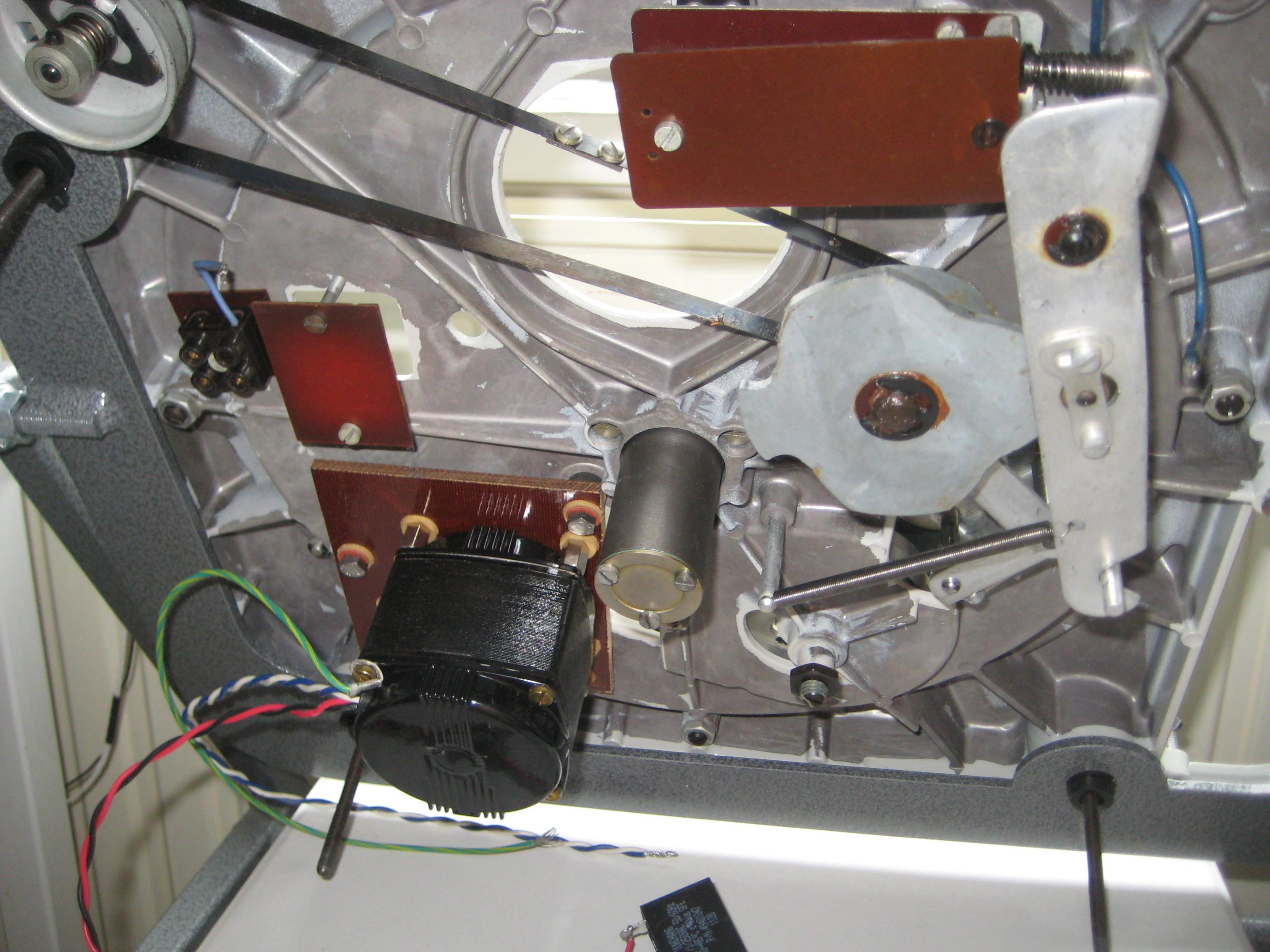

Pitty ! I"m working on another motor for the TD124 here is a prototype with a Bodine motor is not ready yet !
Volken

Interresting do you have a number from the motor on the picture its difficult do see, there are four wires for motor connection correct ?
In the motor powersupply I see two outputtransformers ?but no drivers and the crystal from the oscillator .
The balancing from the outer rotor from the Papst is important I shall try to fix tape on it and see what it does on the motor frequence from 24 Hz . At the E 50 motor a small unbalance translates in a higher vibration amplitude.

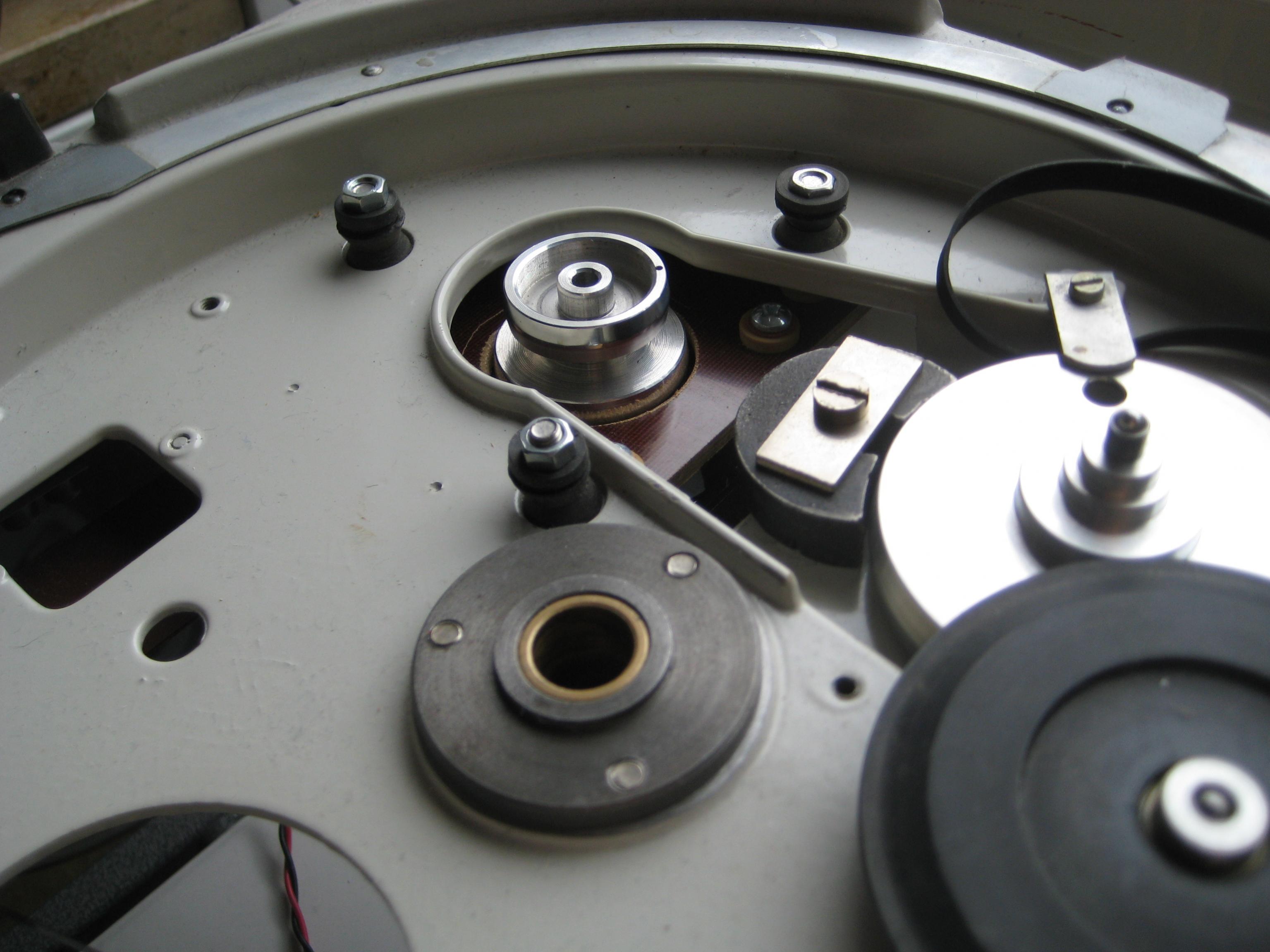

Some news,
I received the idler wheel and the Teflon thrust plate from Audiosilente .
I am happy to tell you that the plater now stops in 2 minutes and 8 seconds !! With nylatron stopped in 45-52 seconds.... Same oil same quantity.
I think due to that Teflon thrust plate and the new idler wheel with the o ring ,the soundstage improved , became more wide and more holographic, sound is more dynamic and even more accurate,with even better PRAT than before.
Also less noisy due to new idler wheel an o ring.
That 124 is improving all the time and I am happy for that.

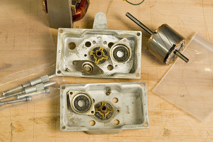

Help with my E50 Motor
Hello,
I've rebuilt a E50 motor before, but that was 8 years ago.
I'm now doing it again for my brothers early 124, (s/n 2972). I've torn the motor down, and am getting ready to put the bearing assemblies back together, and I'm not 100% sure of the order of the bearings, retainers, felts, etc. I know I've seen photos somewhere, (I think here.) Anyone have a link to view?

Take pictures of how you think it goes back together and post here, I and others can advise. It is fairly obvious, but bottom bushing narrow end faces up, top bushing narrow end faces down. Springs fit only one way and sit on the felts.
Impregnate the bushings in hot oil, allow to cool, make sure to really soak the felts prior to installation.
Use 20 SAE wt 3 in 1 electric motor for motor lubrication or 20wt non detergent motor oil if available in your area.

More images of motor disassemble / assemble at link provided.
I've documented my motor refurb process a few times and photos of that can be found on my web site within the Td124 dept. Probably the page linked here is the most complete.
2078_E50
Also, I've written an overview on Td124 maintenance in general at this link:
TD124 Dept Scroll down to "notes on the TD124" and click that link.
-Steve

I was cutting my own felts from some heavy industrial felt (1/8inch thick) I'd sourced from McMaster-Carr. I used a punch to make those felts.
Although it is possible to clean/rinse and re-use the original felts if they're not too far gunked up.
An important factor to keep in mind is not to allow the felts to fit too tightly around the self-aligning motor bushings. Otherwise you'll have trouble getting the bushings into close alignment to the rotor shaft.
For the motor thrust pad material, I've been using Delrin. The Delrin I have is white in color. Like the felt, the Delrin sheet I sourced from Mcmaster-Carr, then use a plug cutter/drill press to cut the necessary sized circular disks from it.
