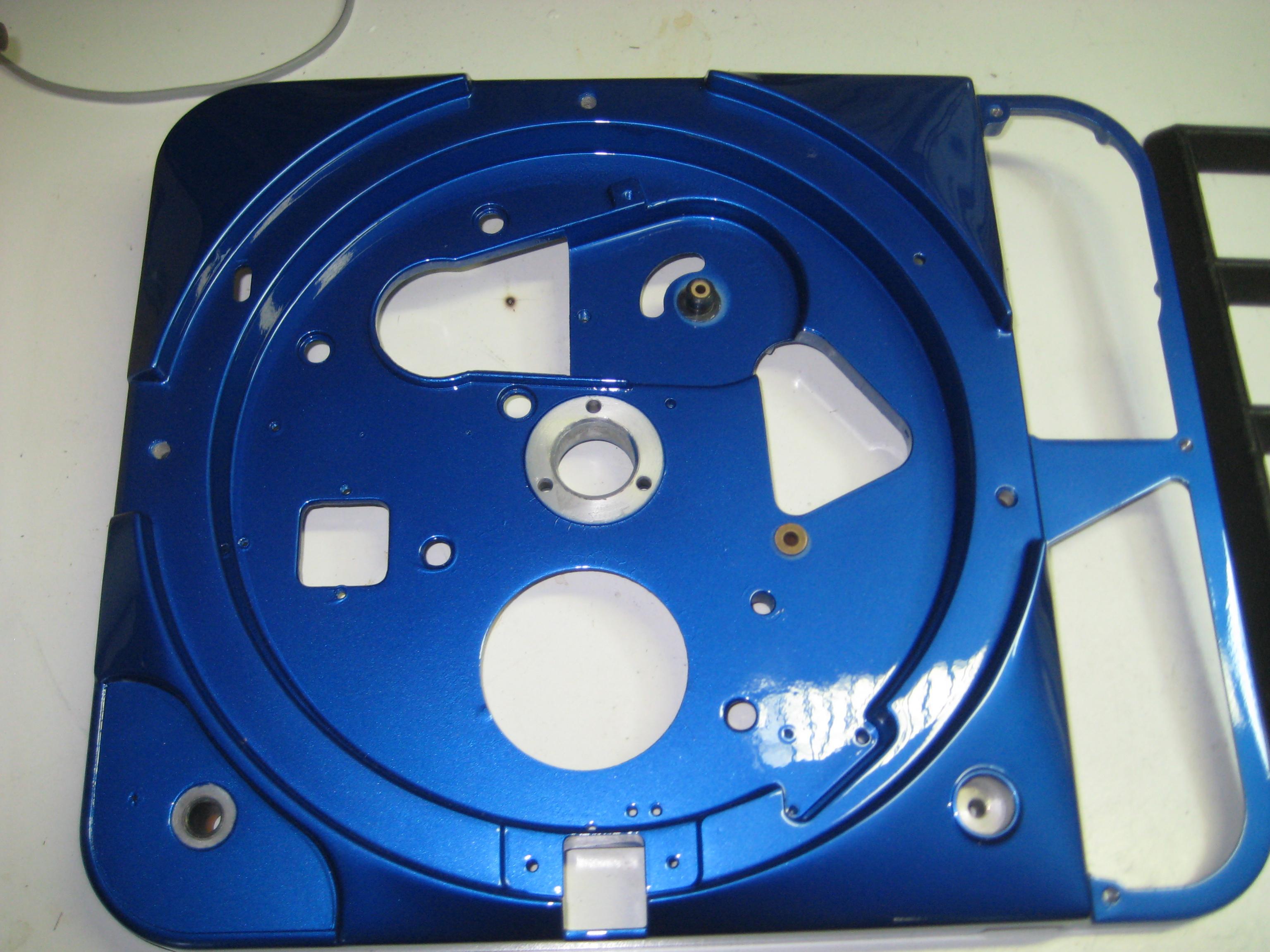

Just received my chassis back from Swiss in Ciel Bleu !
Volken
Cool. Dark blue metalic. Almost a "candy" blue. I like it.
That brings up a future project. I have one mk1 chassis that is in need of a repaint. And I've been mulling over what to paint that one. But I know it will receive the Papst Aussenlauffer motor I picked up a while back. Non standard all the way.
Volken. what is this blue one going to have for mechanicals?:) Inquiring minds want to know:cool:

Volken. what is this blue one going to have for mechanicals? Inquiring minds want to know
Ronald ,Steve I post the rebuilding proces soon !
With the Papst motor spring decoupled and phase tuning for min.vibration !
Treatment of the chassis is powder coating.
Volken
Powder coat, great! I was about to ask if anyone had tried powder coating, so I guest the answer is yes!
