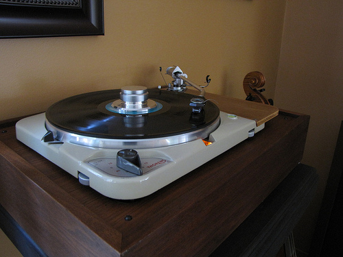

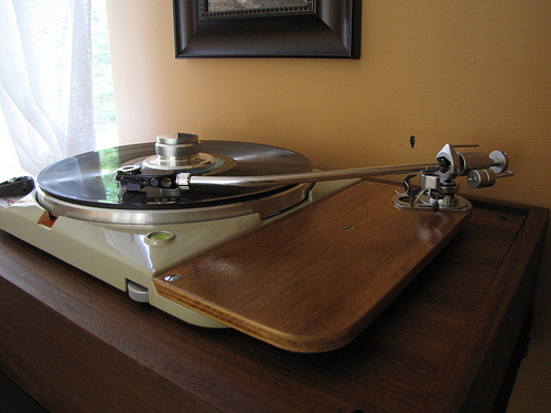

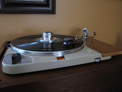

Sorry to brag, but I'm kinda proud of this one.
I don't want to hijack Kevin's thread but wanted to show you guys the result of my restoration.
I bought this tt last winter from an older gentleman who was moving out of his house and into a smaller appartment. The tt was very dirty and not functionning.
Thanks to the help of Kevin and others (The Analog Dept.), I've managed to refurb this tt all by myself, except for the tonearm, which I sent to Alfred Kayser (SME Tonearms in Barrie, ON) for a complete rewire and rebuild.
Things done to the tt:
-motor rebuild
-improved motor suspension installed
-main bearing and thrustplate upgraded
-strobe lamp replaced
-main platter rubber discs upgraded
-new bubble level installed
-completely disassembled, cleaned, relubed and polished
Motor comes to speed in about 2-3 minutes with minute adjustments, platter spins for about 2min40sec. when powered off, completely silent...
Here are some before and after shots:
(don't mind the washer on the headshell...waiting for original lead counterweights )
Thanks for looking!

Been playing the Thorens tonight; never ever thought vinyl could sound so good, and especially on a piece of equipment the is older than me (1957 vs 1963)!!!
Very cool pictures, Skylounger.. I note the use of the mandatory tracking force enhancement device on your headshell.. 😛 I've had to do this in a couple of instances with my Schick arm with lighter headshell/cartridge combos..
Mine is a very late II and I've not yet had anything that performs better.. The effort I put into mine has been well rewarded..

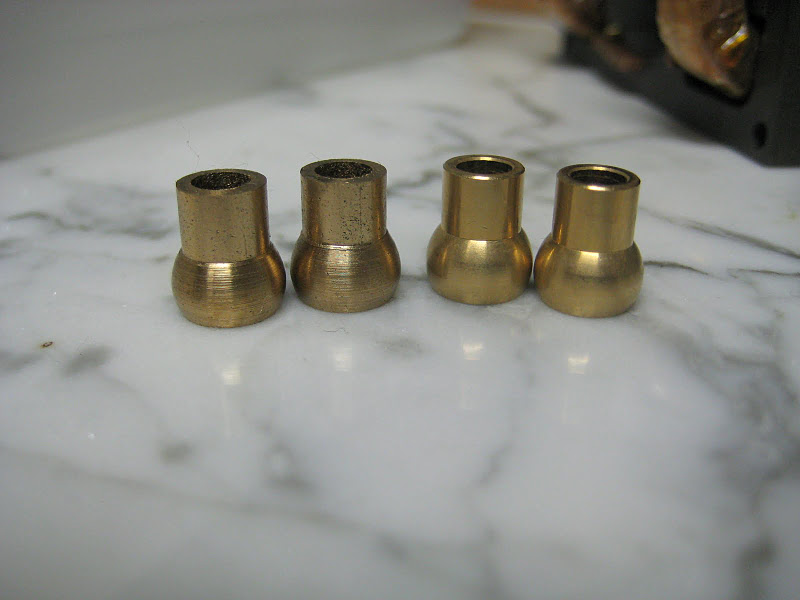

Hello
I bought a motor rebuilding kit from Mirko (ebay seller )
The guy who I let renovate the motor said that the bushings delivered with the kit doesn,t fit properly and the motor doesn,t come to proper speed even after running in. He now wants to replace them with (very expensive 225 euro ) Schopper bushings . Is there anybody who has the same expience with the bushings from mirko (or on the contrary : good experience )
Is there a workaround ? prolonge the running in time ?
thanks jeremy from the netherlands

How has he made this determination? A cold motor will take several minutes to warm up sufficiently to run dead on speed. I have used these bushings in a number of motor rebuilds for others and have never had a problem - performance is very similar if not identical to that of original low hour bushings..(I did not purchase the bushings, that was done by one of the fellows whose table I overhauled.) Motor run in is typically 100hrs or more with new bushings. What weight oil did he use, and did he properly impregnate them with 20wt oil prior to installation?
I used bushings on mine purchased from jec965 on mine which seem to work quite well. (Now nearly a year in service.)
I'm assuming that when he says they don't fit properly that he means they are too tight? They should slide on easily, but with no discernible play and other than that I can't say - access to a dial gauge, calipers, and other measurement devices being necessary for a careful determination.. It is possible I suppose that a new batch of bushings could have excessively tight tolerances..
Hopefully User510 will weigh in with some additional thoughts. In the mean time check the analog depot TD-124 rebuild pages: http://www.theanalogdept.com/td124_dept.htm
Motor stuff here: http://homepage2.nifty.com/pantone/thorens/overhaul_1.htm
Hi
Thank you for your reply
The ebay seller is Sq385 , so NOT jec965 see :
E50 Motor Rebuilding Kit for Thorens TD-124 Turntable | eBay
I will post a picture of schoppers bushings and the ones the ones from mirko side by side so you can see the difference .
