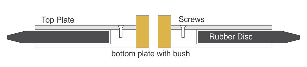

what are the advantages of full metal 'O' ring idler ? Wouldn't a quality circular rubber sheet pressed between two circular metal plates damp vibrations ? Like precision made gasket type (4/5 mm thick and tapered at outer edge) rubber wheel sandwiched between metal plate. This way we can replace worn out idlers etc.

That would be an impractical and overly complex way to accomplish what is already a simple arrangement
Squeezing a rubber sheet would more than likely create the circumference to be out of round and need grinding to spec and would it stay that way over time?
You would create two different tensions on the rubber , under the plates and what exits and touches the platter.
The O ring is stretched and would stay in one mode for its life span. it should be super glued to its pulley IMO

I agree on complexity. I am not an expert on anything But if one wants to DIY it could be an alternative; if new idlers are expensive. Only light pressure should also work so as to not to squeeze rubber too hard. A C Clip can be used instead of screws. Or superglued (or any other glue) on side surface. Metal plates can be replaced by Acrylic. Rubber edge can be ground after fitting. Basically I am thinking of on avoiding molding rubber, easy replacement of worn out rubber, affordable DIY aspects of it.
