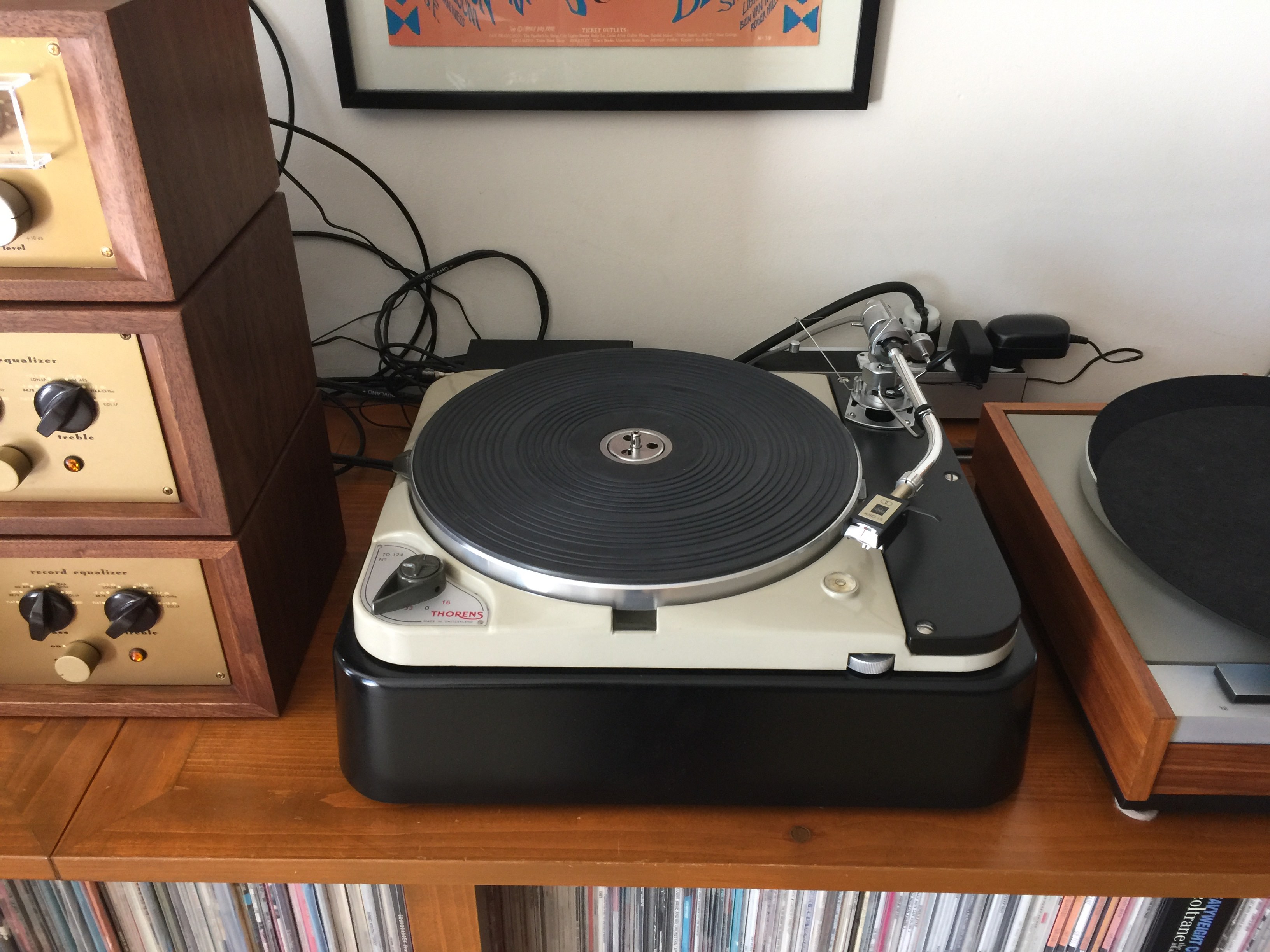

Hello,
Over the last few days I've enjoyed reading the worlds longest Thorens 124 string! I've owned and used my Mk I turntable for going on 40 years now. It is Serial #57393 and I bought it used for $50, including a Rabco SL8E tonearm (which I still have). I own 7 turntables and keep coming back to the 124. Over the years, I've gotten most of the Schopper upgrades (non-magnetic platter, main bearing, motor rebuild) and I've installed the Hanze HiFi motor springs and idler noise reduction kit. It is a really nice and practical turntable to use and usually hasn't been any trouble -- less than most of the others -- although I have had the stepped pulley noise issue over the last year but managed to fix it just before I found your string. (I cleaned lubed the bearing and cleaned and polished the pulley.) I would have saved myself a lot of trouble if I'd found you sooner. My turntable also runs a little fast. I plan to fix that with the Schopper PSU when it becomes available again.
I had the turntable in a Jim Campbell solid plinth for several years, but recently reverted to the open frame Ortofon style I've used most of the time and think I like it better. I use an SME 3009 II (unimproved) tonearm with 3012 counterweights and an EMT XSD 15 cartridge which I really like, although I'm looking for an SME FD200 damper to try with it. I'm attaching a picture of what my turntable looks like now -- hopefully that works.
I do have a small problem I hope you can help me with, however: I can't engage 16 rpm. Is there an adjustment for that? I've never used it, and probably never will use it, but I'd like it to work.

Looks very well the chassis has the original color ?

I've rebuilt a few of these and there is no specific adjustment I can recollect that affects only the 16rpm speed and not the others.
If you have not cleaned and lubricated the speed changing mechanism and cam it is probably overdue at this point, that's where I would start. Look for old gummy lubricant residue and remove it with isopropyl alcohol, follow manual guidelines for lubrication. (Available from Vinyl Engine - The Home of the Turntable)
Thanks Kevin. I read through the owner's and service manuals (again) and didn't see anything about lubricating the speed selector linkages. Would be it be correct to assume that the same 20w oil used elsewhere on the turntable would be OK for lubricating the linkages? Or should something else be used? I've been pretty good about keeping the various bearings oiled, but don't think I have ever lubricated the linkages.

I use a light teflon based general purpose grease for lubricating linkages and cams. There are a number of other choices in suitable greases, and others may have more specific recommendations. Don't use automotive greases due to potential chemical reactions with the additives.
Bushings should be lubricated with oil, and the 20 sae wt oil recommended elsewhere in the thread is fine in most cases, 30 wt may be better for the stepped pulley and idler based on recent experience.
I'm running 30wt oil in my modified main bearings these days, that's probably not something I would recommend for most tables.
