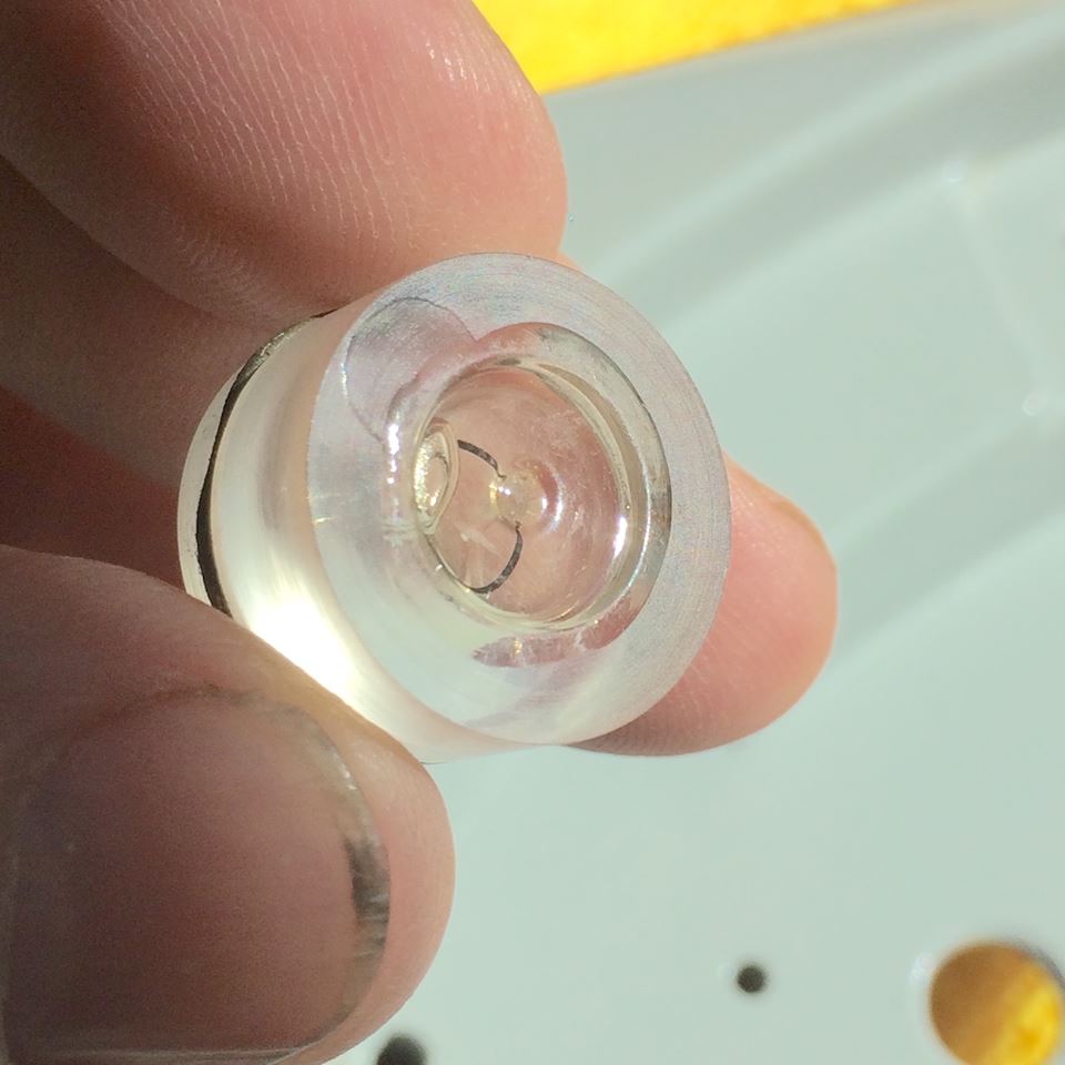

I will need to replace its bubble lever as it seems empty...How can I remove it without to cause any damage to its housing that is part of the chassis.. I think that if I could soften the glue that holds it by using alcohol or ?.. then it might be easier to remove it by pressing it?
If not that 😡smoother way, have I to push it strong from out side to inside using a.. hammer?

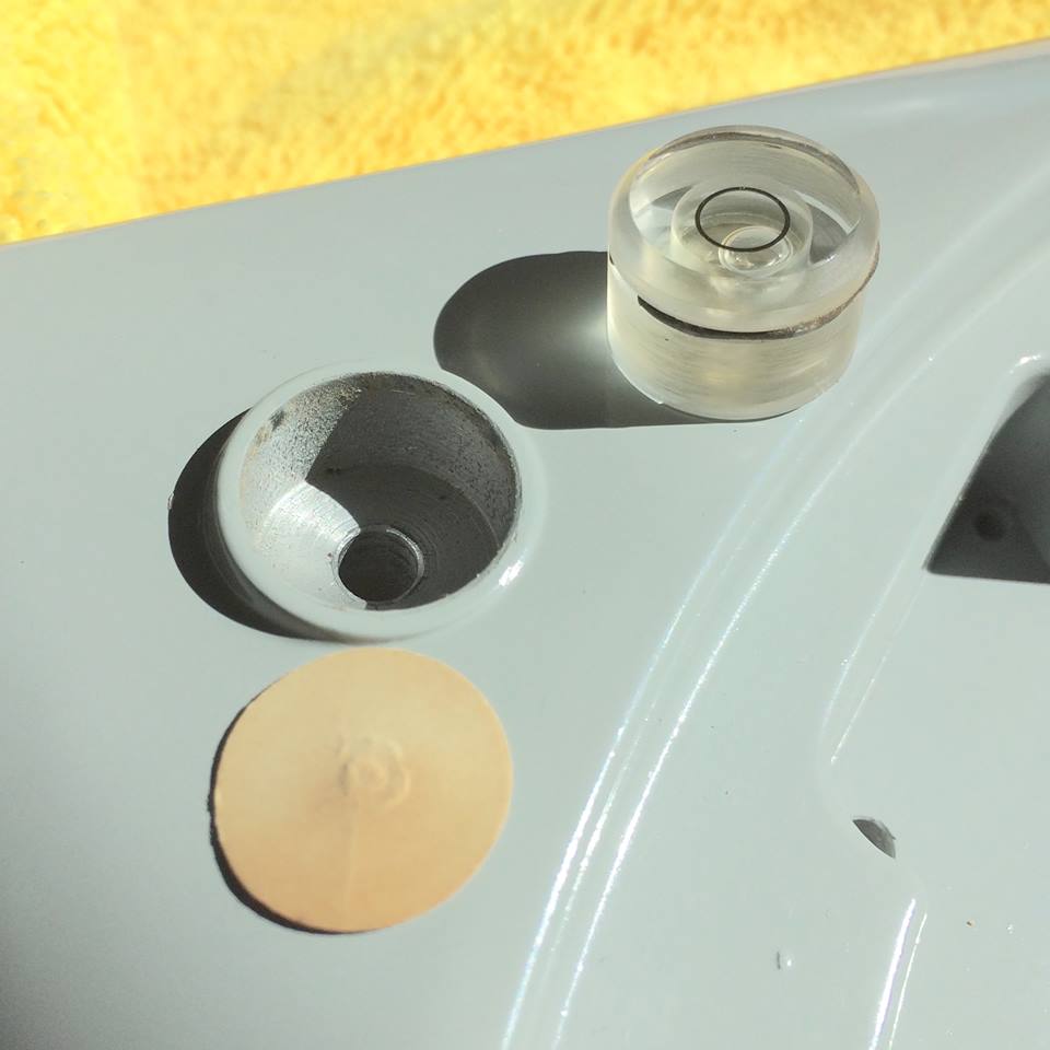

There is no glue holding the plastic bubble level in place. Rather a spring clip that fits in a machined groove near the top of it. The clip, which is circular and cut so that it isn't a complete circle, makes tension between the body of the level and the bore in the chassis where it fits into.
To remove the bubble level you pretty much need to disassemble most of the chassis. (how I do it) Then place bare naked chassis, face down into a padded surface so you don't damage the finish on your expensive TD124 chassis. Next you need a piece of hardwood dowel to fit through the hole in the chassis underside where the level fits. With said piece of hardwood dowel making contact with the bottom of the bubble leve, use a small light mallet to gently tap out the bubble level. It will tap out with small amounts of force.
To assemble the new bubble level in place, do reverse of disassemble.
It's easy. Just don't break any other part of the TD124 while doing this.
-Steve
Ps: source for replacement bubble levels..... Mirko, Simone Lucchetti, other sellers on ebay. etc. Mirko has supplied a couple to me that were exact replacements.

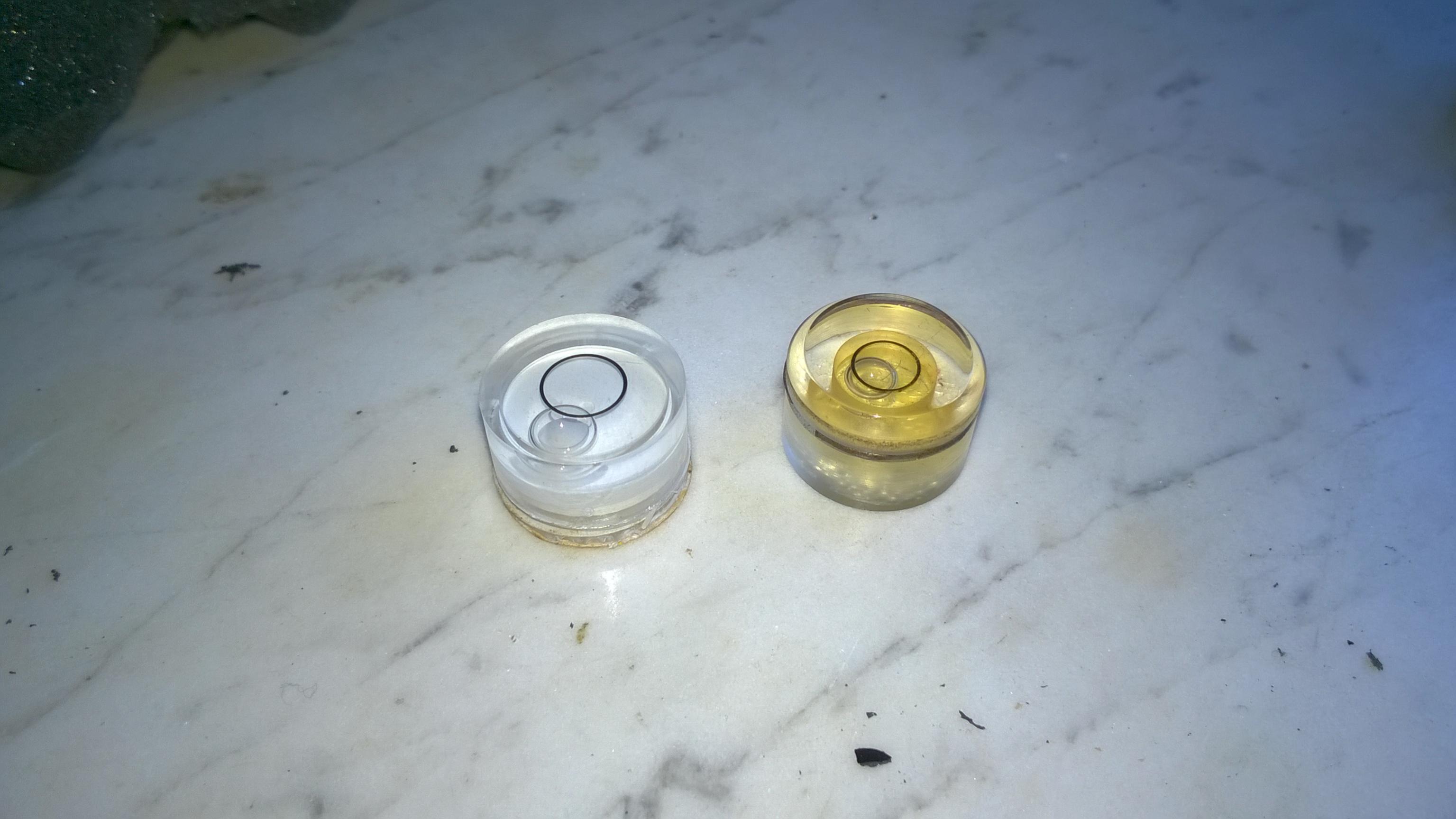

Hi ralphfcooke,
The yellowed that you have and works fine is the original and most are yellowed like your's. If mine was ok I would not touch it and not replaced it, as it would lose the originality.
On the other hand a new one would be nice , clear and maybe more accurate than the original. If a new replacement could be a very well made and more accurate, the way to remove the old one and replace it with that new one could be easy and safe, then I could do that.
But I must do that as mine is empty and does not work..🙁
Maybe an idea to refill it without removing it and probably damaging it? What is the liquid to refill it? If i could drill it from underneath by using a very thin drill and press the recommended liquid so to be inserted inside it,and then to put a silicone adhesive so to close the small hole?
Thank you for any ideas🙂

I usually replace the bubble level while performing a refurb to the rest of the motor unit. So it is normal for me to see the chassis minus its mechanical appendages.
For certain you'd need to remove the platters flywheel with brg shaft attached, upper platter and of course the tonearm. Tonearms are easy on the TD124.....unscrew the three M5 machine screws holding the armboard in place and, usually, that is all that is needed to lift the arm and arm board off the chassis alltogether. And find a nice safe out of the way place to park the arm and board in an upright position.
I'd use something to plug the bearing housing to keep its oil in and the dirt out. Because you will have the chassis upside down while pushing the old bubble level out.
That should be enough disasembly to replace the bubble level, I'd think.
Mirko for the new bubble level.
-Steve

Steve is the height from these replacement bulb also 12mm or the often seen 9mm ?
On my 124/II the bubble level was not held in place by adhesive. A metal spring clip holds it in place. This clip sits in a groove on the bubble level and is located very close to the top of the level. Beneath the level is a circular piece of coated paper. I removed the level by first heating the chassis to help expand it a bit, then using a wide diameter punch to gently tap through the chassis hole on the underside.
My error. Didn't mean to duplicate what Steve said about bubble level removal. I saw the OP, not the reply. It's early. I need more coffee!
12mm. Well there was no difference in height standing side by side and the replacement level had the same chamfered edge on top as the original.
The replacement level can be seen in this partial assembly.
-Steve

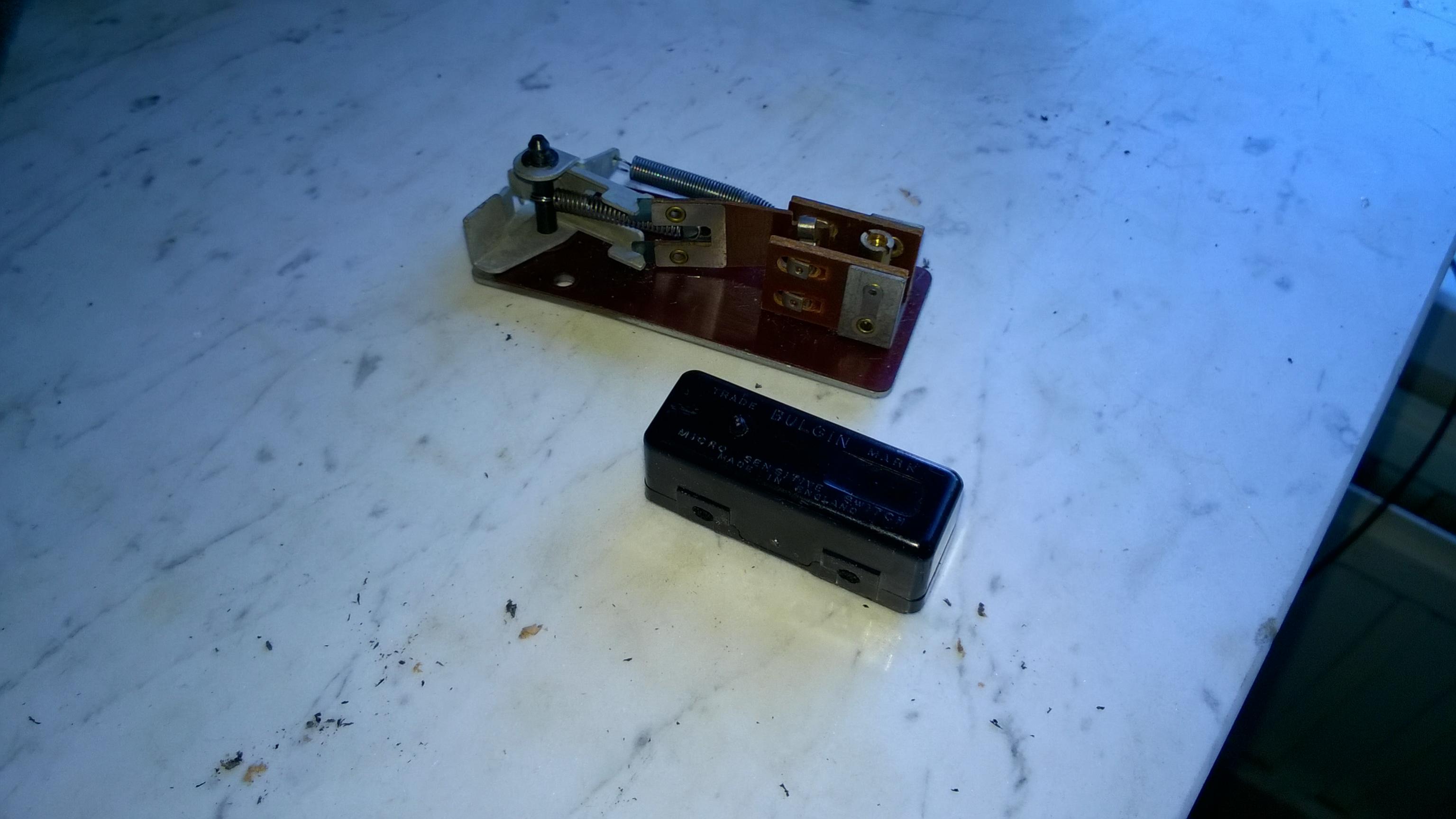

The external switches are easier to deal with. The earlier 'Bulgin' switch requires disassembly. But it is simple; just press the pin through and the switch disassembles completely in your hands.
The bulb-holder issue was a wierd one for me. It wasn't until I noticed the crunchy action in the one spring pin that I had a clue. I'm guessing there might still be an oem replacement for this part somewhere in a thick catalog of parts. My reason for hope is that we can still find a replacement neon bulb, so why not the bulb holder!
-Steve

Beware, these bubble levels are only for fun.
They are not accurate at all, even the genuine one.
To make the level you may take a true level.
