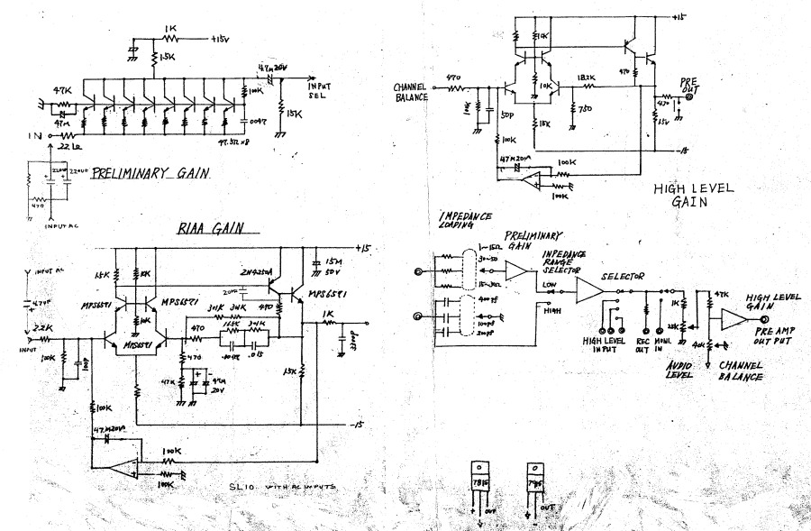

There have been a few threads over the last few years on the SL10 preamp and I owe a debt of gratitude to the various people that have posted hints on how to bring this classic preamp back to like new condition. I picked an SL10 up a few months ago and finally got around to restoring it this weekend. A quick listen has been very encouraging. It sounds very, very good with a phono stage that is outstanding. The sound of vinyl with this preamp is better than any other phono stage that I've heard in my system. I like it better than my ONO clone on MM input. I haven't given the MC input a listen yet. I also like the line stage better than my FET 10/hl line stage, which is already a very good line stage. The absence of output coupling caps and the better quality power supply makes a difference. Upgrading the volume control and removing the balance control also improves the transparency.
Here are the changes that I made to the preamp.

One thing I didn't do (yet) is change the AC coupling caps for the phono inputs. There are 4.7uf 25v tantalums at the input to the MM stage and 2x 220uf 10v tantalums at the input to the MC stage. My preliminary listen to the MM stage with the original caps in place sounded quite good. How much is there to be gained by swapping these out. What would people use? Newer electroltyics? Blackgate non-polars? Organic electrolytics?
I've attached the schematic that Nelson shared a few years back since it's no longer available other than via the internet archive.

You have performed a fantastic up grade in your LS-10 preamp. I have a suggestion or two, to offer.

#3)Tantalum capacitors used in Threshold Preamps have a reputation of short circuit failure __A high quality capacitor should present a series resistance exceeding 200,000 ohms measured with forward & reversed ohm meter polarities using a Simpson Model 260 Multi-Meter on the 10,000 X ohm scale__this is not the case with the Green Gum DropThreshold Tantalums; The same goes for military grade tantalums.
If you look at the rate of charge with a high impedance setting of the ohm meter, Thresshold tantalums react like electrolytic capacitors, ie, the charging rate is extremely fast in one polarity and extremely slow in reversed polarity of the ohm meter.
