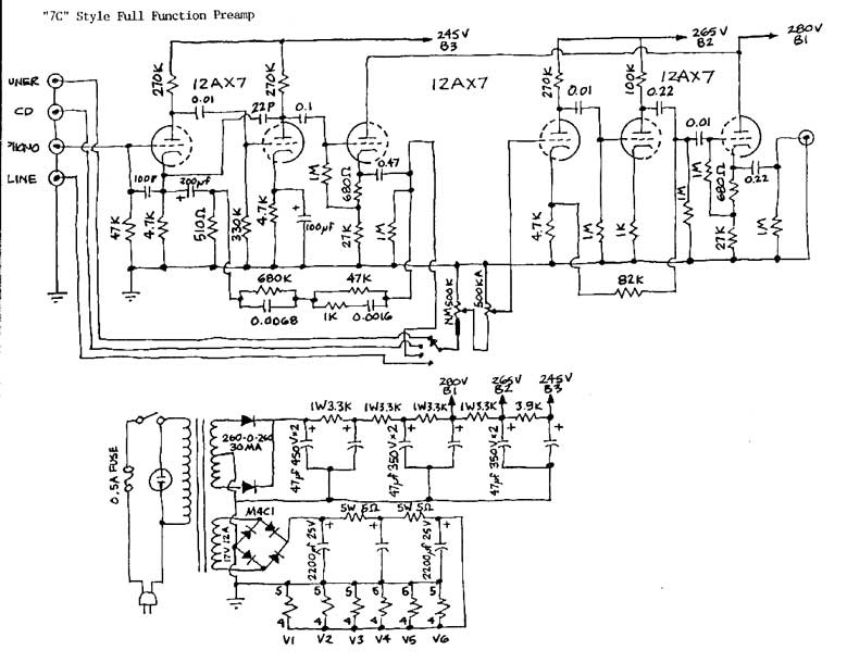

hi i am helping my father restore a marantz 7c pre amp we hit a snag however, we need the original service manual or schematic in order to know the right type of potentiometer for the volume to be used, fairly certain it is a 500k potentiometer but not certain. if anyone knows where i can find more information please let me know gamerz4inc@yahoo.com
The volume pots, R24 a and b are both 500K --
