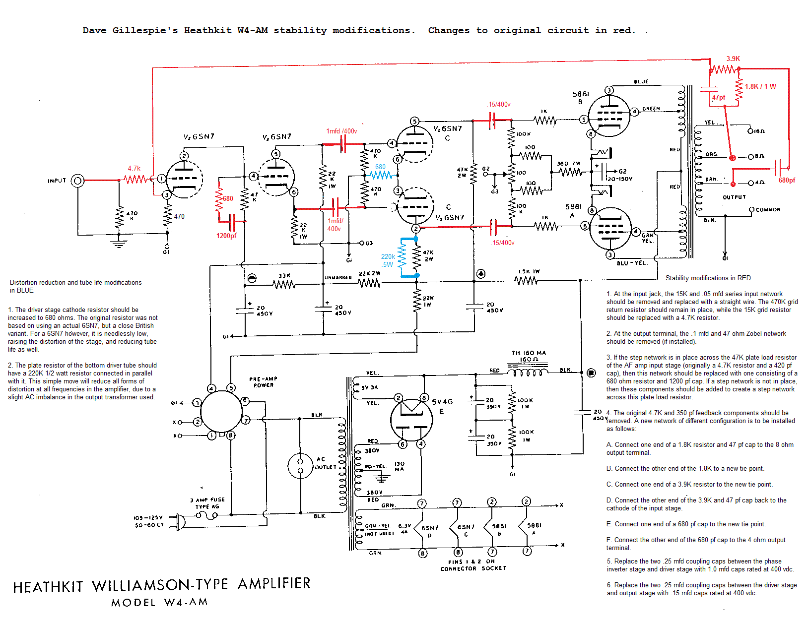

You should read this article from Audiokarma. The mods will greatly improve the performance and stability of the W4.
https://audiokarma.org/forums/index.php?threads/heathkit-w4-am-modifications.459630/

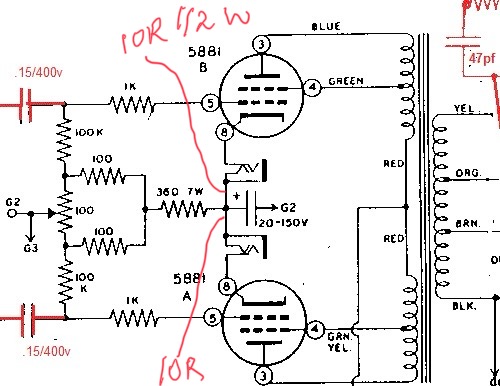

One thing that is not included in Dave Gillespie's mods is a pair of current-measuring resistors. You should add two 10 ohm 1/2 watt resistors between the two test jacks and the "top" of the 360 ohm cathode resistor. This allows you to place a standard ohmmeter across the test points and balance the output tubes. You adjust the balance pot until it's as close to 0 millivolts as possible.

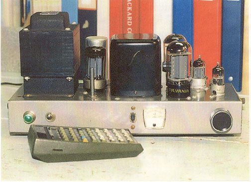

About 1960 I built myself a pair of PP UL 6L6GC amps, the PT is a Hammond 273BX.
17 yrs later I parked the pair on the shelf, I'd bought a Sansui AU7i7/TU717 setup.
I found replacement 6L6GCs were under stress, they were not as sturdy as the originals.
More recently, power in general is a few volts higher on line.

You can also use a 10uF/600VDC film cap in place of the two stacked input caps.
