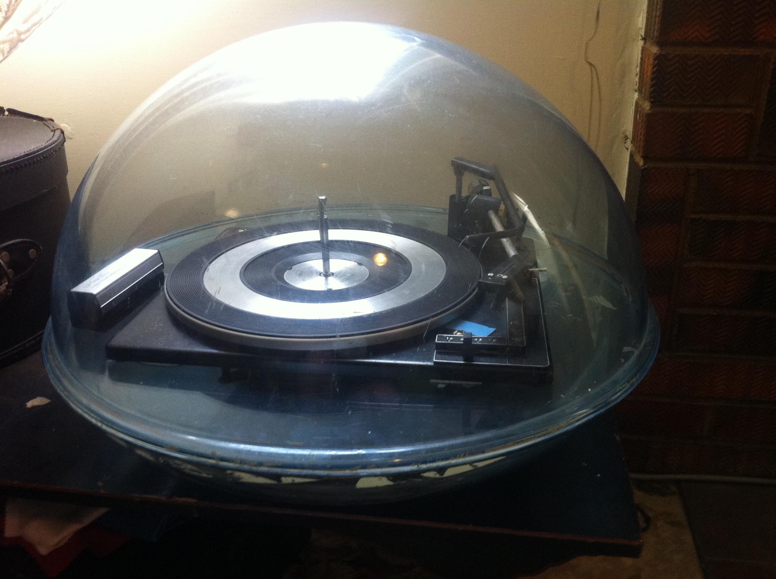

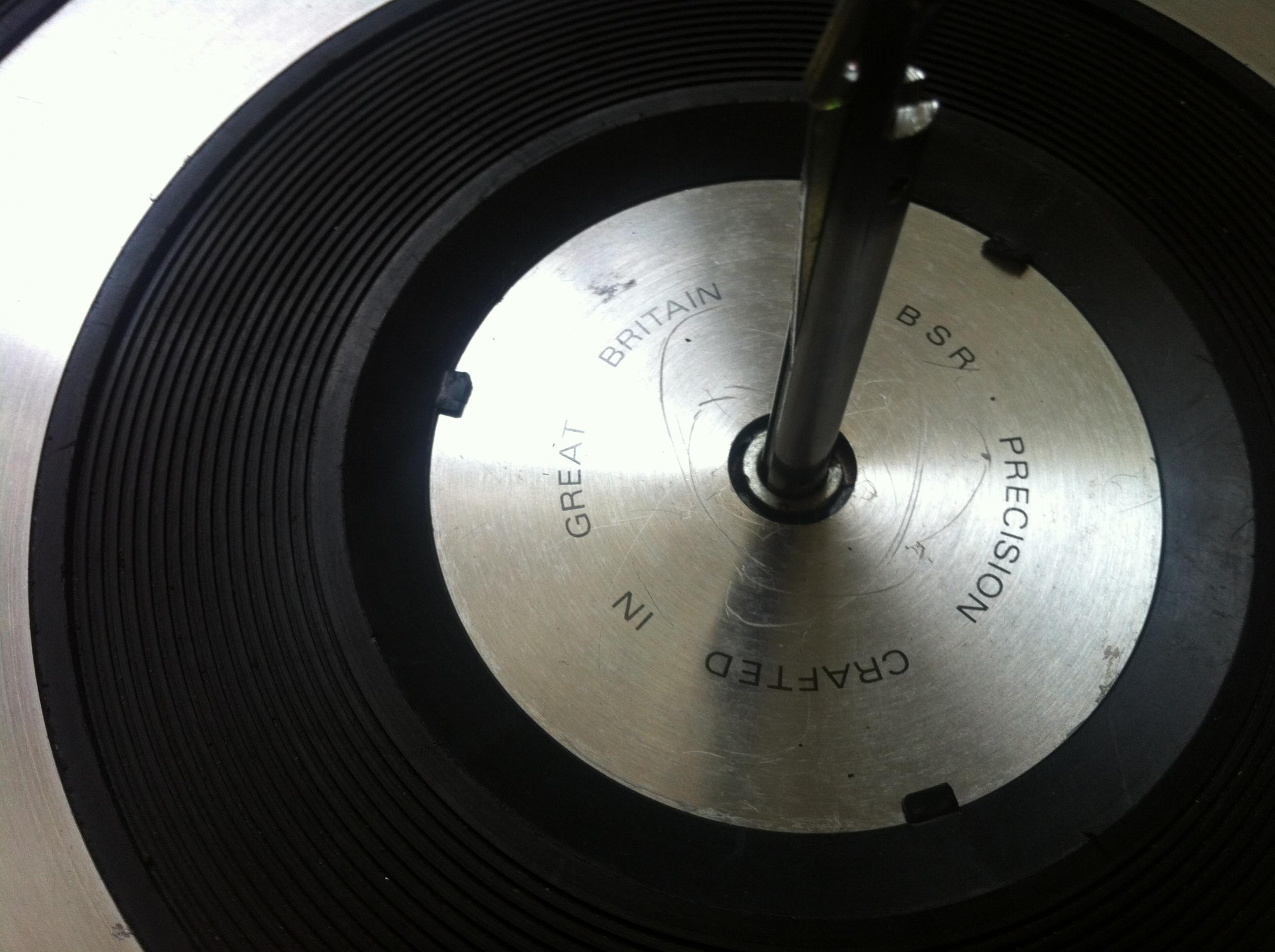

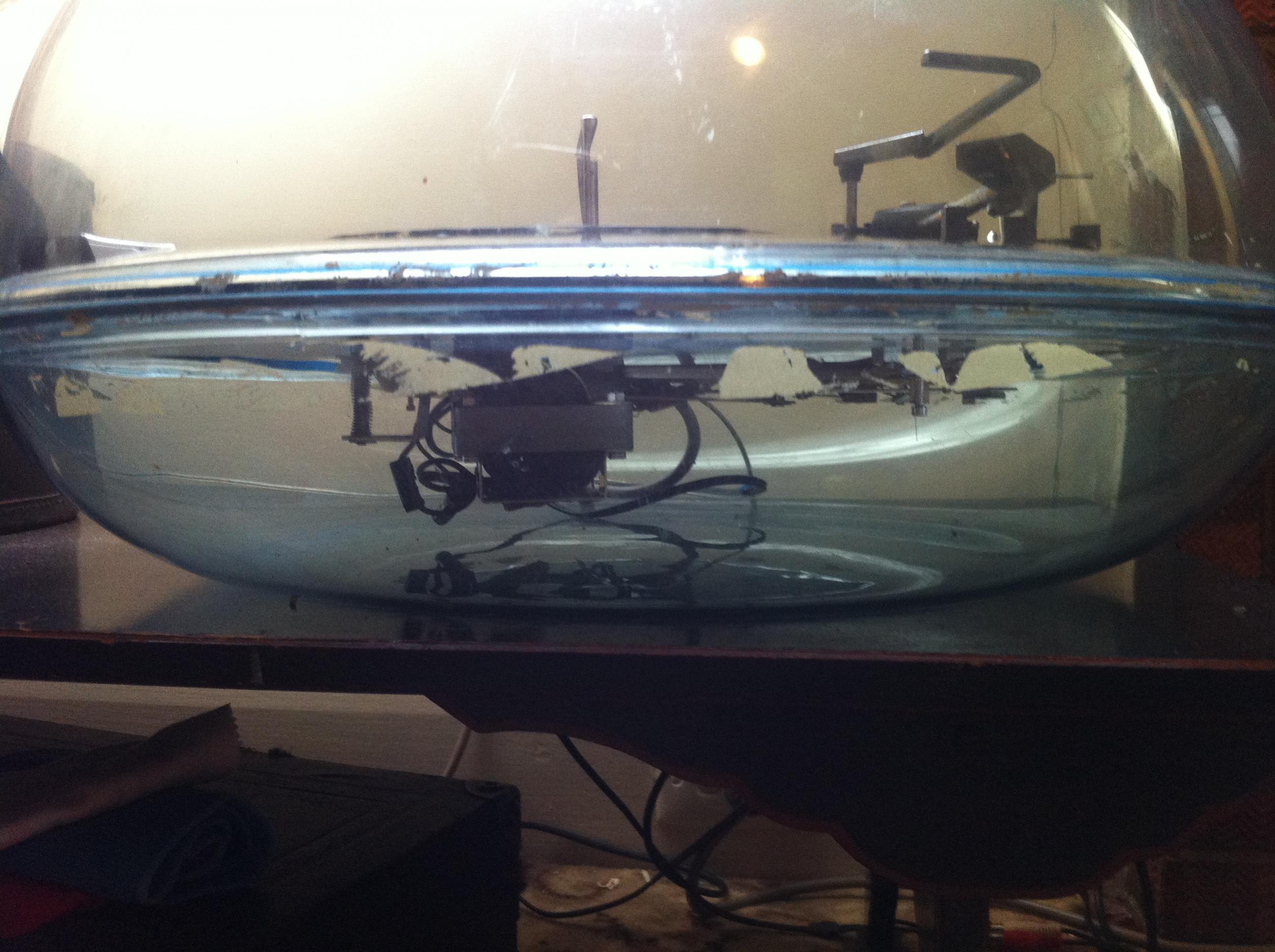

Hoping for some advice on restoring my Dad's old plastic bubble turntable. I would like to make it sound as good as possible (obviously!). As it is a hollow bubble it will be hard to get it to sound dead, so I am after some tips on how to get the best result.
Here are the initial thoughts that I have had
  • Replace steel platter with wood
  • Keep turntable
  • Remove auto return
  • Replace speed switches/on off switches
  • Add new tone arm
  • Replace spindle
  • Figure out a way to dampen vibrations without changing the aesthetics too much.
I am a novice so the learning curve is going to be steep. Any tips would be greatly appreciated.
Thanks all,
Paul.

Yes its a very steep learning curve, and the simple fact is the BSR is ancient,
and is not probably worth any effort to modify / improve it to any extent,
though it appears to be one of their best decent multistackers models.
The deck is best refurbished /serviced with no mods as best as possible.
rgds, sreten.
Paul,
sreten is awfully blunt... geez.
But, yes, that BSR isn't worth doing any work on.
In fact it may actually damage LPs.
What your dad had is a neat idea to put a cool dust cover on the TT.
If you really like that look, and then to honor your dad, I'd consider putting a good but inexpensive TT in that spot. Assuming, of course, you want to use/preserve the plastic bubble part.
I would think that he would want (or would have wanted) a better TT by now...
_-_-bear
This unit is what we would call a "record player" rather than a turntable.
If you want something nice, find a nice real turntable and mount it in the bubble enclosure.

Thanks for the pointers above, I had suspected that I would need to replace the lot.
Given that, I have a couple more questions if you don't mind.
It would be far easier for me to buy a turntable and mount it in the bubble enclosure - are there any commercially available turntables with the dimensions of the BSR - 33cm x 28cm - most seem to be around 42cm x 30cm. Would you recommend that I got something larger and cut it down to size, or try to find one the right size?
New or vintage?
Any ideas on how to mount the turntable? The base is made from plastic that is about 5mm thick. Would you recommend a perspex plinth of some sort in the base which provided a more solid foundation?
Thanks again for the suggestions,
Paul

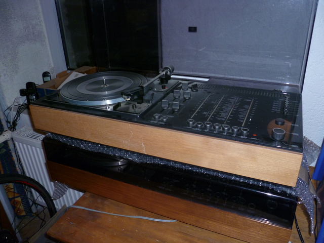

Dual, yes. I have two old (1970 - 1973) Wega hifi sets, a Wega 3212 with a Dual 1216 and a Wega 3213 with a Dual 1218. These were probably the best purely mechanical turntables|record players|record changers they ever made. Lets see if i get them working again, but the stick for the record changing mechanism has been lost anyway.
