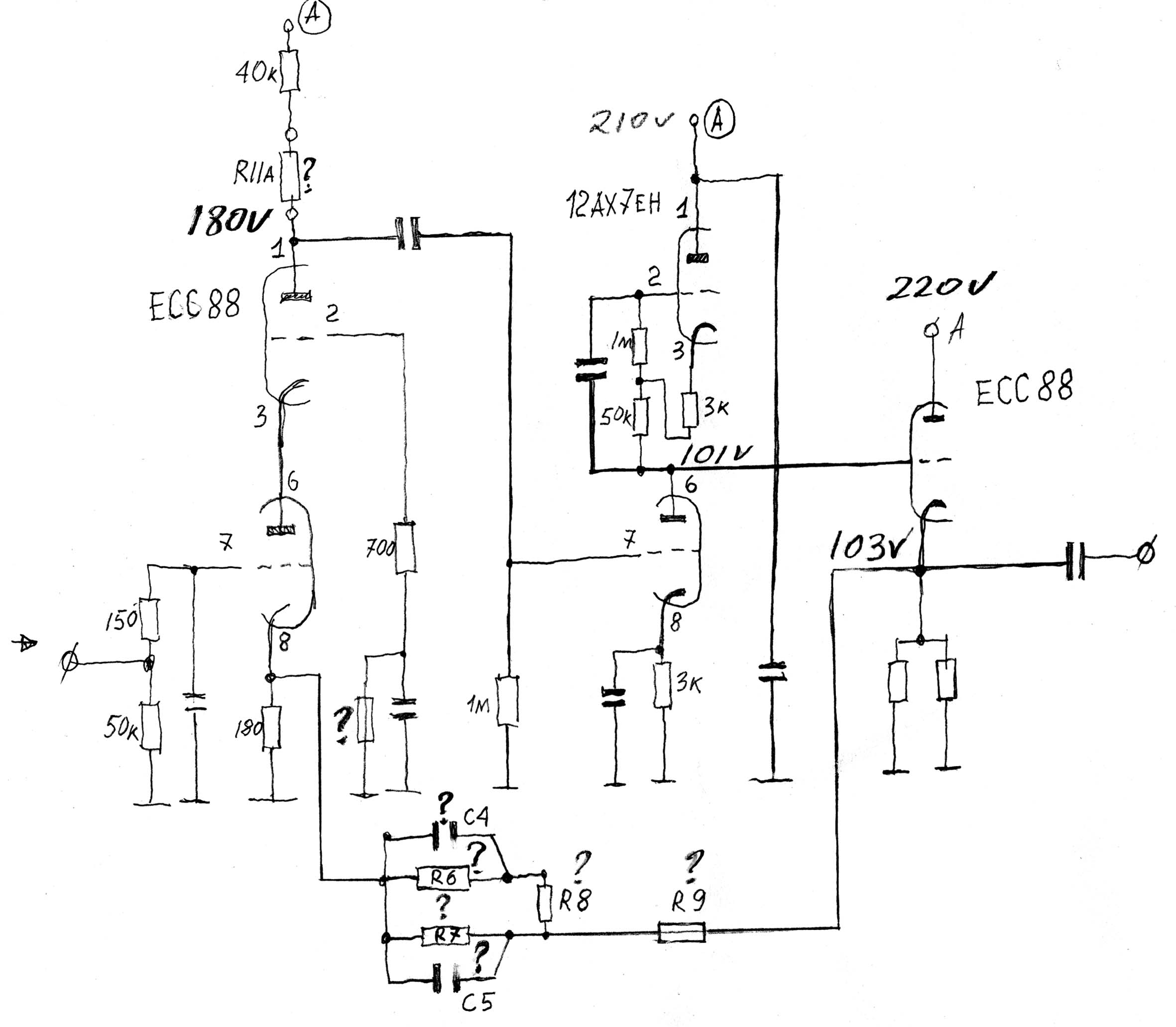

Hi!
There was a desire to listen to Lp, before listening to cd.
I made a schematic drawing my CONVERGENT AUDIO TECHNOLOGY CAT SL1 SIGNATURE,
which has only a line stage, for it used a photo CONVERGENT AUDIO TECHNOLOGY CAT SL1 SIGNATURE
with phono and the scheme of the circuit board.
I know of no importance (ratings) details marked on the chart (?). Please help to restore the circuit.
Many tanks.
Vog.
