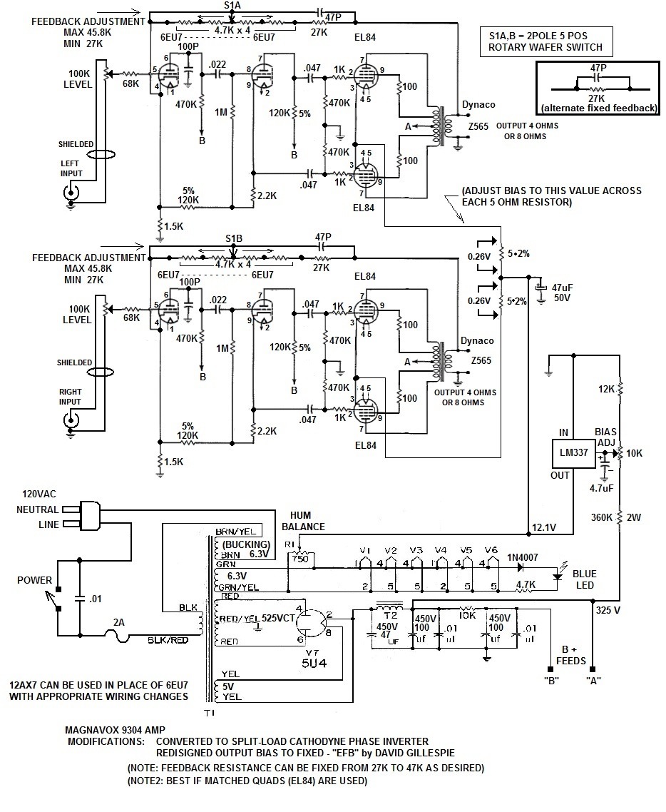

And that is why I chose to work on and modify one of my tube amps that was originally in a 1963 Magnavox stereo console.
The somewhat popular push-pull 6BQ5 chassis #93-04-20.
Since the power transformer had to also power a seperate tuner/preamp, it was "beefy enough" to be made a stand-alone unit.
In fact, I had to use the now-unused extra 6.3v (for the preamp tubes) filament winding as a primary bucking winding to lower the secondary voltages a bit, and also compensate for the higher line voltages of today's grid.
As is, the amp sounded great, however changing the OPT's to the clone Dynaco Z565's (ultralinear) brought it several notches up in performance, along with the David Gillespie bias mods.
I chose a selectable feedback arrangement which with my Advent Maestro's is never needed, but handy if ever used with other speakers.
I honestly believe it ranks up with those "high end" amps selling for thousands.
