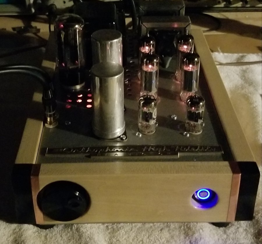

Only experience with tube fryers
was MI amplifiers.
Numerous Music man and Traynors
were dirt cheap used in the 90's / 2000 era
music stores. Running very high watt war
plate voltage. Nobody wanted them.
Fried tubes.
We loved them. 7591 / EL34 / 6CA7 amps.
got Chinese 6L6 and 6CA7.
Recapped power/bias
Doubled screen resistor values.
gave up on the myths
the chinese tube lasted.
LOL oh well
Everyone peeved and whined about
UL / Ultra Linear amps.
My tube fryer Fender 135 with UL
did the best with 6L6 chinese as
well. Everyone said use 7591
Nope

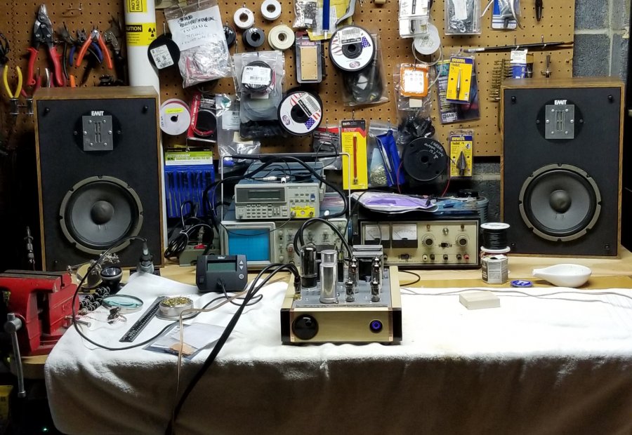

I've recently restored an RCA RS177H console pull amp. The build is detailed here:
https://audiokarma.org/forums/index.php?threads/rca-console-pull-project.977520/
It was pretty ratty to start, but ended up as a nice-sounding, pretty little amp to power my shop speakers.
The original RS177 amp in my RCA Victor console is pretty decent even by today's standards.
However, I decided to not just restore it, but redesign it.
Upgraded to a bit better output transformers, (Concertone) used 7189A output tubes, and 12AY7's as drivers/phase inverters.
It's still using the original 1963-vintage 5AS4A rectifier!
Redesigned the power supply, and beefed up the reserve capacity to the RCA am/fm tuner/preamp chassis.
It kicks butt now.

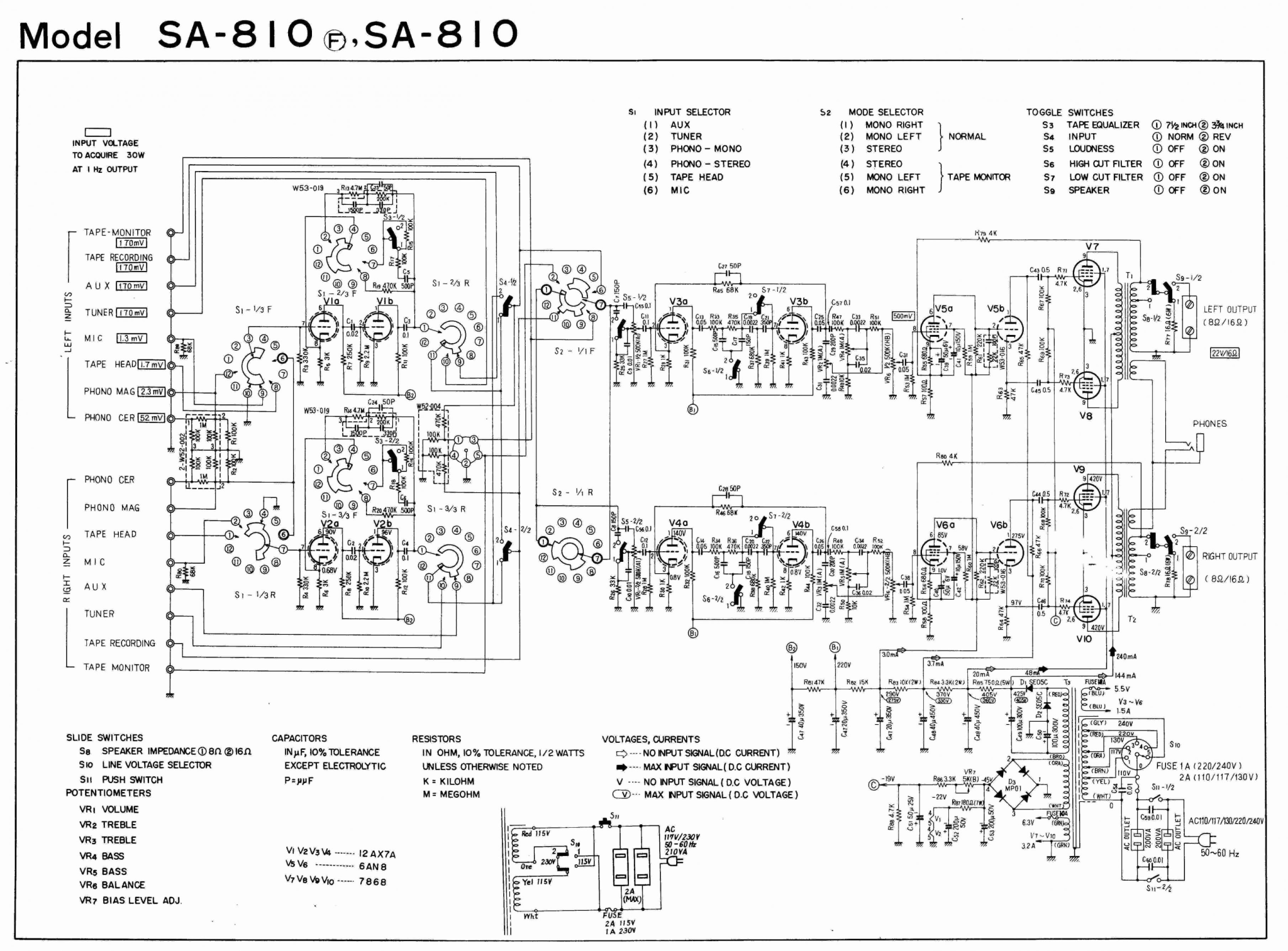

"I'll start by saying that the only thing I'd recommend for a beginner to avoid is an amplifier with 7591/7868/other last generation output valves."
Respectfully disagree, Chris-
Our house heavily uses my Pioneer SA-810 PP output bank cloned to Dynaco ST-35 pre / phase splitter....
For 2 years... Ask the neighbors 😊
Altho havent measured plate currents, fixed bias set -19V into PP 6GM5's w/ no failures- so far...
"Output valves were run hard and put up wet"
"current manufacturing is unable to make really solid replacements"
