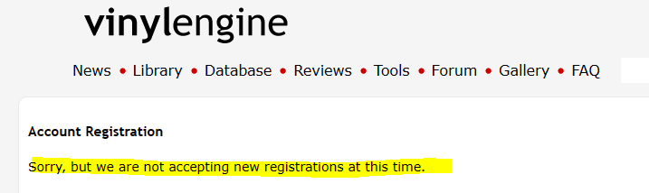

Hi Mate, check out Vinyl Engine https://www.vinylengine.com/
for all your TTable manuals. I have a couple Kenwood TTs, can't remember right now the models.
