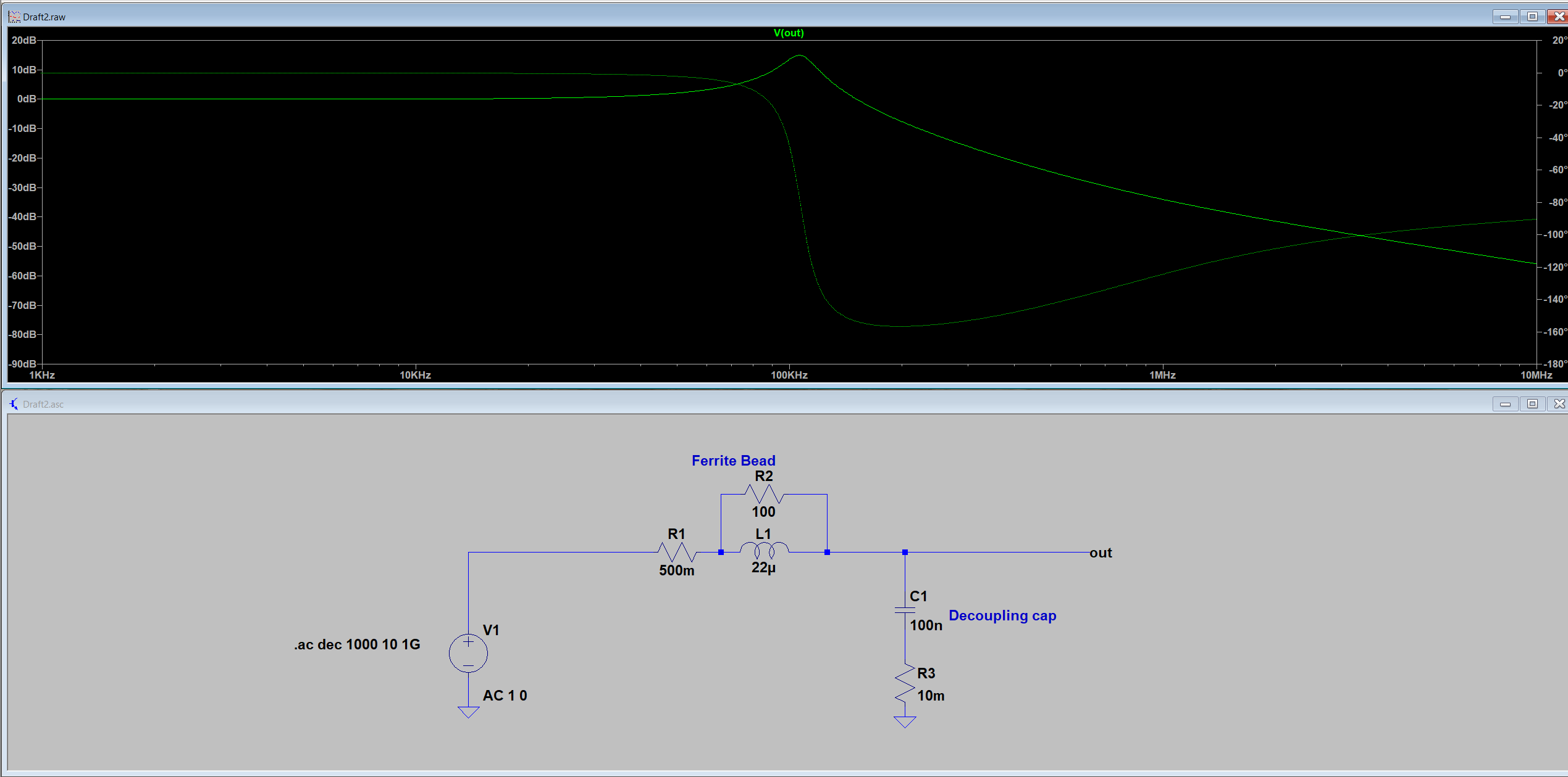

In my eyes this creates an LC resonant circuit that peaks! Why are we okay with this?
I understand that the ferrite bead has some dissipating abilities and capacitors have some ESR, but if I simulate it in LTspice I still get quite a high Q.
My simulation looks as follows:
8prmxPZ
It gives a Q of almost 30! I used a series resistance for the inductor of 500mOhm since the majority of beads on digikey was in the range of 300-600mOhm.
My suggestion would be to use a parallel RC snubber network between the decoupling cap and the ferrite bead, but I almost never see this done. Why is this the case? Is it just component cost?

EMI ferrite beads are usually very lossy as frequency increases, so at higher RF freqs they look mainly resistive (100 ohms or so is typical), and the LC circuit Q is thus very low if the would-be resonant frequency is high enough. Typical uses for ferrite beads is to stop VHF oscillations (100's of MHz).

Where is my model flawed then? How should I model a ferrite bead? Because if the series resistance changes the LF also changes which is not the case (as far as I understand).The parallel resistance seems to have little effect up until much higher frequency.

Depending on the type of ferrite bead and type and value of capacitor, you can indeed get fairly high-Q resonances. Usually there is some frequency in the megahertz range above which resistance dominates. See for example the impedance graphs in https://www.farnell.com/datasheets/1914683.pdf ; when R > X, you have something that's closer to a resistor than to an inductor.
By the way, cheap aluminium electrolytic capacitors (preferably with low working voltages) are quite useful as dampers, although an RC network is indeed more predictable.
Ferrites are not linear, frequency-dependent and some are not even explainable without quantum effects, such as the sorts used in circulators and isolators which violate the principle of reciprocity, so I suspect existing LTspice models are not very good.
In practice for VHF and UHF work ferrite beads are added if oscillations are discovered or suspected, because its easy - trial and error basically. DC offset affects the ac behaviour markedly with some ferrites (some change properties permanently if exposed to strong magnets too).

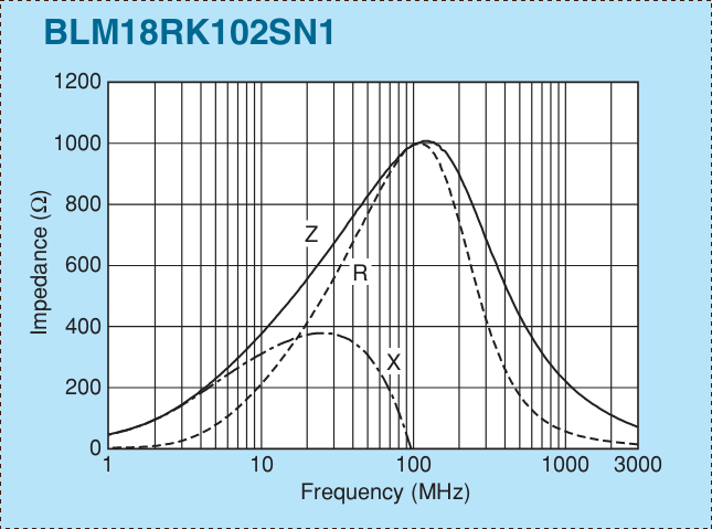

Do you mean those graphs on i.e. page 17? Cause it's about the only graph that has a comparison with a resistive element.
How would you read the resistance from an Impedance graph? I understand that if the curve rises it's inductive and if it drops it's capacitive, but I do not see how you can read resistive values from there (besides a very rough indication based on Q).
I am considering just placing a footprint of an RC network (as solution C suggest in this paper suggests: https://www.analog.com/media/en/technical-documentation/application-notes/AN-1368.pdf). If I feel like I need it, I can easily add the parts and If I don't need it, I can always remove them.
For example, on page 66 (according to the pdf viewer) or 64 (according to the page numbering) you find this graph with the resistance, reactance and magnitude of the impedance for a BLM18RK102SN1. Above 18 MHz, R exceeds X, but the magnitude of the impedance keeps rising up to about 120 MHz.
Ah!
This explains a lot! The values are dynamic and this gives a great indication of how I should threat the ferrite bead.
