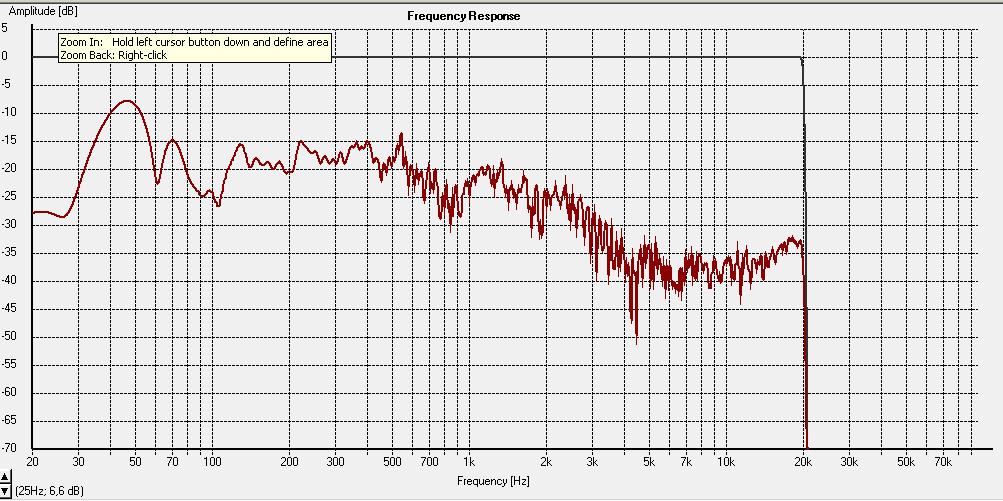

anybody know the original resonance frequency of the ES200RS ?
rebuilding a set, and could not figure out the res frequency,(would have measured before destroying them but did not have the tools back then) mine is around the 44 hz now, maybe to high, but with even lower res it flaps really quick against the stator , and also gets sucked to one stator quit easy
res freq is measrures by HOLMimpulse, hope this is correct. measure at 10 cm distance by the way. i know proximity effect and haas so curve is not as it should be.

The only data I can provide is that the resonance for both pair of ES100s I measured was 45Hz.
ofcourse it playes like this even at pretty high volume but still when sertain notes are reached prob 43 hz they go beserk , and flap against the stator, i rather have they dont put out as much bass then flap against stator. it sounds really ugly and is not really predictable. it sucks. by the way i dont know about the original ES200 maybe they cant handle the power, in the book of fieker it says max SPL is 92 well im really above that i guess, not really a way to test at the moment but i play them as loud as any other speaker i like to crank it up with certain movie scores. they have pretty much low freq,

I prefer a straight connection to the stepup's. That way you eliminate filters in the signal pad, and 44 Hz is not good, it should be aruond 38 Hz.

you mean when you remove the mirror drive you can hit 100dB? by the way 38 hz how can you reach this low resonance without it sticking to stator when power applied

but i think my ES200 had only 2 dotes as far as i can remmember. by the way it upps the res freq as well
Yes, the more silicon dots you add, the higher the fundamental resonant frequency.

there is a simple proof of the effectiveness of the siliconedots. Take two elements with the Mylar® tensioned on it. Put silicone dots on one element but leave the other unchanged. After the dots have hardened (leave them for a night), tap with your fingers on the film. Without effort you will recognize the difference.
i have the dots in place where the original had them to, so only 2 times a dot. problem still is that when notes of 45 Hz are playing on a high volume the mylar wil hit stator in between the dots .
so maybe i have to try and make a panel with lower res with dots aplied. gone be a really dificult stretch. only even the mylar without reallly stretching it or the res will be to high again.
