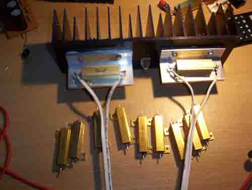

I personally use 50W resistors mounted on a heatsink.
So far I got away with two of them.
If I´m doing permanent test near 50W I just use a fan in addition and indeed they work wonders.
Those 50W resistors you see cost about 3.26€ new. I got them much cheaper through a diyaudio-member and they are also regularly sold at Ebay.
The advantage of those resistors IMO is that they´re slightly heatsinked already. You could even install them on a metal plate, put some in series and build a little tunnel where you can blow some fresh air through. No need for heavy heatsinking.

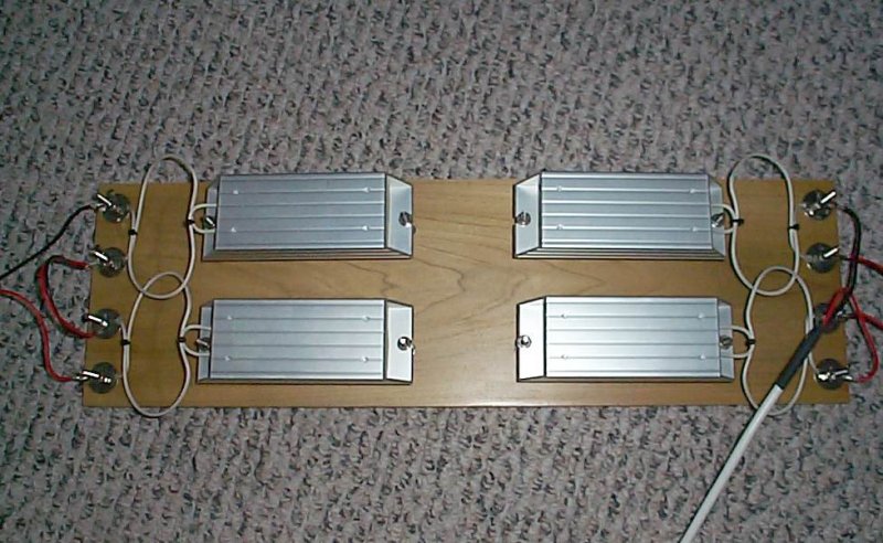

Perhaps not an option for those in Europe or Oz (don't know their shipping policies), but a pair of these work pretty well for me. Have 4 of 'em mounted on a board for testing...400W 8-ohms for two channels, 200W 4-ohms for 4 channels.
Pic doesn't show it well, but they are spaced above the board by about 4-5cm to allow air to circulate. During high-power testing I have a fan trained on them...they do get toasty above 150W.
