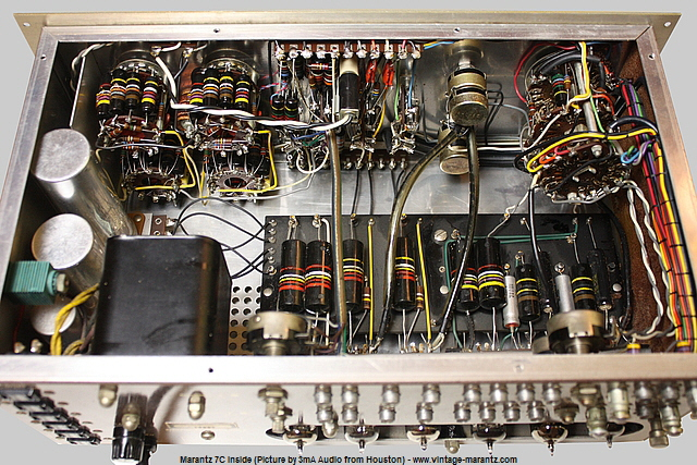

Old consumer electronics made in the USA used the very cheapest parts. Even the better grade stuff, like
Dynaco and Marantz, still used carbon comp resistors and paper caps. Their chassis were of much
higher quality than the parts inside. Maybe European stuff was different.
Dynaco and Marantz, still used carbon comp resistors and paper caps. Maybe European stuff was different.
Those very cheapest parts you show are Sprague Bumblebee caps and other finest electronic parts that cost nearly a fortune today. You may be astonished, but the preamp you show is a legendary Marantz model 7 that even cost a fortune amongst collectors.
If you think thats all cheap stuff, look at Dr. Google:

The first Bumblebees were paper-in-oil (PIO), but after a few years they may have changed them to polyester or paper/polyester. Those caps can last a lifetime if they are still intact with a good housing.

I can assure you that even the resistors you show are highly sought after today and still play very good.
