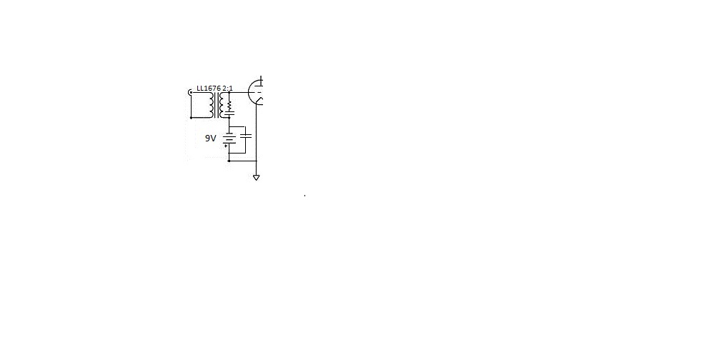

I'm using battery grid bias in my 26 preamp with a CCS on the plate and really like the sound. I'm applying it through an input transformer so I don't need a DC blocking cap in series. The transformer also lets me invert the signal polarity, drop the gain in half, and eliminate ground loops. See schematic.
I've also used diode bias in the cathode of my 7193 preamp with a CCS on the plate, and I've found I like the Cree SiC schottky diodes over LEDs in that application. Both sounded better to me than a resistor with cap.
