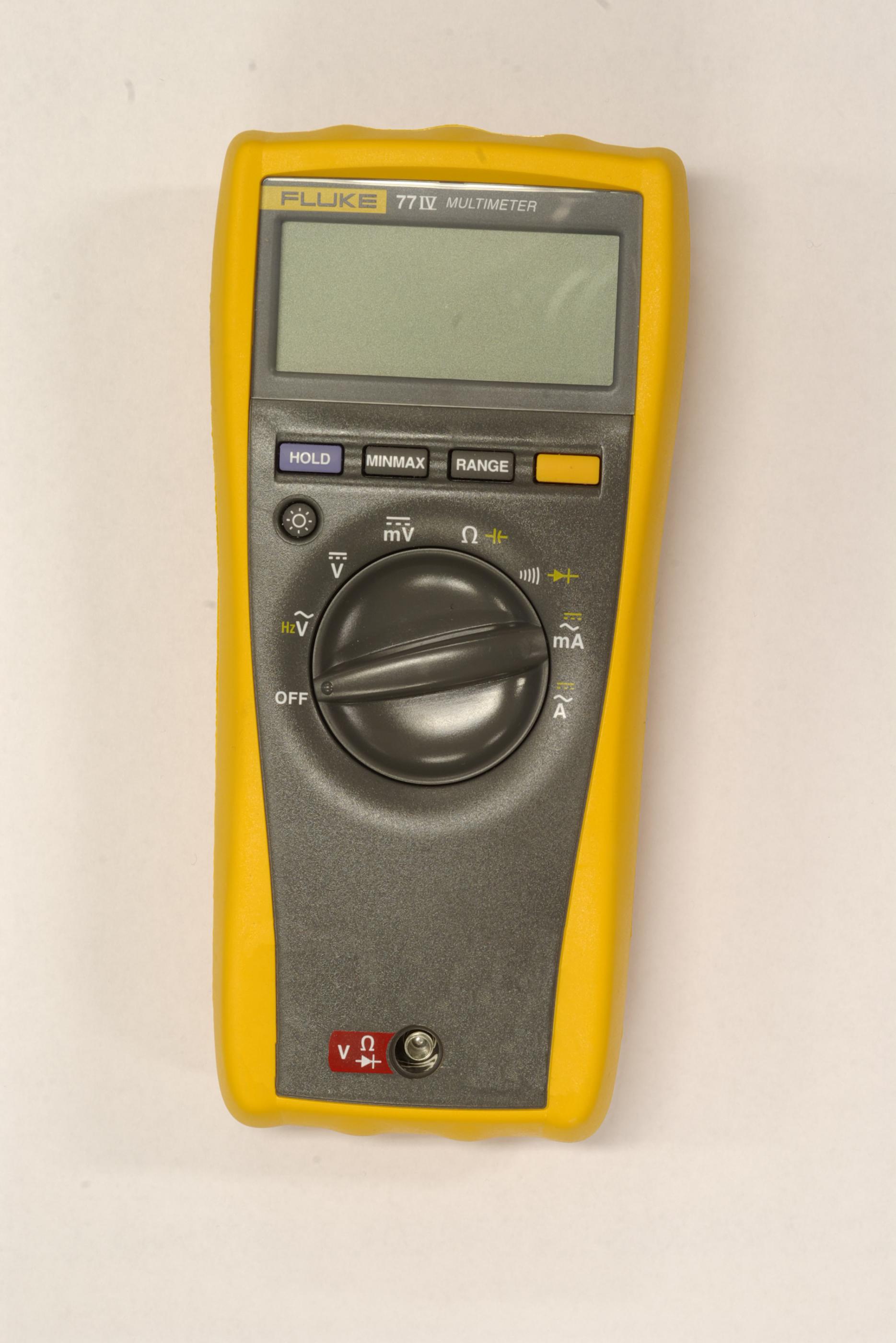

Like everything, a resistor cannot see a voltage - it just sees a voltage difference between two points. (Yes, I do mean "everything": there is no such thing as 'a voltage').
Ohhh really?? You never had a DMM like this one, then? 😎
No, never had one of those. It seems that some people here are proud owners of one, though.
