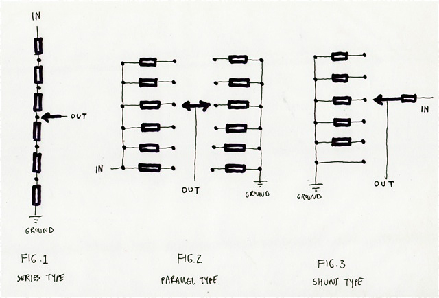

Resistor values for a 23 position rotary switch
I don't know if anyone needs or wants this, but recently I did some calculations about resistor values of a stepped attenuator.
About 40 years ago I wrote some notes on ladder attenuators. I liked to start with the series resistor Rs and the attenuation per step A. Choosing a Rs =10K and 2dB A~=0.8 (=1.94dB) you get Rend= Rs*A/(1-A), 10K*0.8/0.2=40K and Rp=Re/(1-A), 40K/0.2=200K. A 10dB ladder can be Rs=10K,Rp=6.8K and Re=4.7K, but 10dB/step is not useful without an additional "Vernier" adjustment, say 1dB/step (A=0.89).
But it is easy to outperform such ladders with a few binary steps, although care must be taken to avoid glitches between "codes". Momentary mute or Off before On timing should cover that problem. For audiophile use, that would probably have to be ~6 relays for 64 positions/codes, but I once professionally used a 8 bit multiplying DAC for a telephony gadget that had no noticeable distortion issues in that application. I spent some time considering a log device but found that a more common linear DAC provided all the resolution I needed, ie using selected codes for +/-15dB in 1dB steps.

You (like many, so don't feel bad) are making the fundamental mistake of calculating the absolute precision of the resistors in the chain, without acknowledging 2 other facts. First, that the human ear simply can not detect the difference of 0.2 dB (most ears have a hard time with even 0.5 dB), and second, the ACTUAL dB value per step is of no particular importance (to attain 0.01 dB resolution), in light of there being completely arbitrary 'steps' in the ΔdB-per-step values you set out to achieve to begin with.
Better is just to build a pair (or more) of volume-control stepping switches, with nicely matched resistors at every position. People (including you) using the things won't be particularly cued into whether step 13 is (–23 dB) or (–24 dB) or (–22 dB). But they will be, should there be an inaccuracy in the difference in dB between channels!
So, my advice after all that is: lose the 'b' resistors entirely. Just buy the E96 resistors that most closely match those needed (say 10 each), then one evening with a 4½ digit DVM, while watching 'the game' or your favorite show, test them all … and 'bin' them into close matches. It is relaxing and fun. When it comes time to use them, you'll have a bunch of well matched pairs.
Lastly, attempting to keep exactly-and-precisely 100 kΩ of total ladder load is also a non-starter! The source hardly cares one twiddle. The destination though, depending on the nature of its input stage, may well care quite a bit between a 100-to–50 kΩ effective source impedance (when the attenuators aren't attenuating much), and the much much lower effective source impedance when they are heavily attenuating.

The reality of the calculations
The attenuation numbers on the third and fourth column are based on Rgnd values and the assumption that the combined resistance Rgnd + Rserial stays at 100 kΩ. Calculators give more decimals, but I rounded to two decimal numbers, which is enough to show the small differences in the steps. That is all about those attenuation numbers.
The Rgnd resistors that were picked from E48 series are shown on the fifth column. This is a convenient way to design a stepped attenuator and the third and fourth columns show where that leads.
The later columns on the right describe how much resistance is left to the Rserial and how it is possible to achieve some precision if that is desired. So, if one wants to make the circuits with less components, just look at Rserial given on column six and see what is the closest value resistor available in the shop.
But there is more. If one wants more precision, the columns seven and eight show one possible way how to achieve that.
