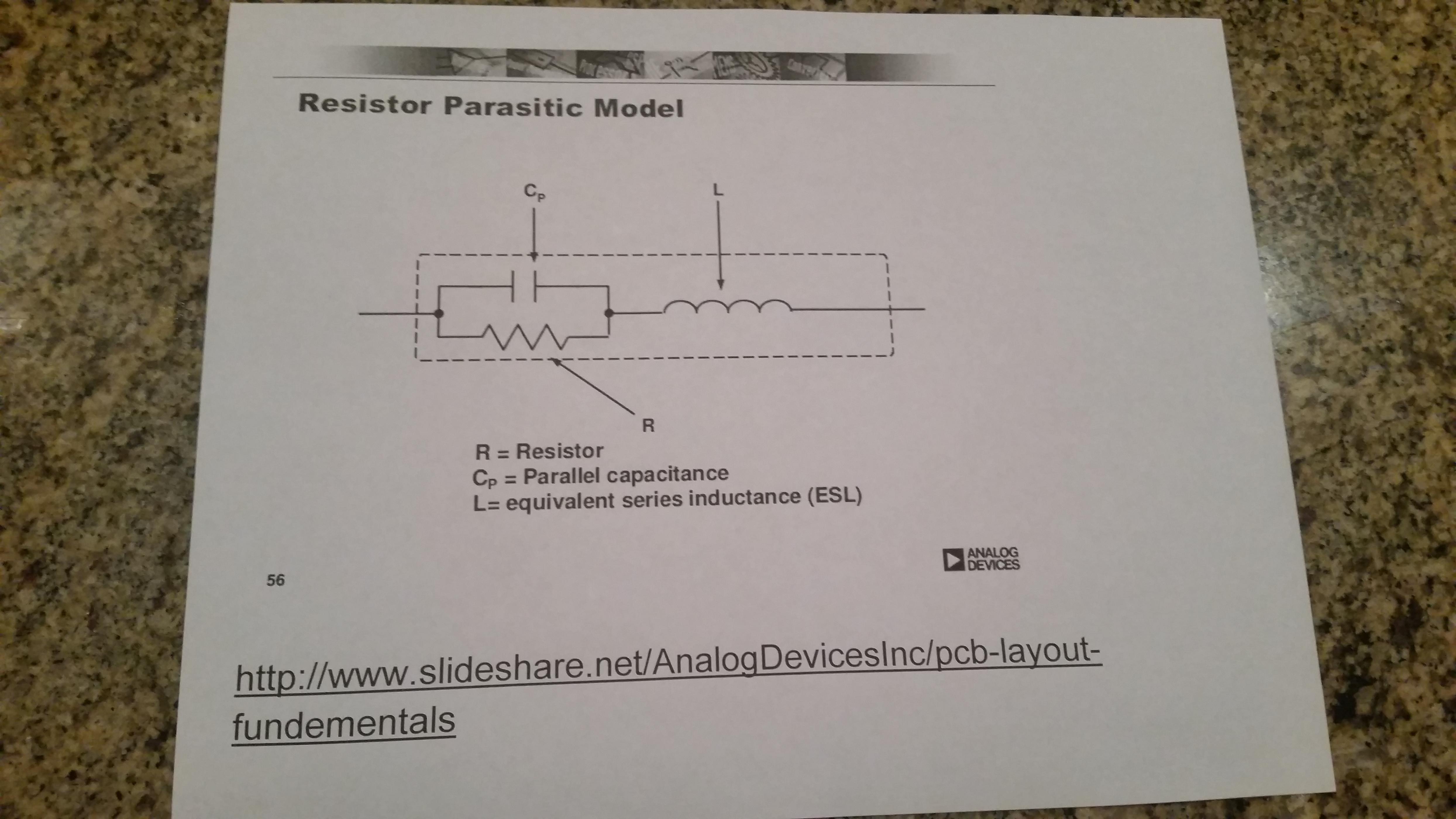

LCR tuned circuit?
I see that bell curve and I am thinking resonance, as in LCR tuned circuit. As you are, I am thinking where is the inductance and capacitance lurking? I have a short pair of separate leads with micro clips to connect to the Function Generator. As far as ground loop goes the Digital volt meter manual says that it is isolated.

I believe that I am getting my head around this resistor in a bridge voltage drop thing.
Here is a list of the measurement process:
Using an audio analyzer voltage sweep across a 4 resistor bridge circuit with an increase in frequency I saw a bell shape increase, peak and fall in voltage across the bridge. For the frequency sweep each resistor of the 4 was the same value. The higher the resistor value the lower the frequency of the voltage peak.
2 of the same resistors were placed in series and the voltage of the lower resistor was measured using the same frequency sweep. A similar effect was observed without the differential null of the bridge circuit.
The frequency sweep was repeated measuring the voltage across each of the bottom two resistors of the original 4 resistor bridge. The plotted cuves of each resistor voltage were much the same however one curve subtracted from the other did not match the plot of the original frequency sweep measured across the bridge.
I repeated the frequency sweep this time using more tedious, manual, more basic frequency generator and 6 ½ digit voltage meter yielding much the same results.
If the parameter being measured was purely resistance we would expect to see test points that line up in a straight line, they do not. We would expect to see a null across the frequency sweep of the 4 resistor bridge, we do not.
Over the last holiday I downloaded “Keysight Technologies, Impedance Measurement Handbook”.
Chapter 1 page 06 Figure 1-9 shows plots of the effect of capacitive and inductive parasitics. I am beginning to think that the frequency sweep plots with the “bell curves” posted earlier in this thread are Self Resonate Frequency peaks. Later in the handbook it mentions that LCR component and network instruments can and should be corrected for stray inductance and capacitance in the test leads. The audio analyzer and 6 ½ digit volt meter do not have this ability.
Next step is to repeat the frequency sweep and FFT with the oscilloscope.

I have taken a closer look into the modeling of the resistor equivalent circuit. First we make the assumption that a resistor faithfully follows Ohm’s Law from DC to RF, for any voltage differential, and for any temperature. We have the suspicion that an inductor may be the passive family’s bad boy. The resistor in not the model child we thought he was.
Noise is commonly talked about other place. Resistors are not linear with changing temperature, less commonly talked about. Even less frequently talked about is resistor nonlinearity due to voltage drop across the resistor.
As posted here a few times, the impedance of a resistor also changes with frequency. Googling about I found the theory and several similar resistor parasitic models posted on sites including Analog Devices and Vishay. See the Analog Device contribution in the attached photo below. There is leakage capacitance parallel to the body of the resistor. There is an additional equivalent series inductance. With increasing frequency the impedance holds steady then the capacitance begins to shift the phase angle negative then the inductance begins to shift the phase angle in the positive direction. Where the capacitance dominates the impedance falls at 20db per frequency decade. Where the inductance dominates the impedance increases at 20db per frequency decade. The bigger the body, the larger the value in ohms and the longer the leads the more pronounced the parasitic effects are.
This stuff is not all just theory. With audio analyzer, frequency generator, 6 ½ digit DVM and bridge component tester (HM8118) I have tested more than a few values and types of resistors. My test results seem to match the Vishay and Analog Devices theory. This phase shift and nonlinear impedance stuff does creep into the audio frequency range, especially with the multiple resistors and leads soldered together into the Wheatstone bridge configuration for distortion testing.
