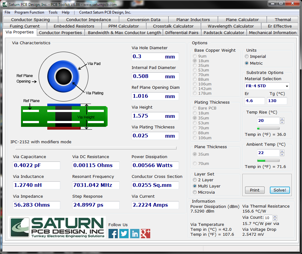

The fresh solder effect is real. But not for the fresh solder! When you resolder all the joints on a board you also fill in the through plated holes. As I suspect you know when the through plated connection needs to be really low loss you use a matrix of them. (Or at least some folks do.)
There is a slight but measurable drop in resistance when the holes are filled. So in some circuits there really is a performance change. Did show this in an article years back. Distortion really did drop with filled holes. Of course the wise will not use a through plated hole for the lower end of the voltage feedback divider.
Of course on hand soldered boards done originally with a lack of skill and a poor quality flux resoldering may actually help.
I believe the reference to new solder was more specific than soldering vias…..
Things have improved over the years including via plating…. I do know when I started out gassing, barrel cracks, limited plating, hole contamination where all problems, the trouble was allowing the vias to be filled with solder during wave soldering could cause solder balls and other undesirable problems on the top surface of the board. Generally these problems are no longer a concern for most electronics...

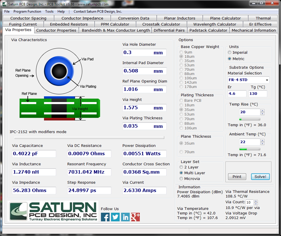

Today’s SMD boards are very rarely wave soldered so via's are not filled (or are filled at board fabrication stage with an epoxy, conductive or not conductive). Todays via's are usually a 0.3mm finished hole size (and smaller) with plating from 0.025 to greater than 0.050 plating in the barrel (depends what you specify). I do wonder how much difference it would make today (filling the via with solder), not much I expect and generally going through vias is not considered too much of a problem…and it is only on the really sensitive stuff where I have seen restrictions on vias, that said I do like to see feedback loops and other critical analogue nets routed on one side of a PCB where possible… In fact most analogue especially round op-amps can be done single sided with careful placement.
The attached show the parasitic’s of adding a standard via with 0.025 and 0.035mm plating in the barrel.
And a bit on solder joint resistance…. There are tons of white papers and research documentation covering all aspects of this including filled vias, also the problem of filling vias and via cracking due to different expansion rates between the metal filling the via and the rest of the PCB.
