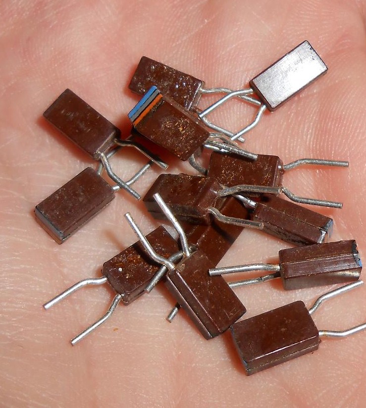

Allen Bradley 'baked carbon' resistors sounded pretty good for their time. That is what most pro users probably used for resistors.

Well mono was ampex, stereo to '61 was Ampex 300-3 and Westrex for the 35mm era. All restored and used for the 1990 reissues that Wilma Fine did. No mention in my searches of any resistors being changed for metal film types when they restored them!

I just don't see it. They got what they got and no one was any the wiser back then. IRC was a good name too, as was Ohmite and probably others. What was put into equipment back then was whatever the procurement department got them in the factories. 5% parts were tight tolerance used for test equipment. 1% parts were off the scale for price (I couldn't afford those!). 20% parts were the norm used by repair shops and 10% was used for "good stuff". If something needed to be exact, it got a trim pot.Allen Bradley 'baked carbon' resistors sounded pretty good for their time. That is what most pro users probably used for resistors.

I've got a bag of NOS AB CC resistors (wow that was some alphabet soup!). I think they were marked 10%, but most of them are not even close to that. Some are so far off I wondered if I was mis-reading the colour codes. I assume these are not the "baked" ones, and I also assume a few decades of poor storage and hygroscopic adsorption have caused them to drift like crazy.
I managed to find a few that measured close to their marked value and used them as gate-stoppers (because somebody told me that low inductance is important in that application).

Absolutely correct! You can safely use the others in tube circuits as no current normally flows in grid circuits. For gate stoppers I don't think that a 10% variance would hurt anything unless the values were marginal to begin with. As long as no current flows in the circuit, Carbon Composition resistors will be fine for noise.I managed to find a few that measured close to their marked value and used them as gate-stoppers (because somebody told me that low inductance is important in that application).
Baked resistors can easily go way off value. Moisture is an equal opportunity party pooper. The ones that last are baked and sealed with a coating.I assume these are not the "baked" ones, and I also assume a few decades of poor storage and hygroscopic adsorption have caused them to drift like crazy.

When I was at: Ampex, instrumentation, audio, and then research (video), we used almost exclusively Allen Bradley 'baked carbon' fixed resistors. We only used 1% metal film resistors for precision attenuators. They were checked out rather thoroughly at some point and that is why we used them almost exclusively.

It has been about 40 years since I last used an Allen Bradley resistor for anything important, but serious evaluation has been going on for more than 30 years. At first, I sourced an incredible variety of 1% or better resistors for about $0.10 each. All kinds of colors, different lead types, some gold plated, the ultimate being about .005% glass cased resistors with gold plated Kovar leads. Wow, I thought I hit the jackpot! I made a personal preamp out of a few modern circuits, with the line amps being Levinson JC-2 stock, added servos, and the volume control was a straight line Penny and Giles studio pot. It should have been wonderful, BUT IT WASN'T. It just didn't sound right. I ultimately abandoned it. Now what went wrong? The line amps were proved out with the Levinson JC-2, the phono stage was all discrete and the same quality. But it just didn't sound right. I think it was the ULTIMATE precision glass resistors that I used, it was one of the only variables that I could not be sure of. I hope to use my present test equipment to find something, if I can. Kovar leads? Maybe that was the problem. Perhaps I can find out. In any case, resistor brands and types do sound different, you just have to listen carefully.
If you read the vishay paper I posted they note that Kovar is no good for thermoelectric effects. In a well designed and laid out classA preamp shouldn't make a difference. But many things shouldn't
