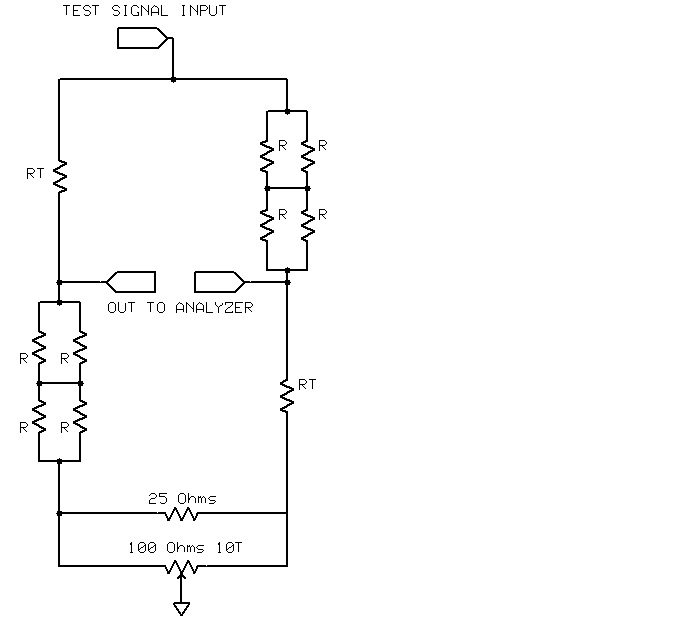

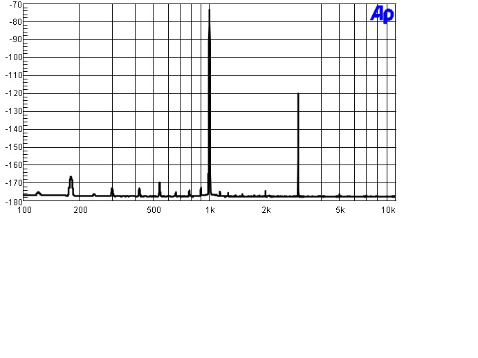

Attach are my distortion measurements on two carbon film resistors. The fundamental has been suppressed a bit by the measurement technique. (54 db.) First image test set up.
As you can see there is dominant odd order harmonic distortion as you would expect from thermal variations in resistance. Rectification would create even order harmonics. (Although there are also other mechanisms.)
The really bad example shown in the third image may indeed have rectification issues! But probably not as the rest of the even order harmonic structure I would expect is missing.
The base spreading on the third image is from an increase in noise level.
Now there is at least one well regarded amplifier that uses a 1/4 W audiophile carbon film resistor in the feedback network that does increase the second harmonic distortion of the amplifier to where it is the dominant distortion and masks pretty much so any other distortions present.
Some folks like added harmonic distortion, that is of course a personal preference.

Wheres the rest of the info? Voltages, resistances, power rating.
In a steady state ( sine wave, no amplitude variation ) there is no temp. coefficient distortion, the resistor temps are constant. That might be voltage coefficient, but in a divider the two resistors track together so if the resistors are the same value, no distortion.
The one place voltage coefficient may be a problem is in power amp feedback. Now I'm reapeting my self. (A few pages ago).
