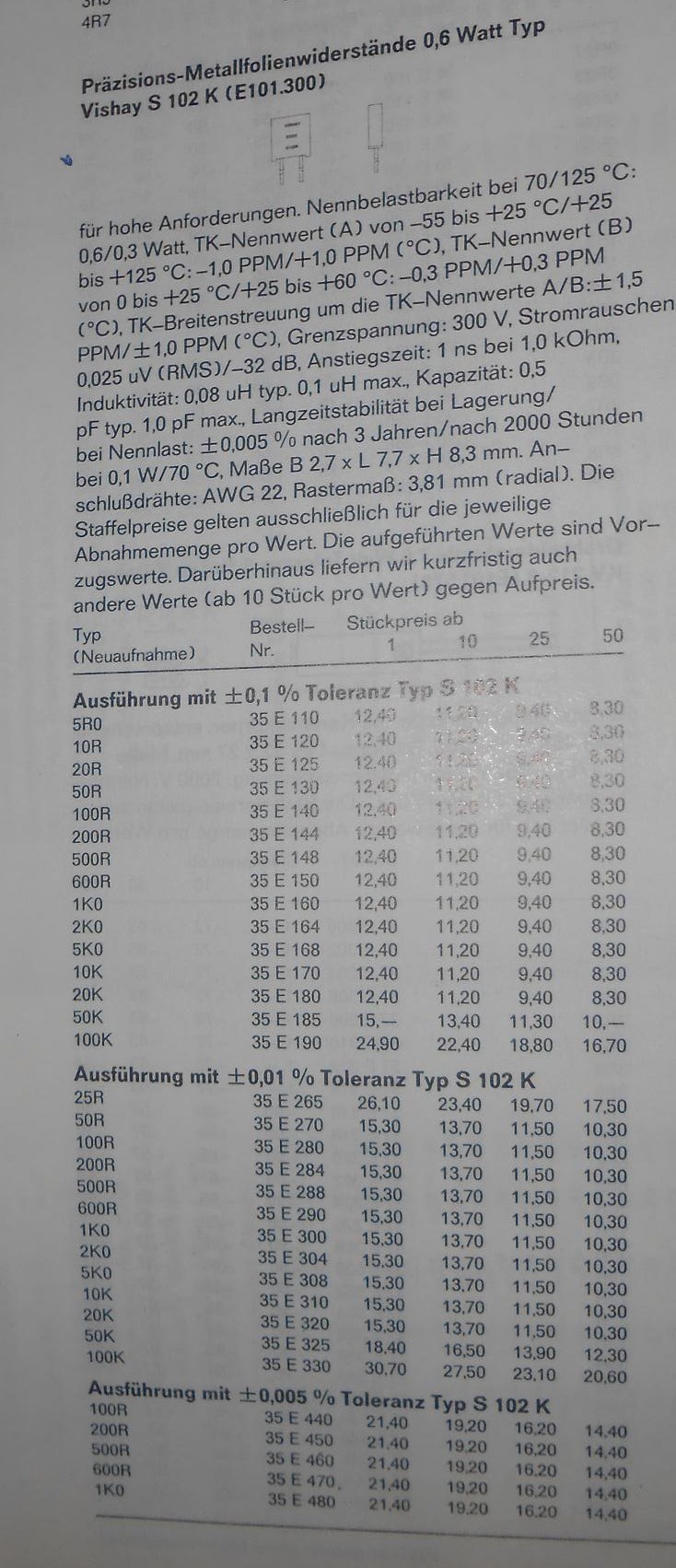

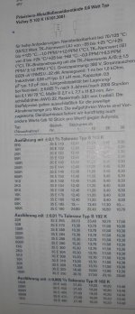

I once made the mistake of using a low value Mills MRA-5 "non inductive" wirewound as a programming resistor on a CCS feeding a shunt regulator I was building. I used it because I had it in stock and it was the correct value. The regulator oscillated wildly until I replaced this with a metal film R of the same value. I suppose the problem could relate to size but the Mills wasn't THAT much larger than the .6 watt R used to replace it.
