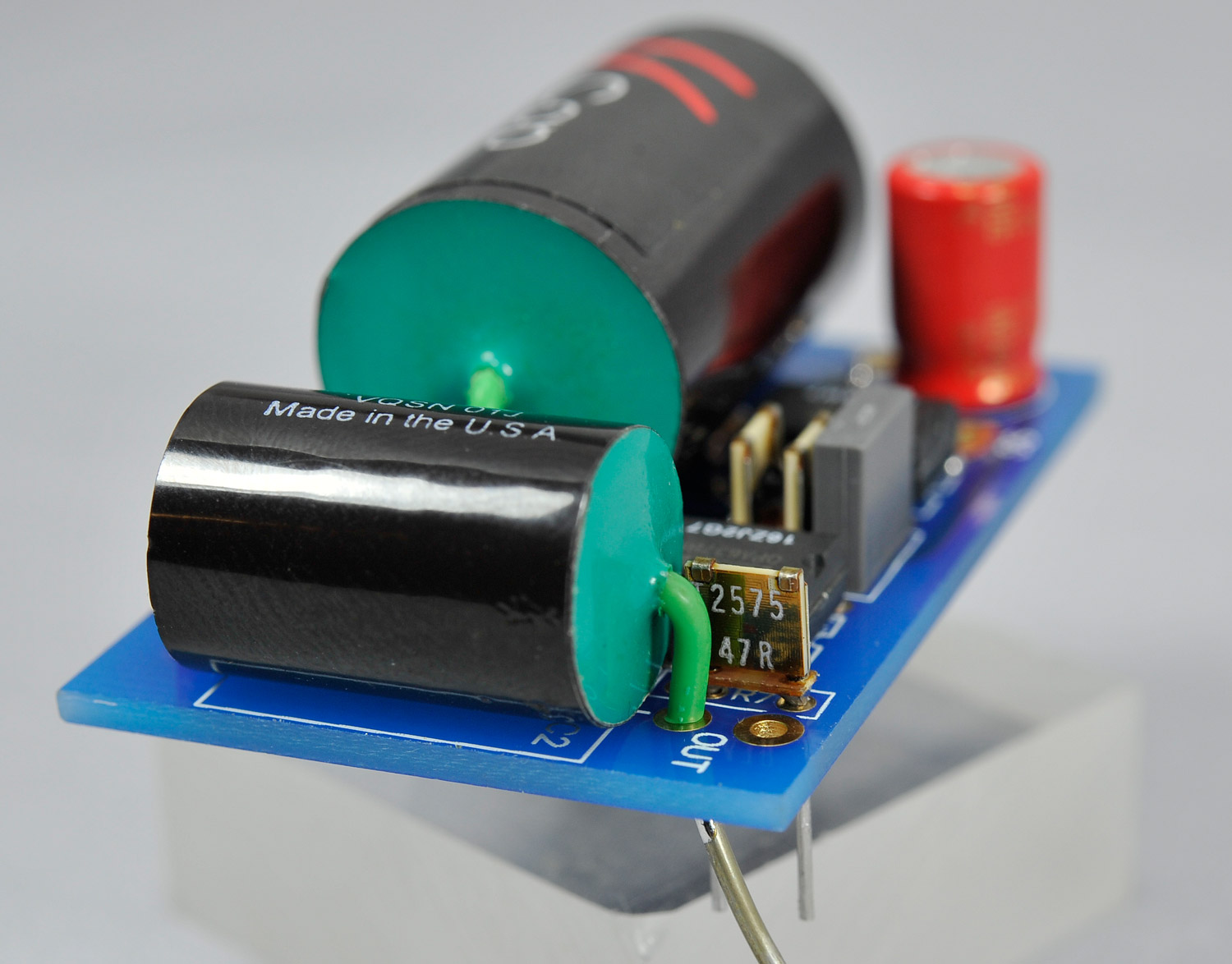

Joachim, I suspect the Charcroft and the Texas Components resistors are identical. Texas Components merely has a Vishay licence and receives their resistive material from Vishay direct. TC merely laser etches these bulk products for target resistances and tolerances. Charcroft probably has the same arrangement.
Vishay Zs are truly superior resistors. Nothing like them, in my books at least.
Btw, how much $$ are the Charcroft versions? Texas Components sells a Z resistor for about $10.
Well, that is much less then Charcroft at 25,- english pounds. They mount the resistor on something that looks like bakelite. I do not know if that is important for sound. As i said, i heard things with this resistors that i did not know they exist. I just designed a commercial phonostage for Spiral Groove that has MANY in them. I do not think we can make it under 15.000,-$ beause there are also Teflon caps and other goodies in it.
Joachim, I think everything you see in a resistor before you was supplied by Vishay. It for sure meets Vishay's tolerances. In either case, you have a Vishay resistor.
The contractor (TC or Charcroft) merely, I think, "burns" the appropriate resistance in the bulk resistive material. Burning just severs microscopic traces, which increases resistance the more is burned. Tolerance is similarly set.
Charcroft's products are overpriced IMO.
This is how TC Z-foil resistors look:
my phonostage has 18 expensive opamps only in one inputstage and it has two input stages. For that input alone i need 40 z foils so do not make jokes about it although i find your post a bit funny myself. As always i will try the Charcroft against other z foils and will decide which one i will use on sound alone. if they are the same they should sound the same.

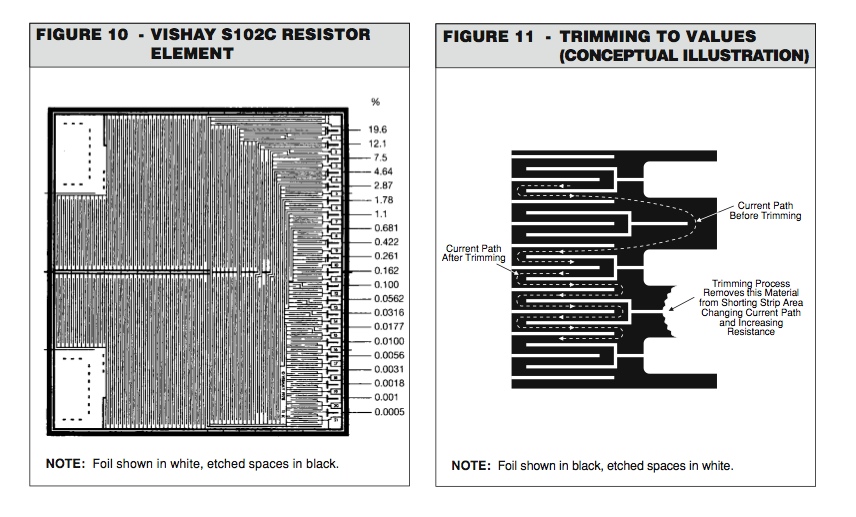

Vishay has a good bit of information here on bulk foil resistor technology:
Resistors, fixed discrete - Bulk Metal Foil - Vishay
Their latest Z-foil technology has vanishingly tiny temperature coefficient, it's practically nothing in typical consumer electronics applications, as is voltage coefficient and noise, and long-term stability.
The foil is produced by Vishay and sold to qualified vendors; it's applied to an alumina substrate via lithography (I think) with a very specific pattern to minimize inductance and configured so that the trim areas don't see current when cut out with a laser. Everything about the basic resistor element is optimized to make as absolute a resistor as possible and it ends up not looking much at all like the tiny cylinders we are used to seeing.
Related Documents - Vishay Resistors, fixed discrete, Bulk Metal Foil
The downside of foil technology besides expense is the limited upper range of resistance, so we can still argue about the merits of relative technologies for anything above 100k ohms or so. 🙂 Having no comparable information on tantalum nitride, I can only assume that the technology didn't meet a large enough market demand to sustain it, although I think some surface mount resistors are made with the material.
