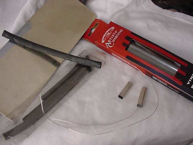

Go to your art supply store and buy Willow stick charcoal. Windsor and Newton is the brand I use. I use a few different sizes bigger is easier. Then cut them to about an inch long for 100 ohm-300ohm. Shorter ones are a little hard to work with. It's a messy job. I then wrap them in silver sheet and epoxy one lead in one end. Then with a meter I adjust the resistance by moving the other end in or out. When its the value I want I epoxy the other end.

Maybe a picture will help.
This shows the packaging of the willow/vine charcoal, the silver sheet, and the silver wire. Just add epoxy and thats all there is to it. It sounds like it can't be this simple but thats it.
The two resistors pictured are unfinished.

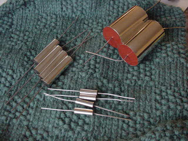

tom1356 said:Maybe a picture will help.
Why is it necessary to use a silver sheet?
If you use a brass or aluminum tube instead of the silver sheet,
you could probably jam the charcoal into the tube which would slice off the excess. Then adjust the resisitance by inserting the wire more or less as mentioned. Seems like the connection between the charcoal and the wire is a possiblre weak point of the design.

fmak said:tom1356 said:Maybe a picture will help.
Silver is not necessary, just better.
Before someone asks.
Silver dissapates heat like crazy (very nice for little furnaces like resistors) and makes an excellent shield.
Damn pretty too.
Variac said:If you use a brass or aluminum tube instead of the silver sheet,
Good points. This should make it easier for people to try.
The tubes are longer than the carbon in them to allow for the epoxy to fill it and hold the wire better.
One of the biggest benefits to these resitors is the ability to make the leads as long as necessary and avoid solder joints.
