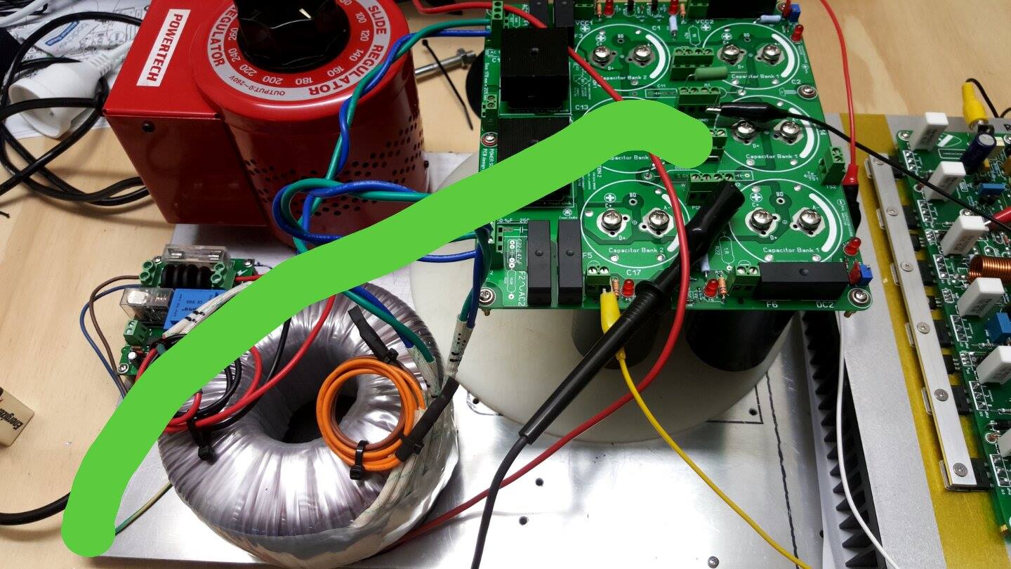

hello guys I have a question on the power supply on the STAR GND can a wire be connected to chassis GND ? the image belongs to Mr. ST
Best Regards
Juan
