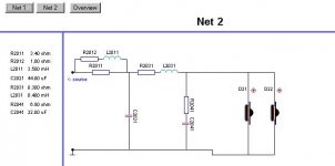

Thanks for the feedback guys.
Below is the xo schematic.
It's thrid order with the first inductor and resister used as the BSC. I'd have preferred 2nd order but the Vifa TC18s have a hump in response above 5khz which is affecting the level of the top end, which is a Morel MDT20.
There's a zobel in there as well. Although taking the zobel out doesn't seem to affect the response much at all.
Rabz, this project has frustrated me greatly. My original concept was a 2.5 way using the bottom woofer as .5 to boost the bottom end for BSC. But, for the life of me, I just couldn't get it to sound good. There was an annoying glare or forwardness in the vocal range, especially with female vocals. That's in the 100-300hz range. My response measurements showed a hump in that region that I couldn't null out. When I went to both woofers paralleled with the 3.5mh//R combo for BSC, it sounded really good. But, using that resistor to burn power is not a very elegant solution. It's bugging me something silly.
Jomor, are you talking about an inductor in series then a cap in series or parallel? One will give me a bandpass and the other is just a 2nd order. I can't quite see what you're getting at. Can you post a quick diagram or a more explicit description. Thanks.

Mos,
Your paralleled L/R will also be affecting the Qes of your woofers, and therefore the overall Q of the bass system. Are you sure you couldn't get LspCAD to compensate for baffle step with just the filter components?
FWIW, I'm now designing (just for kicks) a 2-way system featuring the Scan-speak 18W8535-00 and 2905/9300. The measured response (including baffle step losses) of the 8535, which had a 10dB rising response between 100Hz and 5kHz, was completely flattened with nothing more than a 3rd order electrical filter to achieve a perfect LR4 cross at 2kHz.
