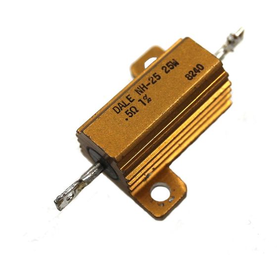

When I've needed a power resistor, I've always favored the type pictured because they are simply more believable than those that look like over grown non-power resistors. They are made to be screwed down to something as opposed to being suspended in free air for better air circulation and avoiding contact with a combustible base. They don't require a heat sink but can make use of one depending on actual power handling and anticipated ambient temperatures.
I promised an engineering based answer so I downloaded a data sheet of an example of that type of resistor and found the following at the bottom of it - derating curves based on ambient temperature and heatsink vs no heatsink. You can simply look at graphs, consider your ambient conditions, and make a judgment. It pays to overdesign with power resistors because if you don't they can get uncomfortably - even dangerously hot on a wood base in a hot climate without air conditioning. Home audio is obviously more forgiving than aerospace but it pays to be conservative.

Many years ago, I stumbled into a cache of Dale 25W "NH" resistors (like the one pictured) at an electronics surplus store. They were dirt cheap, so I bought a bag full, and have utilized several in crossovers. I haven't done a scientifically controlled comparison, but it was hard not to notice that they sounded clearer than the cast resistors I'd
been using. It never occurred to me at the time that temperature would ever be a concern. That was 32 years ago.
I have no idea how they'd sound compared to some of the modern boutique types, but they've part of a set of speakers that has kept me intrigued for decades.

Thanks. I read that doc., about 10 years ago, when I decided to use them in my first outboard XO. I never found any info on the induction so that is why I measured them. You may have seen this but here are the measurements. Now this is an uneducated guess but it is low I doubt they have much of an effect on the sound.
RH-10 10W 1ohm 1% R=1.020 L= 5.3uH
RH-50 50W 1ohm 1% R=1.016 L= 5.34uH
RH-50 50W 2ohm 1% R=2.017 L= 0.3uH
RH-50 50W 2.2ohm 1% R=2.224 L= 0.4uH

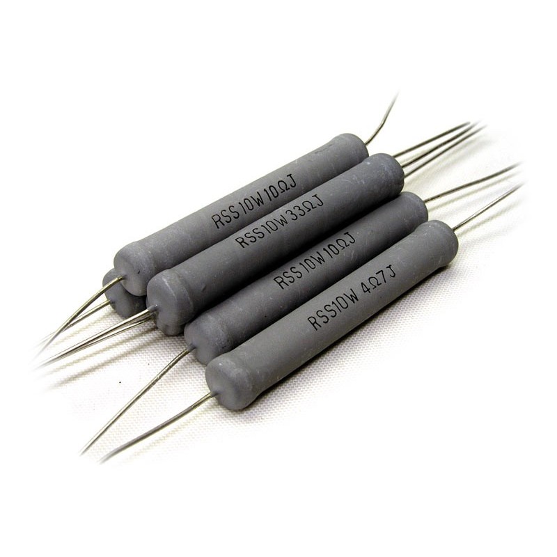

I was using cheap power ceramic wire-wound resistors for all crossovers I'we build, as well as the type henrylrjr uses, until I tried these
non-inductive ones: Jantzen MOX RSS 5% 10W. I started to use them in a 2 way crossover - 15inch+1inch/Seos Horn, 12 db/oct + equalisation.
I have no measured proof if it 'sounds' better or not, but one strange thing happened: when I was replacing the bunch of wirewound resistors from the horn driver section (including the horn EQ resistor) with the non-inductive type (I added few in series to get a higher value), It was needed a bigger value to get the same perceived sound pressure level. Hope this helps. I have the resistors from a friend, but I discovered that Jantzen makes them. Real measured value under 5% precision in my case. The driver is Beyma CD10Nd and the horn is SEOS 15. Caps are Jantzen Superior + Intertechnnik Audyn Reference in eq part.

I missed that in the doc you provided. The doc states they meet military specs and the vishay model # will begin with ENH or ERH. The Vishay model # for mine are marked RH and the spec. sheet for these state a non inductive model # beggining with NH is also available. That is probably why mine measured low inductance.
