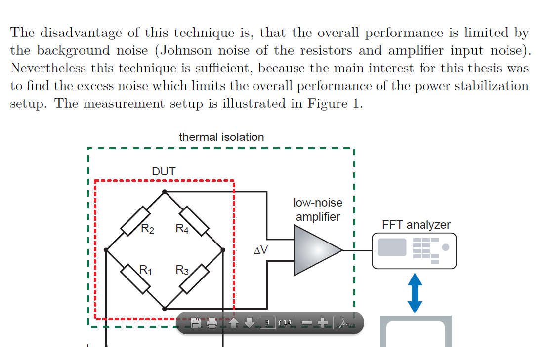

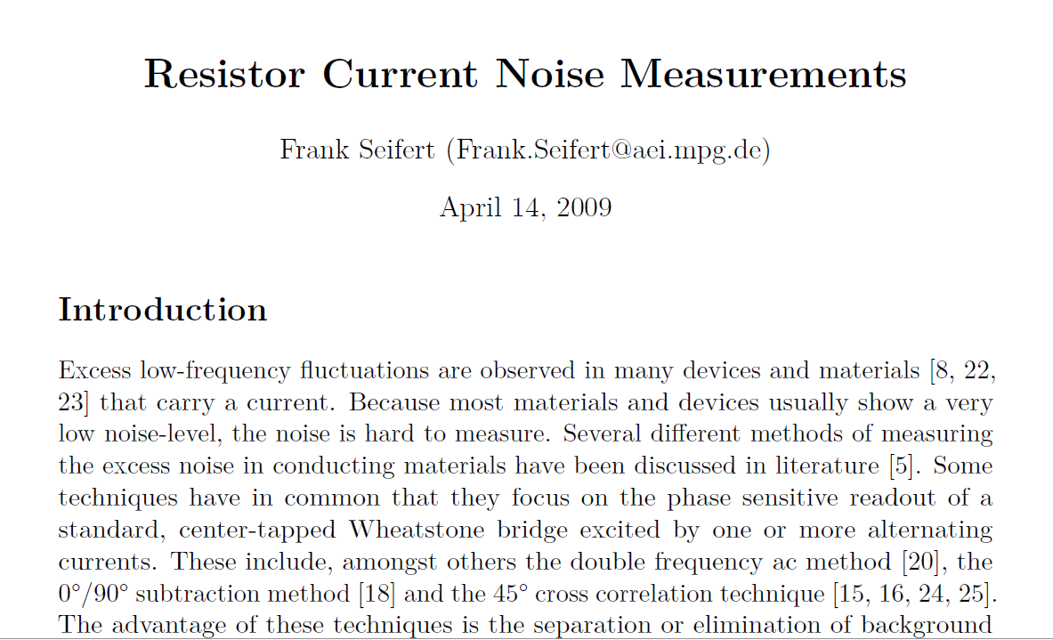

this warning came up wthIs this the one?
I will have a read..🙂
https://dcc-llo.ligo.org/public/0002/T0900200/001/current_noise.pdf
Regards
M. Gregg
proceed or "get me out of here"
dcc-llo.ligo.org uses an invalid security certificate.
The certificate is not trusted because no issuer chain was provided.
(Error code: sec_error_unknown_issuer)
Maybe Merlin meant to say/type micro-ohms?Steel certainly has higher resistivity than copper, but so what? We're talking about a few milliohms difference in a typical wire length, and since it will be in series with any number of deliberate resistors in circuit, what different would a "slightly resistive" wire make? If anything it would improve metters, because the bulk wire resistance will be more "perfect" than that of actual resistors.
Its a PDF..

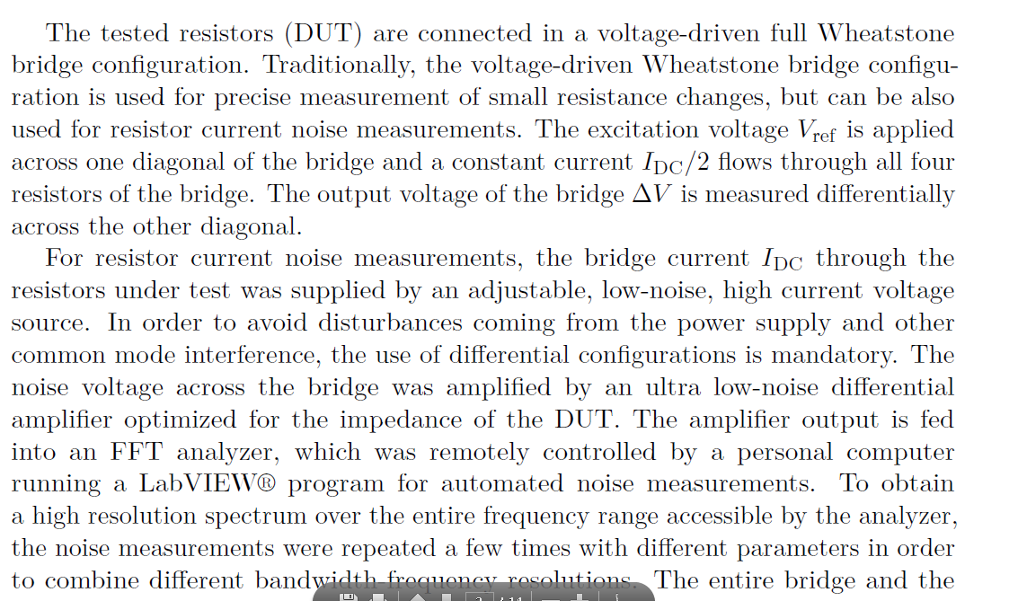

here are a couple of screen shots..
Perhaps you can down load from here?
