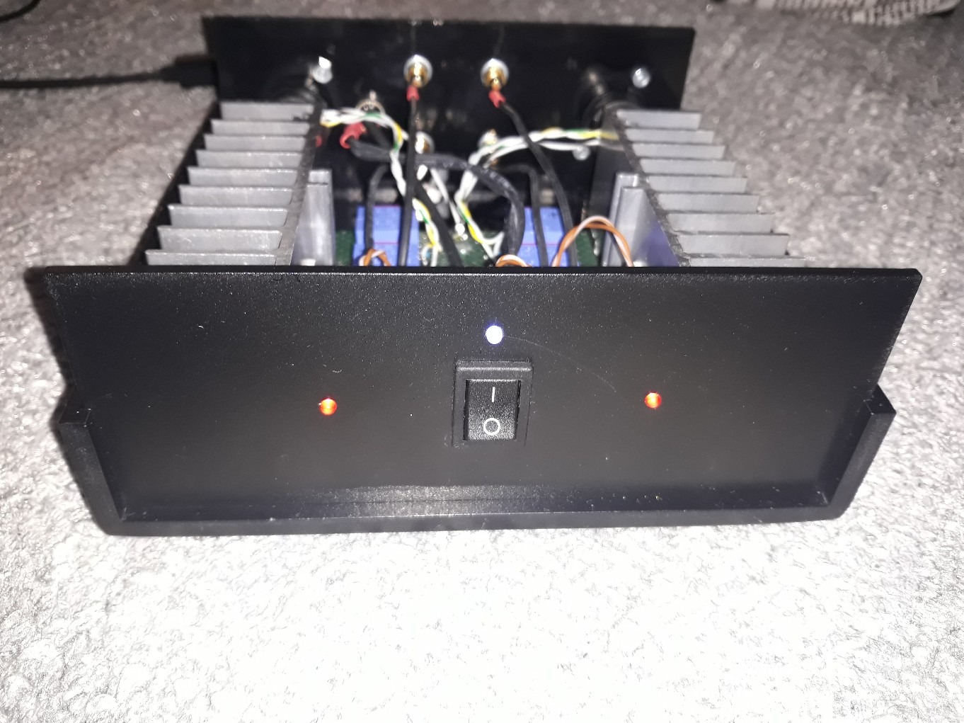

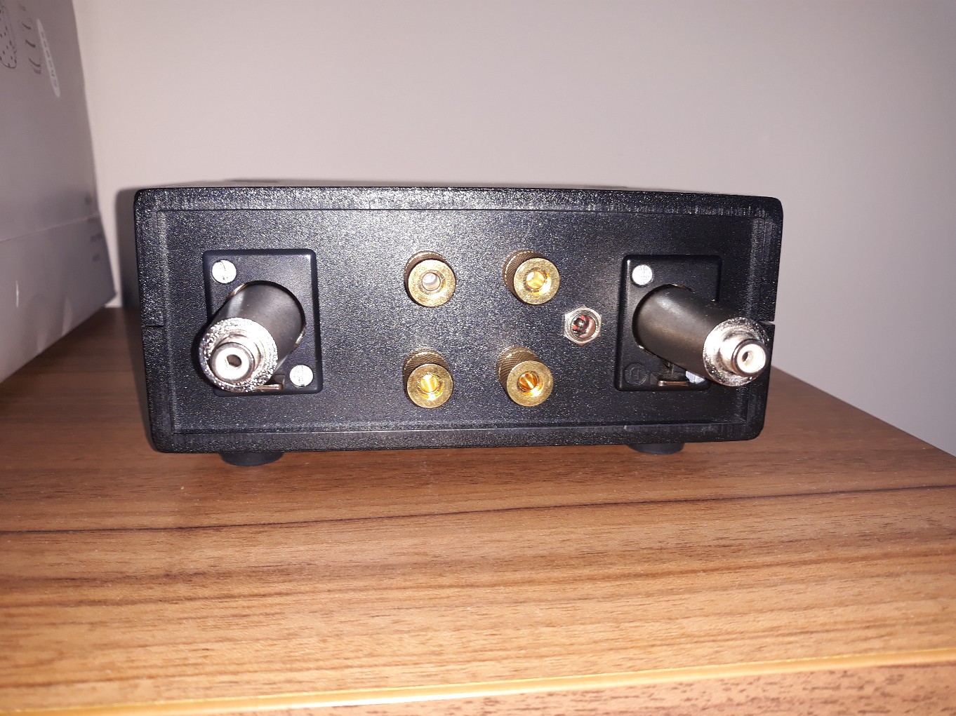

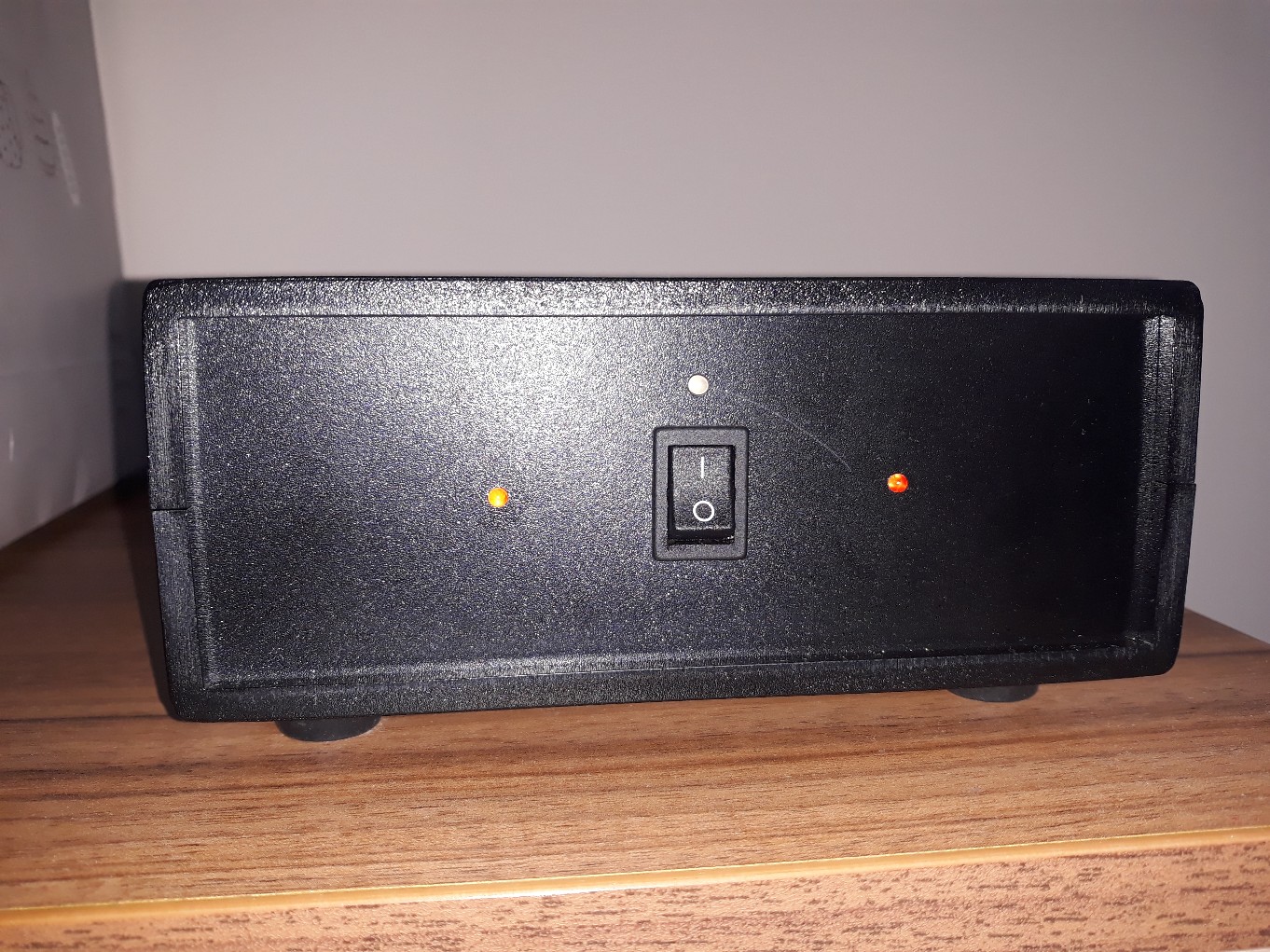

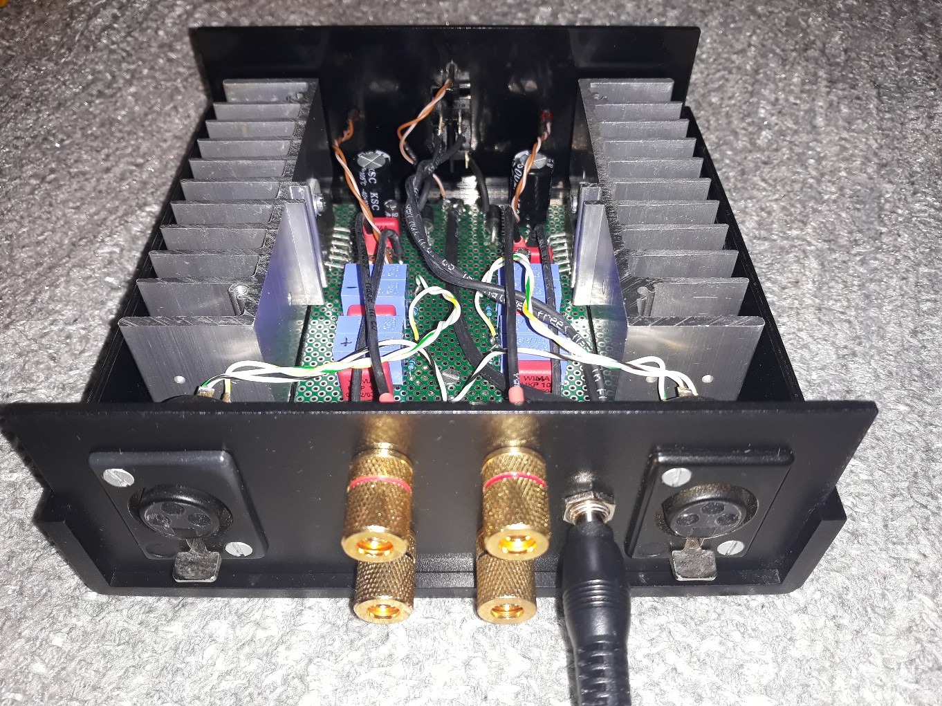

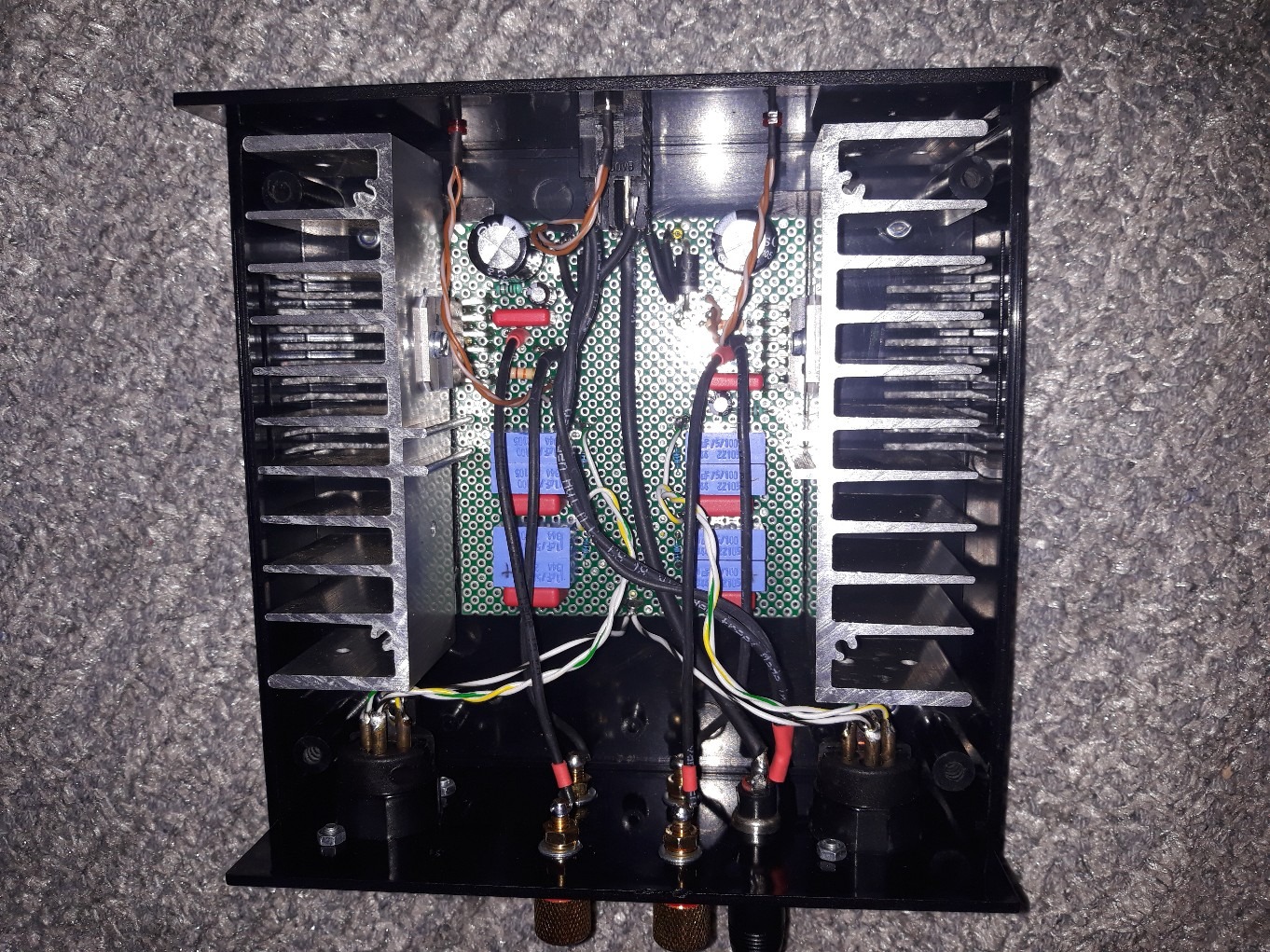

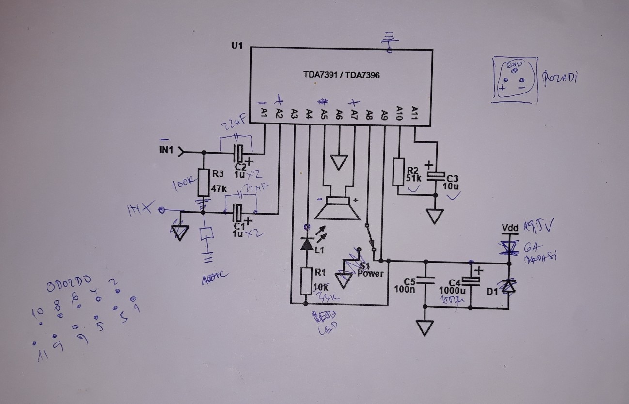

There are good car amplifiers, for example this TDA7396 plays great. I made it to have a small amplifier to try out speakers and other devices in some crappy plastic box. I use an original ASUS brick power supply 19.5V 120W from an old laptop.
Power with 1% THD is 2x15W at 8ohm, 2x30W at 4ohm. Max. power is 2x45W at 2 ohms (and it is connected in bridge mode!).
The amplifier has balanced inputs, for the SE connection to the preamp I use BAL/SE adapters.
This is easily assembled on a raster board. Only the board must be turned at 45 degrees due to the spacing of the legs on the TDA. Vired vith VDHCS18 and some silver plated copper vires in teflon insulation.
