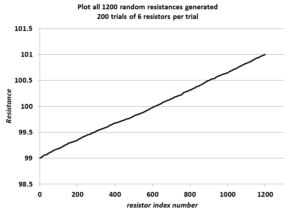

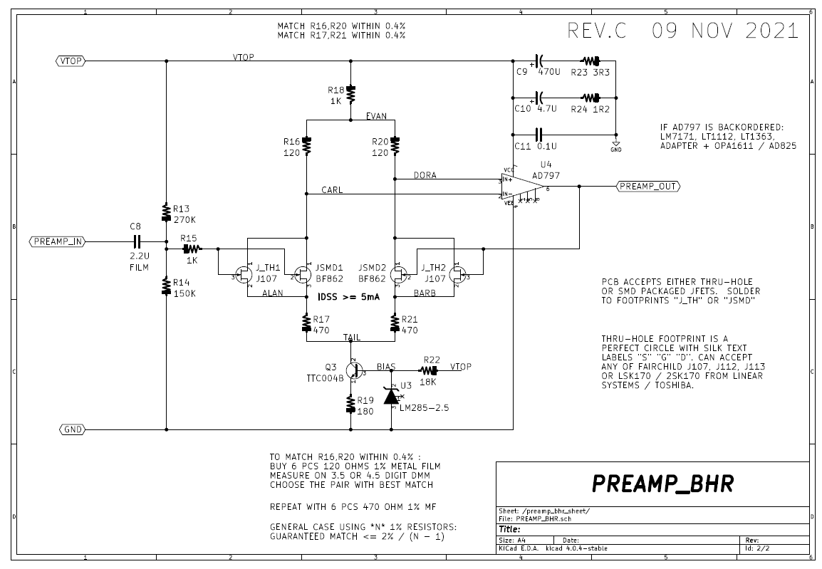

A worst-case assumption is six values uniformly distributed from 99 to 101 inclusive - that's five divisions starting a t 99 and incrementing by 2/5 of an ohm:I got interested in obtaining better-than-1% matching of metal film resistors, especially "uncommon" values among the E96 series of standard resistors, that are not offered / are not stocked in the (much more expensive) 0.1% tolerance grade.
I decided I was willing to buy six resistors and pick the best matching pair among them, then discard the other four. So I put together a little Monte Carlo simulation to see just how good or just how bad the results might be. Assumptions built into the simulation
[*]Resistors are "100 ohm, 1% metal film" devices. Smallest possible resistance is 99.00 ohms, largest possible resistance is 101.00 ohms

What I'm wondering is why you don't buy 100 or 250 resistors and have a bunch extra in stock for other projects, as they're around a cent (0.01 USD) each. With that you can number each resistor (just put them in a cardboard edge or somehow kept separate left to right), measure each and put its value in a spreadsheet with each number, and sort both fields by resistance, as I show below. You'll get dozens of pairs that are arbitrarily close.
They certainly match better than a UNIFORM spread would indicate!Mark,
My experience is that resistors made together match better than random spreads would indicate.

I suspect from the measure values, the manufacturer also tests the resistors and any that are within .1% of target value are selected and marked for .1%!

Here's a dump of the first 200 Monte Carlo trials. The six resistor values are printed (in sorted order for ease of reading), then the best match. If the best match is less than or equal to 0.05%, an E (for Excellent) is printed. In those 200 trials, 113 were Excellent, which is 56.5%. Not 93%.
All 200*6 = 1200 random numbers are included in the dump. If you sort them and plot the data, you see a straight line, just as expected from uniformly distributed random numbers.

99.21613 99.24890 100.50702 100.80426 100.83331 100.92981 match 0.0288 % E
99.00037 99.34113 99.54291 99.74219 100.49347 100.61365 match 0.1196 %
99.00806 99.43665 99.54889 99.92151 100.05548 100.14832 match 0.0928 %
100.18463 100.39410 100.40350 100.47754 100.84387 100.87555 match 0.0094 % E
99.33569 99.34253 100.59216 100.63599 100.73193 100.82672 match 0.0069 % E
99.00543 99.07043 99.26111 100.05792 100.10583 100.12518 match 0.0193 % E
99.60620 99.61725 100.44568 100.52966 100.72784 100.79852 match 0.0111 % E
99.45081 99.45557 99.81445 100.05145 100.31750 100.97803 match 0.0048 % E
99.03229 99.55634 99.81830 99.89288 100.59662 100.79517 match 0.0747 %
99.14673 99.19220 99.45581 100.02594 100.46735 100.72906 match 0.0459 % E
99.07220 99.76361 99.87701 100.21002 100.68500 100.84039 match 0.1137 %
99.49536 100.28186 100.37360 100.40259 100.91223 100.96936 match 0.0289 % E
99.19403 99.56250 99.59296 100.92902 100.93567 100.96564 match 0.0066 % E
99.31683 99.87573 100.38110 100.84381 100.90936 100.93774 match 0.0281 % E
99.11145 99.29108 99.63586 99.75311 99.80511 100.92480 match 0.0521 %
99.01117 99.49811 99.72632 100.00818 100.30414 100.39197 match 0.0876 %
99.06537 99.60382 100.29675 100.35071 100.52887 100.97650 match 0.0538 %
99.55261 99.89227 99.94666 99.94971 100.11835 100.78760 match 0.0031 % E
100.11414 100.25818 100.28345 100.53113 100.74335 100.76587 match 0.0224 % E
99.10730 99.68091 99.68488 100.00629 100.02893 100.40369 match 0.0040 % E
99.64642 99.87372 100.15192 100.29236 100.43445 100.84119 match 0.1402 %
99.58386 99.84534 100.26770 100.29639 100.40735 100.88733 match 0.0286 % E
99.57031 99.70294 99.89105 100.44806 100.79547 100.88043 match 0.0843 %
99.59052 100.03827 100.21802 100.22430 100.63672 100.81519 match 0.0063 % E
99.49811 99.75494 100.15387 100.17609 100.70929 100.78918 match 0.0222 % E
99.34253 99.45093 99.56665 99.64246 100.57770 100.99530 match 0.0761 %
99.05988 99.30200 99.93677 100.04626 100.40991 100.97125 match 0.1096 %
99.38208 99.45367 100.52570 100.53137 100.59137 100.97473 match 0.0056 % E
99.54254 99.75763 100.43042 100.50958 100.64142 100.93475 match 0.0788 %
99.69653 99.74078 99.86493 99.97076 100.36597 100.44720 match 0.0444 % E
99.14941 99.65137 99.82233 100.43787 100.76611 100.76904 match 0.0029 % E
99.54889 99.85162 99.90283 100.52179 100.53113 100.73553 match 0.0093 % E
99.45721 99.80334 100.03601 100.20276 100.73730 100.79797 match 0.0602 %
99.32257 99.68134 99.82202 100.24402 100.29840 100.63727 match 0.0542 %
99.56555 99.70074 99.75769 99.85748 100.59595 100.71344 match 0.0571 %
99.33295 99.70923 100.22144 100.35938 100.61676 100.91180 match 0.1376 %
99.27911 99.74396 99.84833 100.28461 100.31512 100.77179 match 0.0304 % E
99.05847 99.65125 99.72729 100.63684 100.67151 100.90540 match 0.0344 % E
99.29645 99.41907 99.62170 99.87152 100.52515 100.82111 match 0.1235 %
99.32068 99.88586 100.27020 100.67194 100.77563 100.97363 match 0.1030 %
99.26398 99.67108 99.67609 99.83740 100.18866 100.52332 match 0.0050 % E
99.47430 99.67938 99.74701 99.78271 100.28601 100.92261 match 0.0358 % E
99.08490 99.30560 99.39160 100.55267 100.83368 100.86395 match 0.0300 % E
99.23303 99.30420 99.30945 99.84985 100.27026 100.82532 match 0.0053 % E
99.08551 99.66046 99.83063 100.57800 100.62311 100.74023 match 0.0448 % E
99.29034 99.52576 100.49554 100.49884 100.52936 100.73499 match 0.0033 % E
99.19843 99.23273 100.09924 100.10950 100.19122 100.48236 match 0.0102 % E
99.40417 99.55200 99.55231 99.63873 100.05273 100.46912 match 0.0003 % E
99.13531 99.78796 100.27484 100.55524 100.71106 100.88770 match 0.1550 %
99.13794 99.49164 99.65350 99.73657 99.82916 100.59259 match 0.0834 %
99.06586 99.57831 99.66113 100.14166 100.54846 100.98584 match 0.0832 %
99.22821 99.54248 99.99536 99.99762 100.67896 100.96637 match 0.0023 % E
99.33710 99.41119 99.50110 99.76208 99.86993 100.92279 match 0.0746 %
99.36395 99.56787 99.79150 99.87366 100.18951 100.26654 match 0.0769 %
99.10535 99.60614 99.67969 100.03668 100.05927 100.07220 match 0.0129 % E
99.45667 99.64459 100.20288 100.85883 100.95697 100.98975 match 0.0325 % E
99.28284 99.30841 99.79785 100.52606 100.59741 100.90356 match 0.0258 % E
99.82715 100.09607 100.63611 100.76874 100.89240 100.99121 match 0.0979 %
99.53442 99.59314 99.75085 99.77747 100.09326 100.30847 match 0.0267 % E
99.16028 99.23157 99.43549 100.05774 100.18671 100.68597 match 0.0719 %
99.09381 99.54657 99.76727 99.86908 100.18060 100.47070 match 0.1020 %
99.12122 99.21826 99.63873 99.96625 100.60760 100.82971 match 0.0979 %
99.35480 99.53998 99.60889 99.75397 99.77478 100.98737 match 0.0209 % E
99.28925 99.70990 100.16492 100.29004 100.37946 100.56714 match 0.0892 %
99.08612 99.47430 99.51599 99.69208 99.71942 100.08612 match 0.0274 % E
99.11230 99.45941 99.68341 100.02802 100.47638 100.85278 match 0.2252 %
99.15338 99.26501 99.67773 99.68579 100.00073 100.28754 match 0.0081 % E
99.70026 100.35944 100.45294 100.66681 100.81323 100.82709 match 0.0137 % E
99.09991 99.31354 100.01007 100.34418 100.52686 100.58563 match 0.0585 %
99.07349 99.29443 99.68402 100.35767 100.47858 100.57050 match 0.0915 %
99.01544 99.06445 99.95544 100.09186 100.20337 100.63013 match 0.0495 % E
99.16125 99.19543 99.37006 100.11749 100.29773 100.55811 match 0.0345 % E
99.84167 100.28833 100.31219 100.33893 100.44269 100.73688 match 0.0238 % E
99.15540 99.92175 99.93793 99.93970 100.51996 100.92975 match 0.0018 % E
99.92529 100.38135 100.47656 100.52313 100.83960 100.97125 match 0.0463 % E
99.20093 99.85236 100.14172 100.22101 100.93927 100.94855 match 0.0092 % E
99.35889 99.47504 99.71838 99.92261 100.17175 100.66846 match 0.1169 %
99.16919 99.55597 99.73138 99.83917 99.99390 100.49377 match 0.1081 %
99.31989 99.41608 100.14557 100.29883 100.71960 100.78699 match 0.0669 %
99.45575 99.88770 100.02142 100.15607 100.26971 100.85101 match 0.1135 %
99.97748 100.10083 100.16766 100.41888 100.64764 100.81287 match 0.0668 %
99.35419 99.45453 99.50610 99.75317 100.55884 100.57410 match 0.0152 % E
113 trials (out of 200) matched better than 0.05% (marked Excellent "E")

If anyone is wondering about practical applications of these ideas, let me introduce you to the Ship Of Theseus amplifier and its interchangeable Front End cards, including "Bon Homme Richard". SOT offers seven different Front Ends, each named for a famous American ship. You can read about the complete Ship Of Theseus project (here) . Post #1 of that thread includes a large .pdf file with schematics and descriptions of all seven Front Ends (link).
The section which covers Bon Homme Richard is attached below. Notice the discussion about resistor matching; the lab methodology should look quite familiar.
_
_
