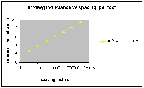

Sorry. I guess I don't understand. Even with no loop, a straight wire has inductance. The 25nH/inch number is just a commonly used ballpark guesstimate, for smallish wires and pcb traces, until the actual geometry can be used to get a better estimate.
gootee said:Sorry. I guess I don't understand. Even with no loop, a straight wire has inductance.
Actually, a straight wire has infinite inductance, a consequence of integration of the 1/r field and the increasing area of integration.. The reason it does not measure as infinite, is because the return current cancels out the bulk of the external field. I attached a chart of inductance vs spacing for a #12 wire pair. As can be seen, the inductance continues with distance. Course, to get the inductance large requires a rather large universe, eh?😉
gootee said:The 25nH/inch number is just a commonly used ballpark guesstimate, for smallish wires and pcb traces, until the geometry is used to get a better estimate.
Yup. However, it is a ballpark figure used within the constraints of a ground plane and PCB work. For a wire that is not poised above a ground plane which serves as the current return path, as the current discussion entails, that number cannot be used.
Cheers, John

I'm still thinking about the resistance vs inductance that bastek posted.
Ran the numbers in excel, it shows as extremely linear, with a y axis intercept of -5uH, equation is L (uh)= (20.3 R )- 5...sorry can't post the plot as a jpeg, ..
The number of turns doesn't scale with the resistance, so it's a combo of guage and turns per inch. L scales as the square of the turns, so double the resistance should be 40% more turns, and probably 70% of the wire cross section...as a first guess.
Cheers, John
