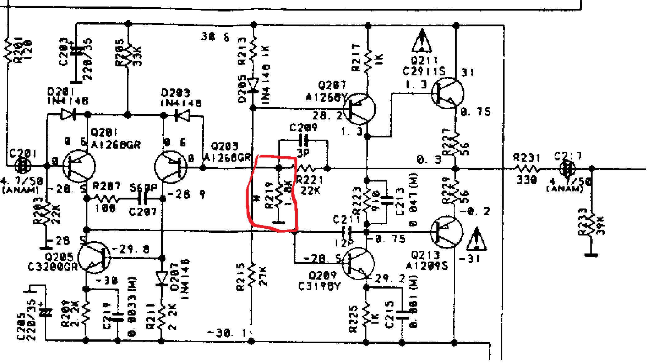

JMFahey so is it connected via the diode d207 and resistor r211?
The opamp circuit matches up to your circuit like this:
Rg is R219
Rf is R221
Vout is junction of R227 and R229
Opamp + input (Vin) is Base of Q201
Opamp - input is Base of Q203

Yes I get that now. And it also got me thinking well is that not a discrete opamp? Can it not be used to replace the chip type? For an expert I guess the answer is yes. I mean cannot it be copied and made into an opamp.
Random question but cannot the preamp/discrete opamp not be improved? At a glance for an expert could one just glance at it and figure what components can be replaced. I'm not just talking about upgrading caps etc because that was the plan in the first place hence the thread. I'm referring to the schematic for the Teac
Yes, your circuit is a discrete op amp. And almost all modern power amplifiers employing conventional topology are discrete op amps.
Understanding op amp circuit configurations means you understand a lot of discrete circuits too.
Sometimes minor improvements can be made. You already know about replacing caps. Sometimes replacing certain resistors with low noise units can make a modest improvement. But often there isn't much that can be done.

FWIW I have been designing and making MI and PA equipment since 1969, and am an early user of Op Amps ... which way back then were VERY limited: choice was between 741 , 741 and 741 😉
Not only I had limited choices, lots or real PRO equipment manufacturers /such as HH, Oberheim and even Neve or Studiomaster) used them because ... there was nothing else!!!
In spite of that, lots of cool things could be made, but in some critical places they simply were not good enough ... and that´s an understatement.
I resented high hiss level when used as balanced microphone preamps, so had to cook my own , discrete one.
Very simple, just a PNP differential pair and a single NPN transistor loaded with 4k7 , fed from +/-15V and with modest 10X (20dB) gain ... which was all that was needed, after that signal levels were more reasonable and hiss was not that big a problem.
Used them for ages, until RC4558 appeared, which was designed specifically for Audio, had lower hiss and, of course, used PNP transistors 🙂
Only audio specific Op Amp before it was oddball RC4739 , but it was not widely available, had oddball pinout, and required external compensation, so it was never very popular ..... plus .... "home cooking always tastes better" 😉
