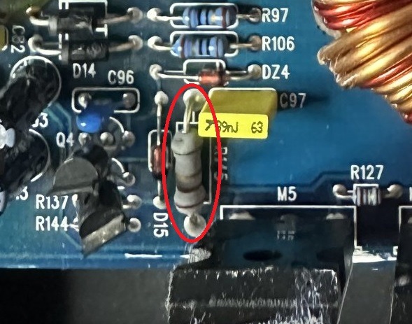

The standard E24 series value is 43 ohms 5%. You're not gonna find a 44 ohm 5% part.
Use the highest power metal oxide resistor that will fit properly on the board.
