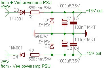

You can use this circuit to get +/-15V from amp power supply +/-35V.(for preamps supply- not for auto on circuit)
Regards
