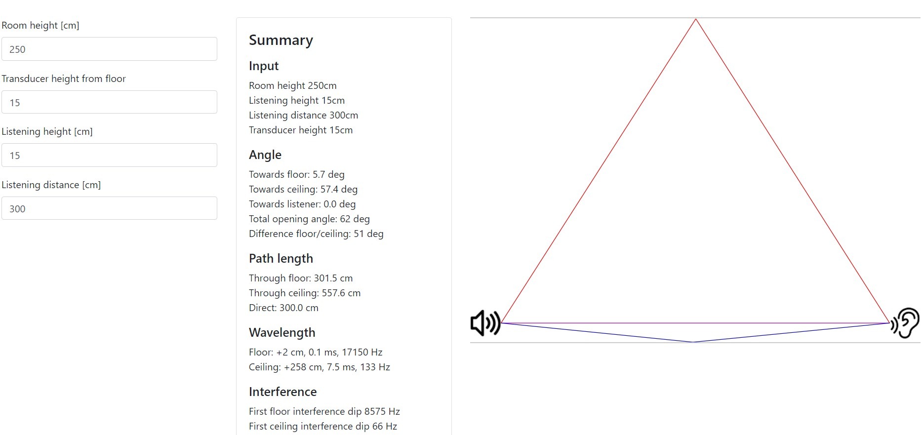

Yeah ground plane measurements seem reasonable way to do it as long as the "floor" is reflective at the low frequencies. If both transducer and the mic was about 15cm / 6" from the ground and mic was 3m / 10' away then the path length difference through the ground is only about an inch (~2cm) which is 1/2wl above 8kHz which means the interference starts to affect the result above ~4kHz, in ideal case In reality there would probably be some refraction and what not. Possibly not much of an issue inspecting the relatively low frequencies through.
ps. Exploiting simple specular reflection calculator for this, ignore the ceiling stuff for this
There are limitations on the ground-plane method.Yes. I am able to get resolution down to 20 Hz, as long as the ambient noise floor is good... i.e. waiting for no vehicles or other noise sources.
In theory, a ground plane measurement is equivalent to anechoic. In practice, we are limited by environmental considerations. But the rotation of the device under test is no obstacle at all.

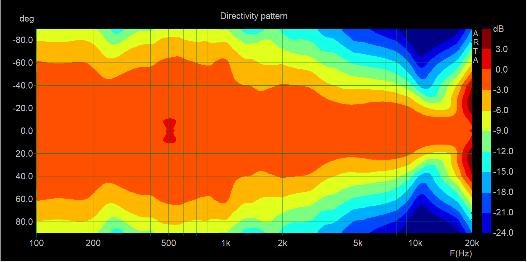

2D contour plots (normalized) plus off-axis freq resp will give you most of the information you need.

I’m still curious about speaker balloons generated from Klippel NFS. It strikes me as odd that they’re not more commonplace - or perhaps they are, and we simply aren’t told about them.
It would be nice to have the measured NFS data balloon from Erin or Amir available as a SOFA or OpenDAFF (both open source with no license needed for viewer software).
Interesting, can you elaborate on eBay you mean with near- and far- field radiation point?It’s not about a 3D plot of data, but the ability to determine the near-field and far-field radiation point, and the derivation of the complex radiation pattern.

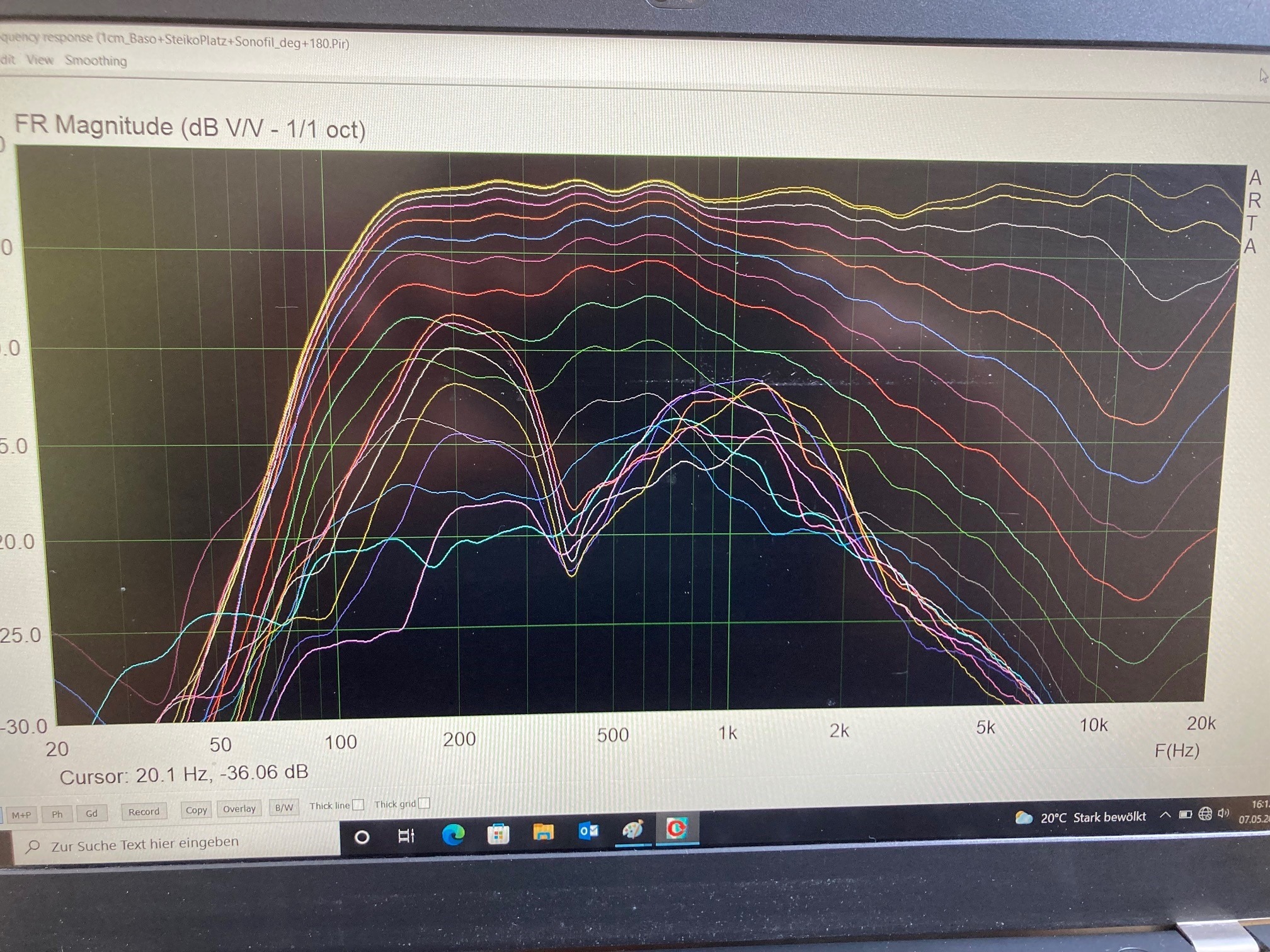

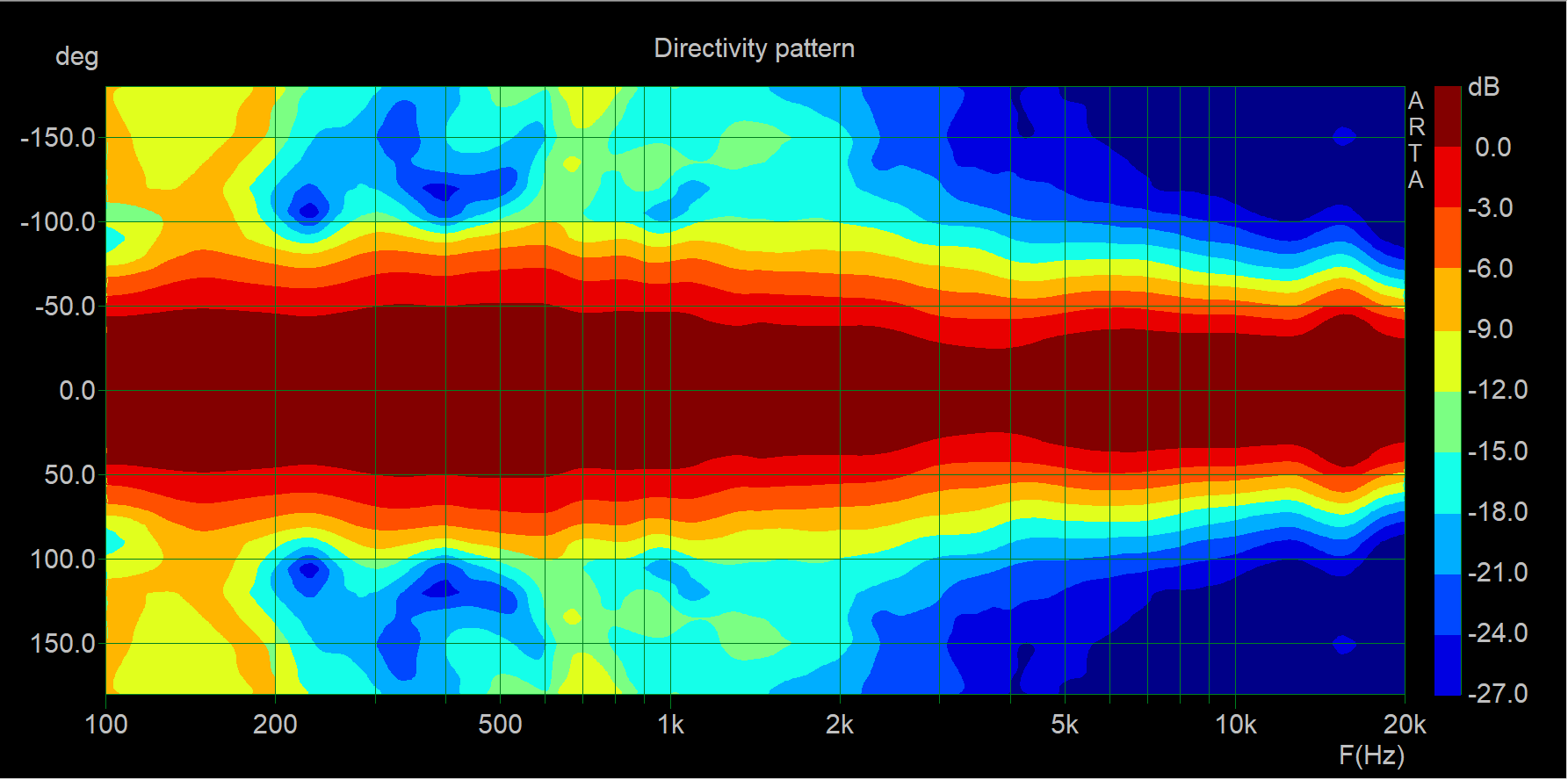

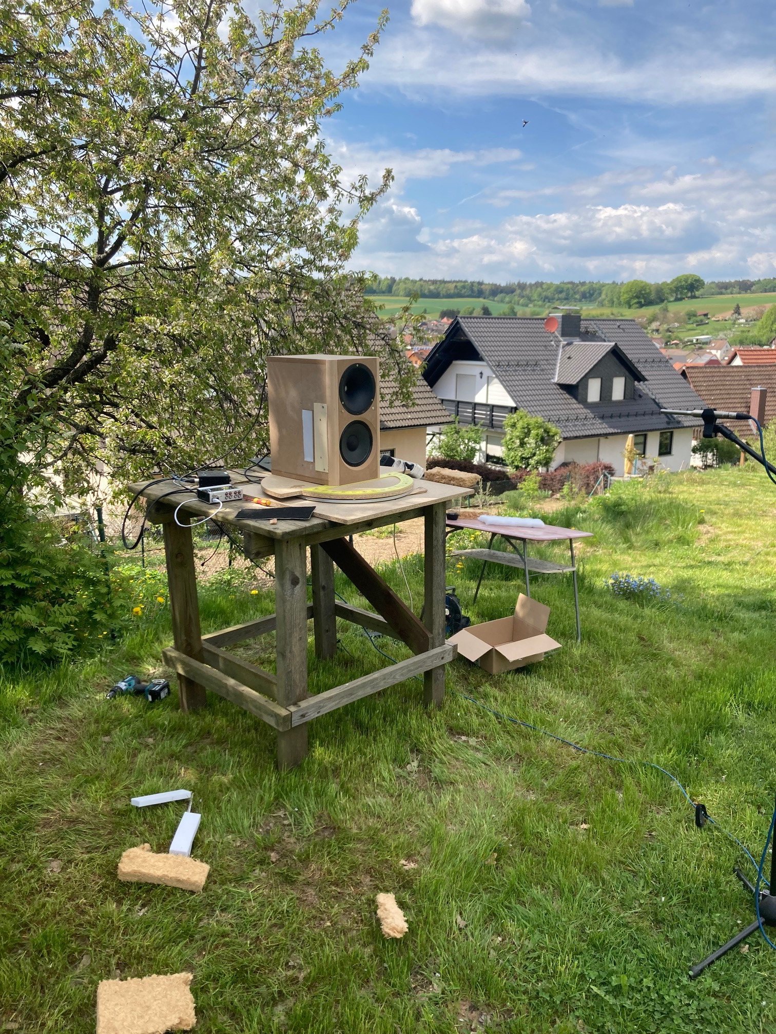

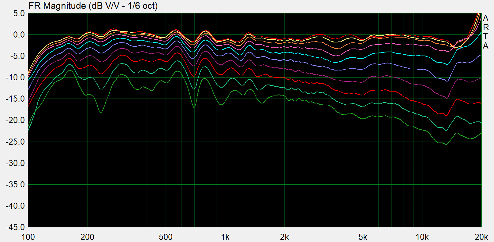

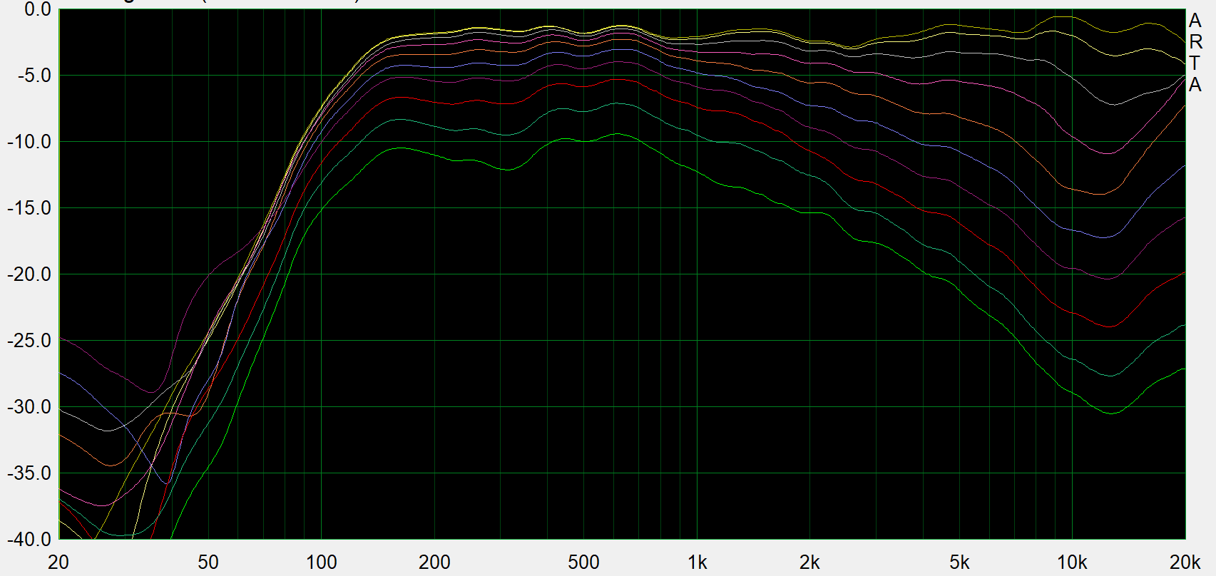

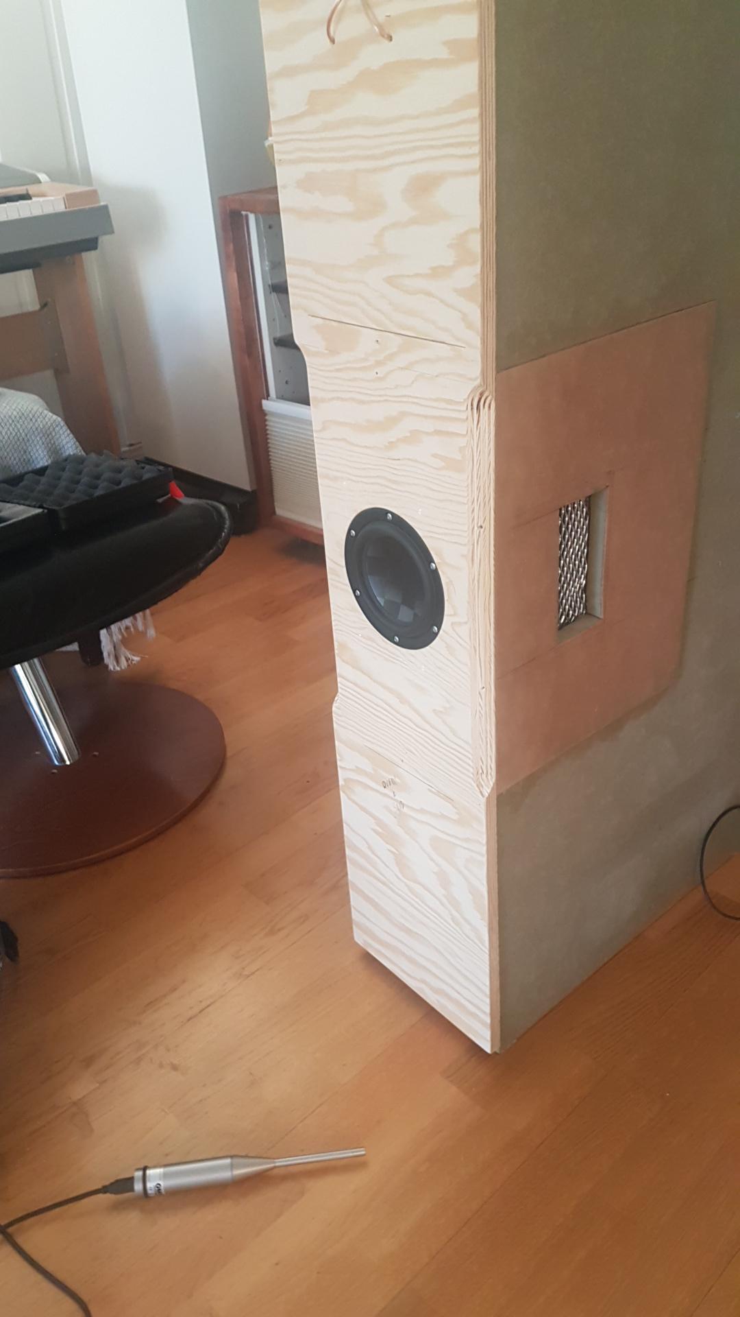

I am also in the process of building a Dutch Dutch 8c clone. So far I've had very good results with 1cm Basotect in the side openings and some wood shavings inside. But I'm not super happy yet. I would like to get the widening between 400-700Hz under control. The waveguide will also be revised again.
That is quite good already, what the back side looks like past 90 degrees off-axis?
Regarding the slight widening it almost looks there is narrowing at 200Hz instead Have you copied the dimensions exactly? I suspect the pattern depends on the outside dimensions and the fact that the ports need to be at the baffle edge, use low diffraction edge as they have.
Hi, yes I copied the 8c exactly but today I noticed the openings are 3cm too far back. I will change that. You can see measurements from 0 to 180 degrees in the appendix.

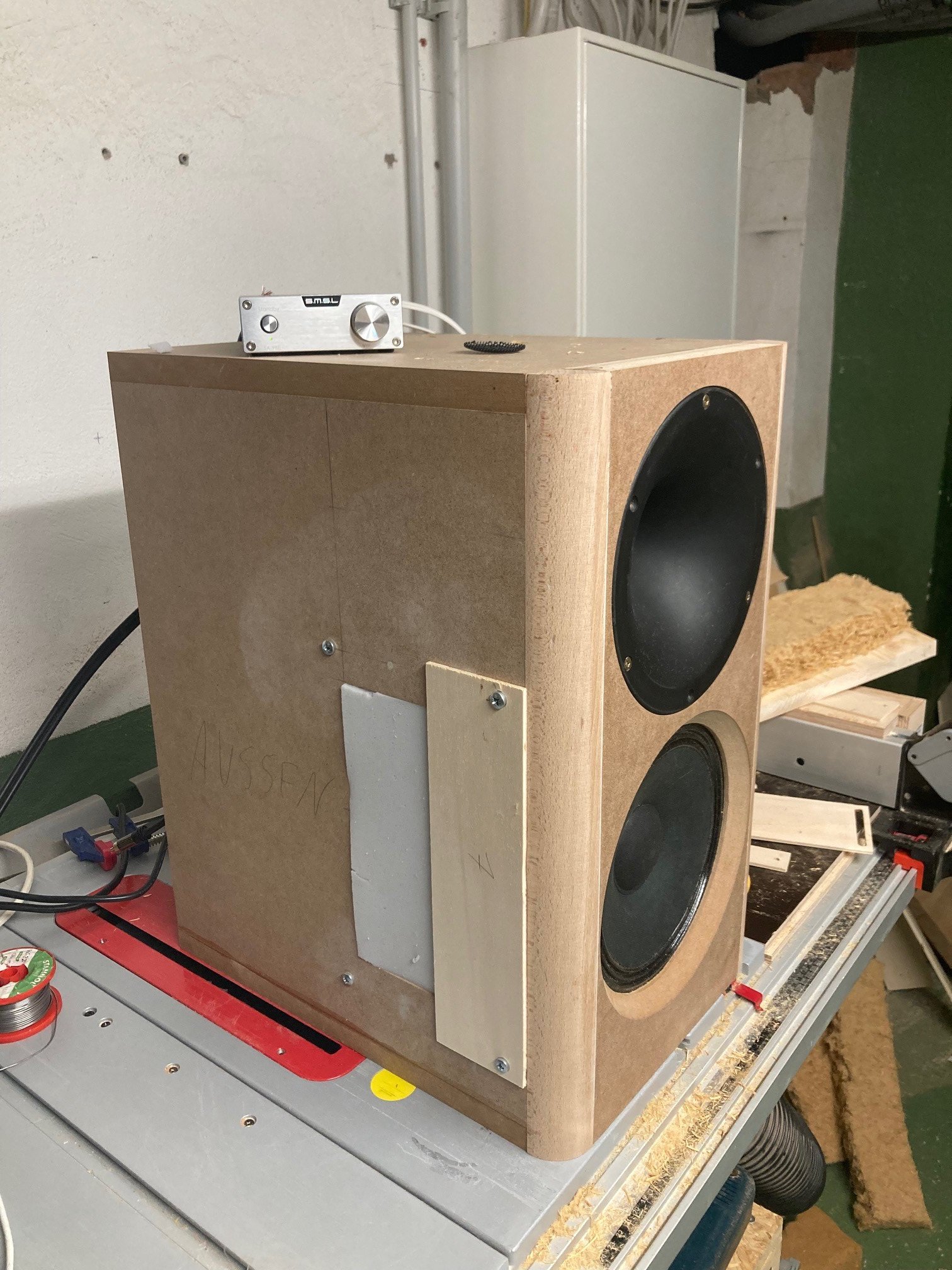

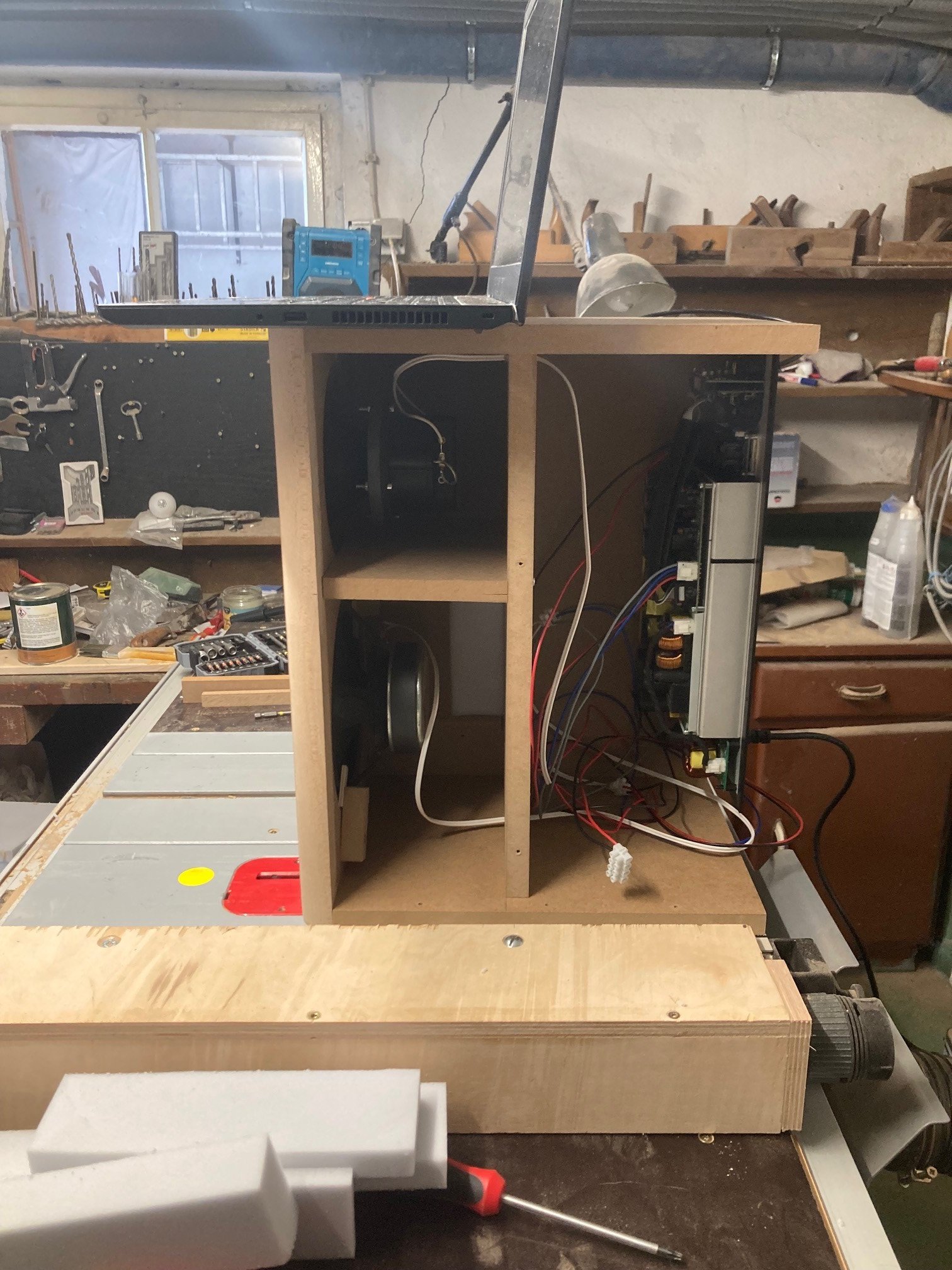

We lately did some idea thefts / espionage and experiments on cardoide. We made a mock up cabinet for measuring on different openings, degrees of stuffing and uniform damping materials. At the first attempts, the closed cabinet sounded far better as the cardiode sounded rather wooly. Current adjusting are slots close to rear inner wall, area approx 40% of Sd and a felt density near 40 kg/m3. Just now we do compare different felt thicknesses between 25 and 50 mm. ( Dacron based pro- mat for HVAC sound attenuators). Cabinet inner depth is about 1.5x driver dia. Now the music and details really opened up and beats the closed box. Not that closed box 0,7 qtc bottom, but more defined. That might fit fine in our next line array with subwoofer drivers in closed cabinets at rear baffle. Drivers considered are Satori 1" BE with wave guide for tweeter, Satori 5" TX from about 100 hz and Wavecor 8" subs in closed cabinet at the rear. A Hypex 503. with dsp near the base plate at rear allows for different " nightmares" for extensive trials, measurements and fails, hi-fi police's head-shakes, good friends support, minor WAF input and hopefully at last - success.
Early mockup:
Early mockup:
So it goes on.
New midrange driver /Visaton Al200)
New waveguide
Better enclousure
New damping
Better measuring vicinity
Much better success
New waveguide
Better enclousure
New damping
Much better success
Hi Markback,
my old prototype enclosure was still too leaky at too many steles. The new one is now tight except for the outlets. The dimensions are exactly the same as the original. I think the highlight of the damping is that there has to be a bit of pressure despite the open housing. So it must not be as open as a dipole. There is 1cm thick Basotect in front of the slits. It is much harder for the air to get through there than through rock wool, Sonofil etc. At the moment there is only Sonofil in the housing. But I want to play with it a bit to eliminate some resonances.

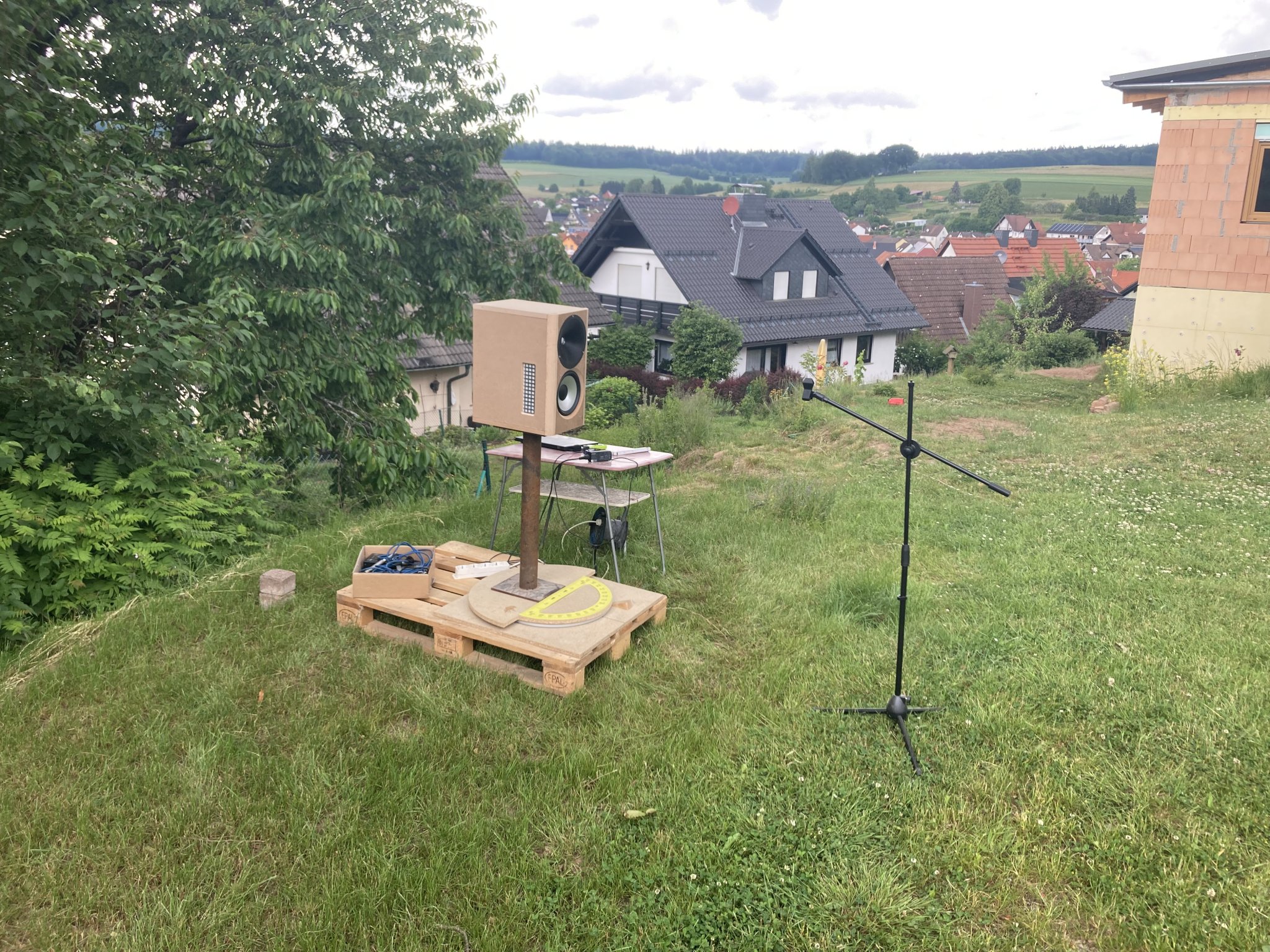

I would flip the mic and speaker around, facing the speaker toward the trees.
That way you will probably be able to even get a slight longer time window.
What window type are you using?
That is really good results squeeze86
Seem you have nailed the outlet material ..... where do you purchase the 1 cm Basotect and is it "real" Basotect or a variant of open cell melamine?
You say you use a new waveguide ... which one?
Have you had any chance to listen to the difference in a room with the outlet/slots closed vs open?

Its the real Basotect, I only cut it into stripes.That is really good results squeeze86
Its my own design, i designed it with ath and Abec.
No. That won't work either, because the midrange cabinet is way too small to use it as a good closed box.Have you had any chance to listen to the difference in a room with the outlet/slots closed vs open?
I use the Visaton KE 25 SC without the grid and without the diffusor in the grid. Yes of course its possible i have also a printed WG for prototypes. I can give you the .stl or the whole ath cfg data if you want. Later the whole Front Baffle will be cut with a CNC.Great results! Pls tell us more about the tweeter and WG. Is it possible to print the WG?
May I ask where you're from? That style of housing and the landscape looks like it could be a few villages over where I grew up.So it goes on.
