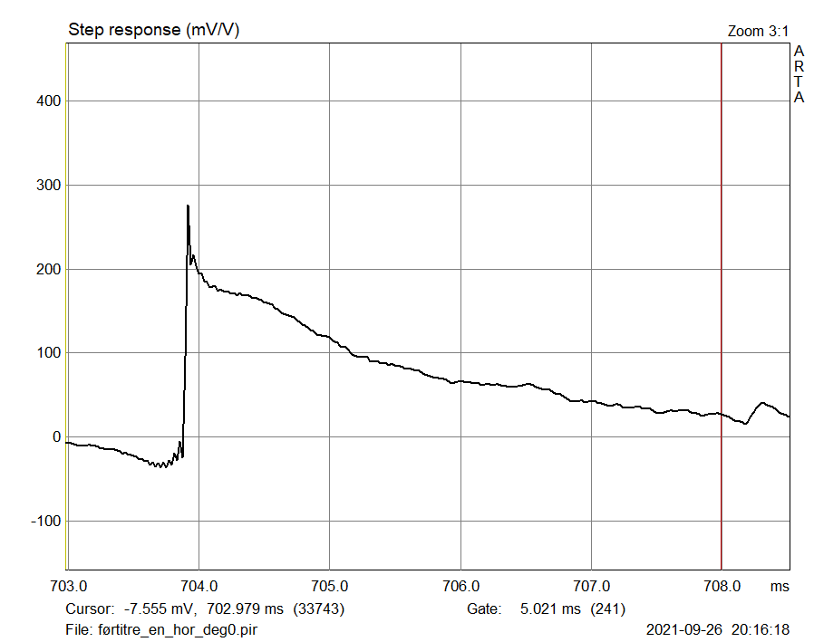

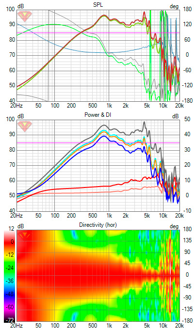

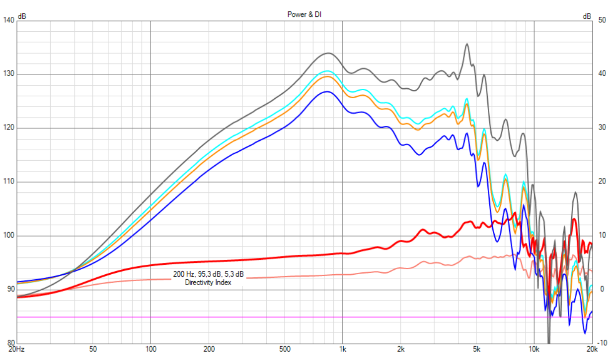

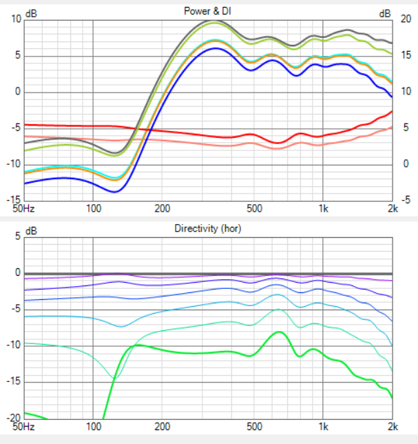

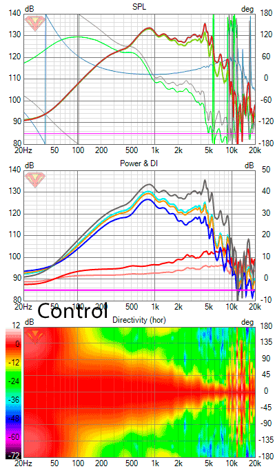

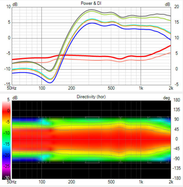

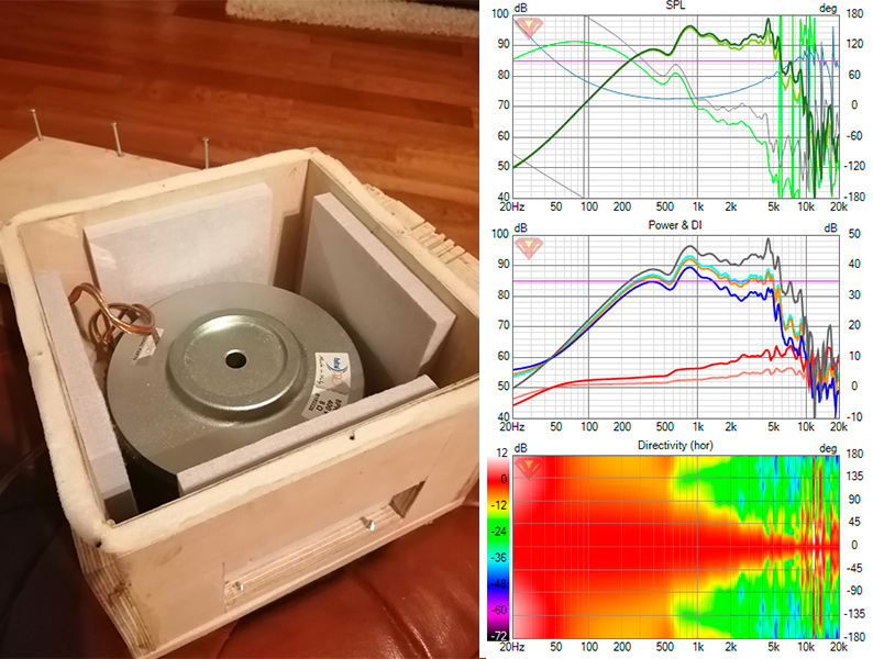

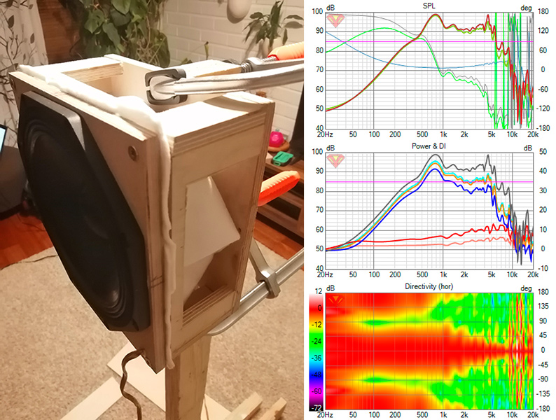

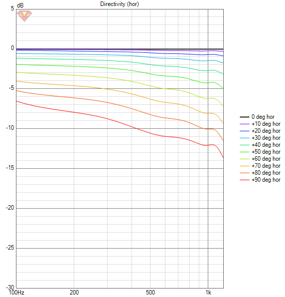

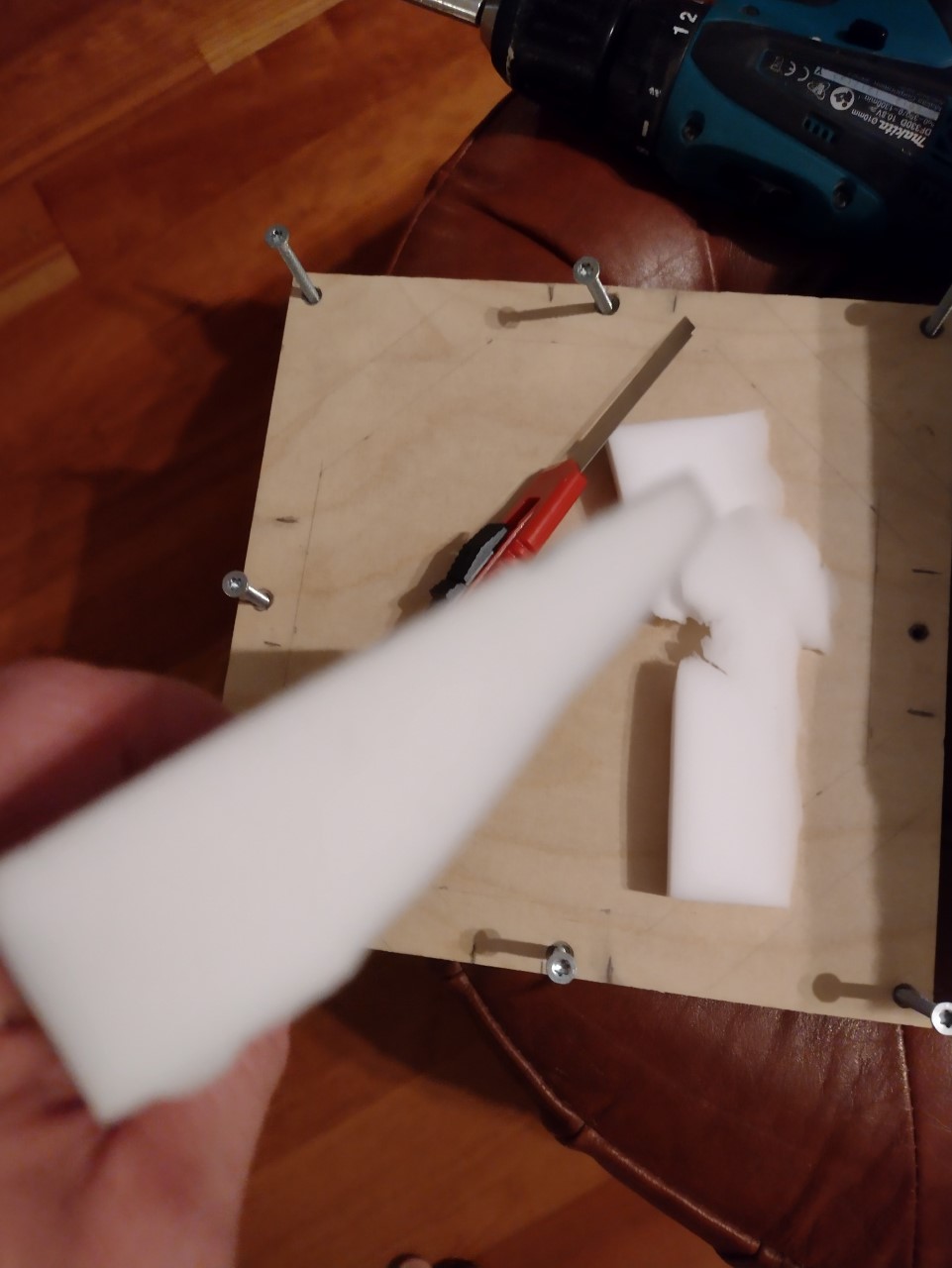

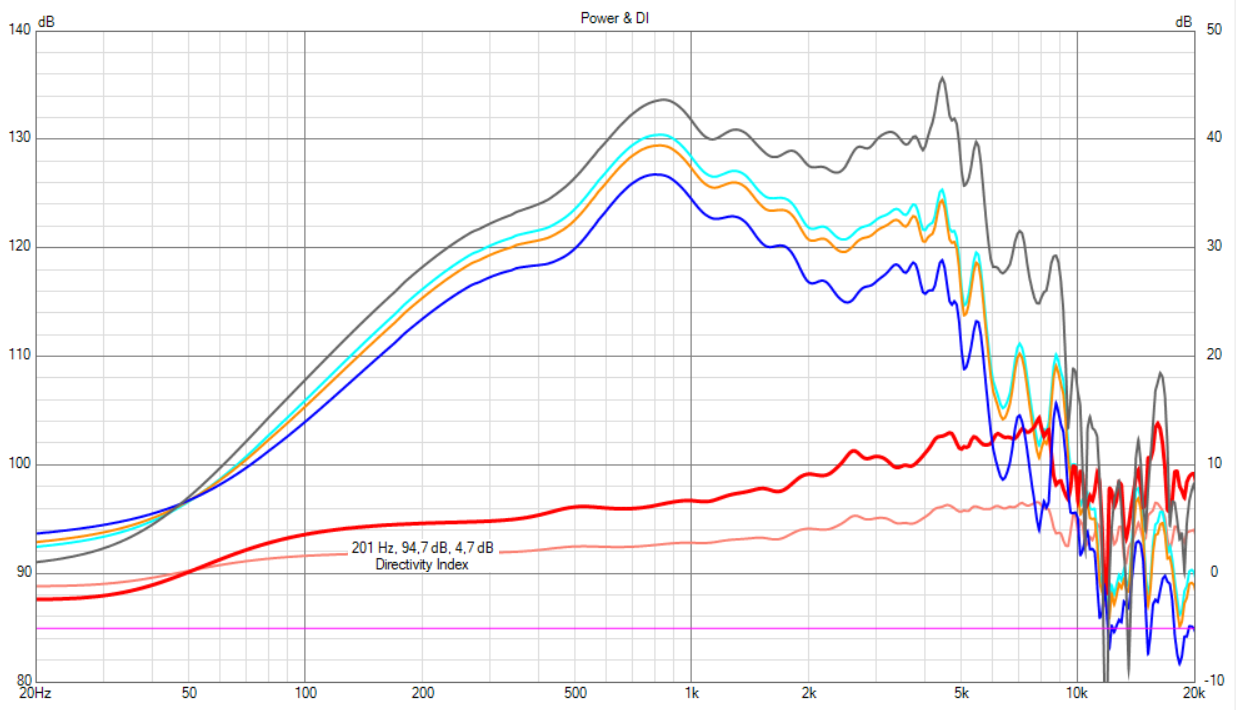

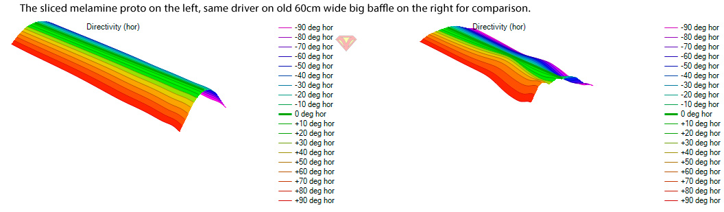

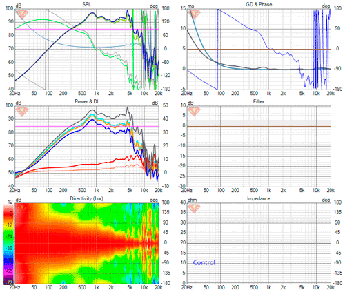

Had a hour of spare time so had enough time to slice the melamine sponges and take measurements. Didn't have time to move the port location or test the new materials that finally got here, some felt and hard acoustic board! can't wait trying them out.
Alright, the DI didn't get any higher (above 6dB), except some at the low end of the bandwidth and a bit smoother DI overall but the smoothness can be a measurement issue (DI bump ~500Hz). The DI is rising, no flat.. I can tilt the DI like so in the emulation by the shelving filter so I think the tilt is due to the damping material, would have to slice and measure some more to see if the DI gets even flatter.
The smoother looking response on the attachments was measured with the sliced melamine sponges. The other one is the control, a box from last measurement set #277 that has melamine sponges on the ports and 1 layer of Ewona insulation on the back chamber.
The idea on the cut was to get the melamine thinner to reduce attenuation and delays as well as the surface more parallel to the driver cone and frame to get more of the sound transmitted (out the box) and less reflected due to the smaller incident angle. The slice clearly had positive effect to the response, but of course I have no way to show what actually happens there in reality 😀
What you all think about of it all, does it make sense, is it all just measurement error or what? The ports are huge on the proto, path length around the port to the front is only few centimeters and the melamine is so thin now I can almost see trough and the response is getting pretty nice. It feels weird so little anything has so much effect but all improvements have been driven by insight from the emulation and it has been working so far so it feels nice. Well, the polar map I haven't been able to replicate exactly in the emulation but all the tunings have been steps closer to the target, flat DI ~200Hz - 1200Hz. Not there yet, getting closer on the flatness, such fun 😀

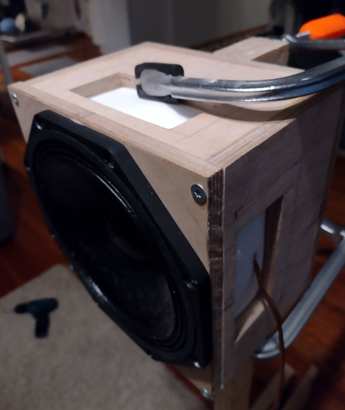

Attachments are:
1. gif showing the difference fast
2. closer look at the control DI line (full melamine sponges)
3. DI with the sliced melamine sponges

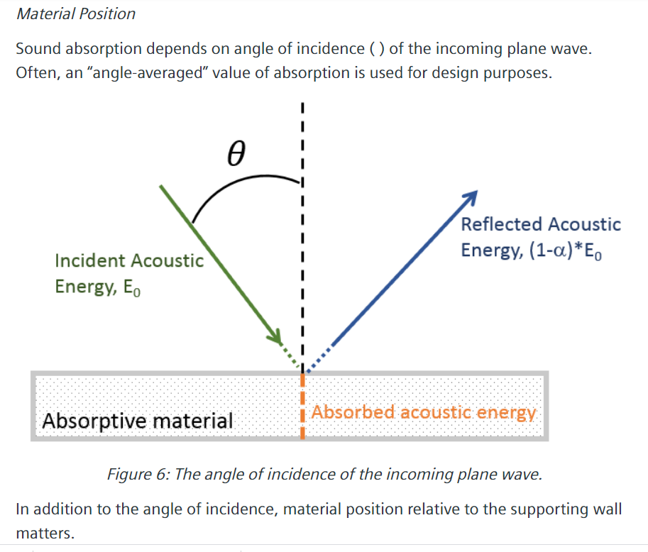

4. illustration of insident angle, taken from Siemens sound absorption article
5. the DUT
6. Sliced melamine seen from the end. The narrow tip goes against baffle, flat part against sidewall and wedge towards the cone.
Attachments are:
5. the DUT

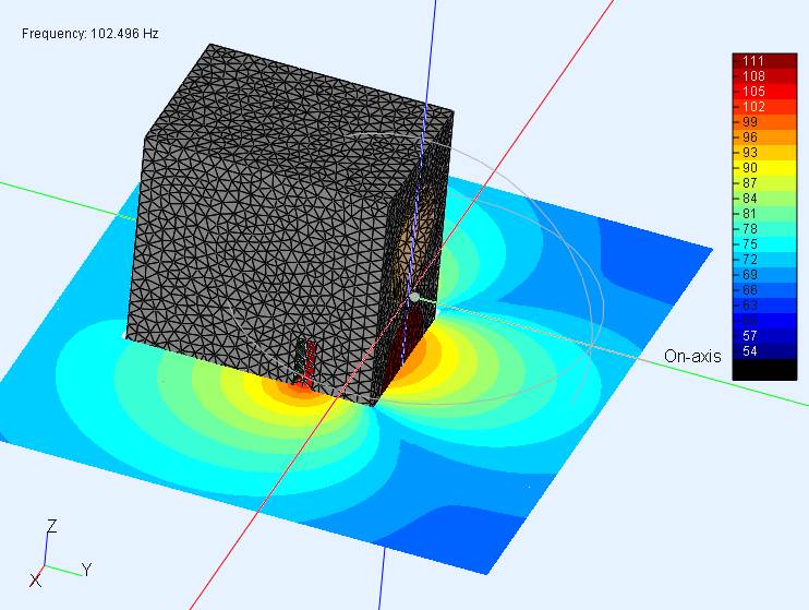

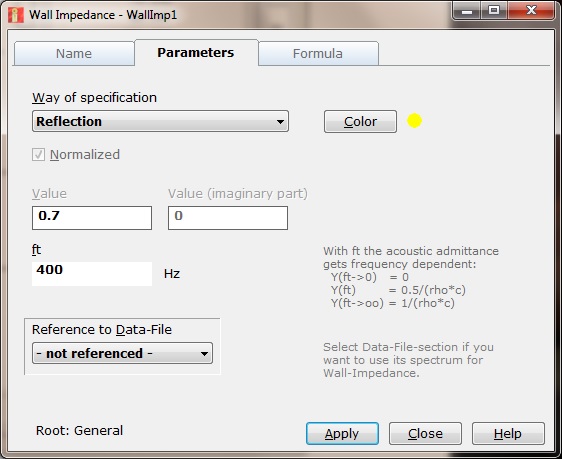

Don, how are you planning on modeling the damping material in AKABAK? I have been tinkering with various cabinet profiles/vent alignments for the same purpose. However, I have not found a good way to emulate the damping material.
The damping or reflection specs eventually just becomes an acoustic impedance in AKABAK. If you have a measured impedance data file you get the best results. Otherwise if you are experimenting to see what might work use the built in reflection and damping (absorption) wall impedance models. I specify my models as follows only because it makes sense in my mind.
If the wall (chamber surface) is part of a volume intended to contain and attenuate reflections (via volume fill) I use the reflection model like [R,f]=[0.7,400] to approximate mild damping (absorption) using the walls. In the example, the reflections will start high at 70% (LF) and be significantly attenuation by 400Hz.
If the surface is intended to pass the wavefront (port damping) I put a "gateway"surface either in the port tube or at its boundary to the attached chamber. Then I specify a damping model [D,-f]=[1,-700] to approximate the wave front passing through the surface at LF and attenuating significantly at 700Hz. This seems counter intuitive but D=1, means Zn=Zo, which is the impedance of air so the tube acts like its open. As the impedance increases with frequency the port closes off.

It looks like your experiment is working with about 6dB improvement. I've read 5 reviews and some measurements of the DD-C8 and they claim about 10dB. Once I get a model I'm happy with, I might build a box to measure it to see how close the sim was. I have some 8" SilverFlutes lying around that should work.

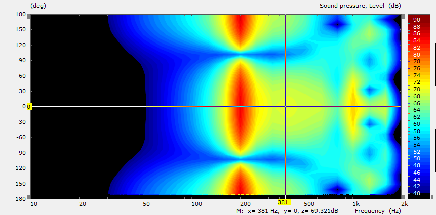

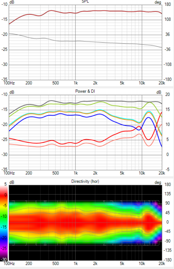

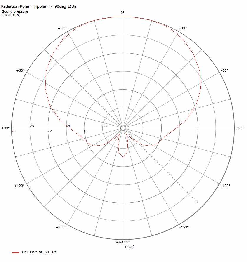

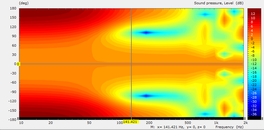

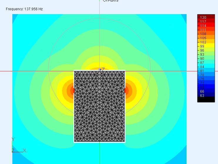

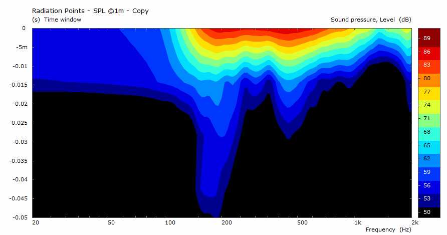

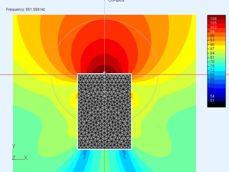

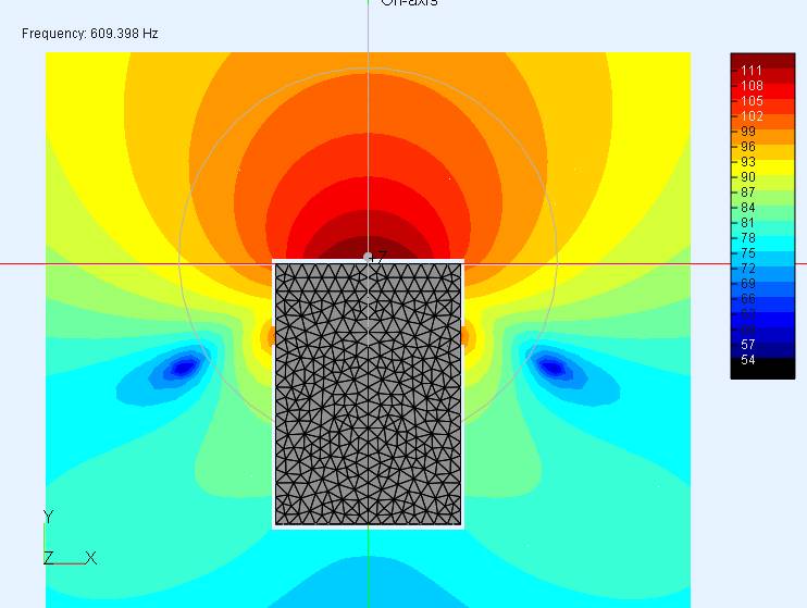

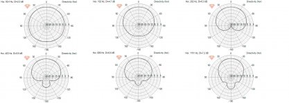

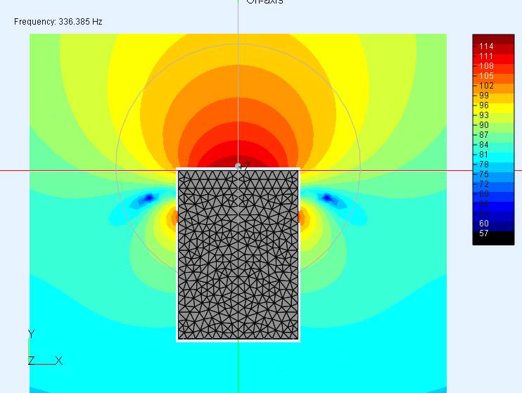

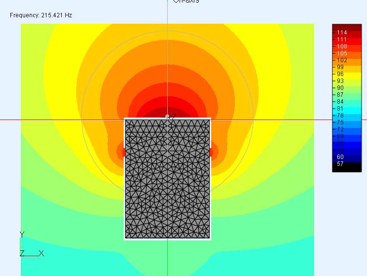

A few graphs so far. Interesting plots showing SPL around the box and interaction between the ports and driver.

Amazing these modern simulations!

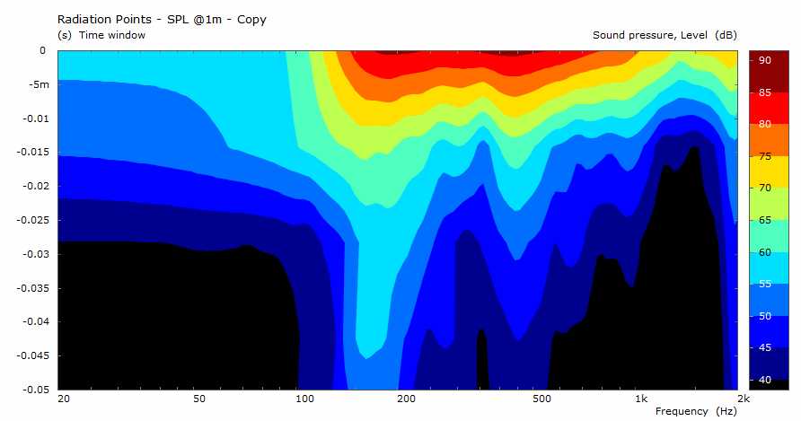

Is it possible in AKABAK to show a dispersion spectrogram 20-20 000Hz? I know there are "always" some specific problematic frequencies anyway where directivity is lost or exaggerated.

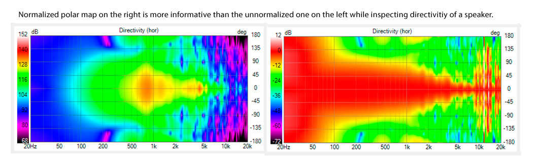

tmuikku, looks like you are showing normalized directivity spectrograms from Vituixcad2. This is OK in this project, but the screenshots don't tell they are normalized... Someone might get confused!
The closest thing I see is a 2D decay spectrogram in VACS. However this is a first time I tried it. Anything more (CSD waterfall) may require REW or Octave.

I'm not sure which improvement you write specifically so I'll post few more graphs since at least few people are interested.
Juhazi, thanks you for pointing that out. I've mentioned the normalization on multiple occasions but don't always remember to make it clear with every post. Since we are tuning the polar response it makes sense to normalize.tmuikku, looks like you are showing normalized directivity spectrograms from Vituixcad2. This is OK in this project, but the screenshots don't tell they are normalized... Someone might get confused!

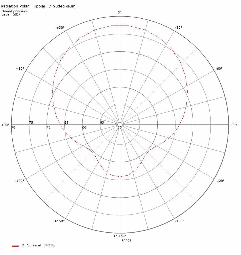

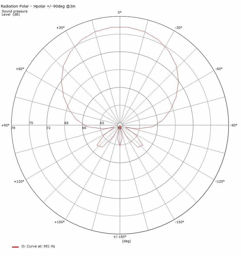

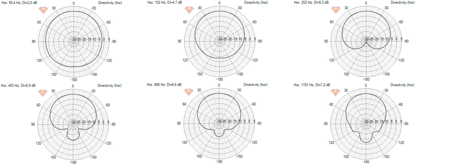

First attachment illustrates the difference between normalization and without. Much easier to see the polar response with normalization. When the DI is smooth EQ can flatten the other graphs no problem. Normalization shows what the response was if on-axis (normalization axis) was EQ:d flat, any acoustic issues of the system would show here as ridges and valleys. I haven't been paying attention to the other graphs than the normalized polar map and the DI curve for this very reason. Get DI flat / smooth and you've got a very fine loudspeaker, no acoustic issues. I've kept posting the listening window SPL and other graphs to see if the measurements match between each other where there is sufficient resolution above 1kHz. It would reveal issues in the measurement rig I think.

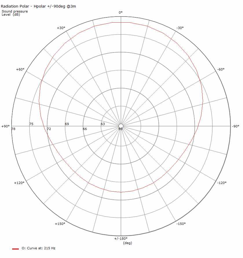

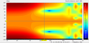

Alright few more images exported from VituixCAD attached. This is same data as I posted yesterday, the sliced melamine sponge prototype, just in different representations and beautified like it often is for the public. I've limited the charts to 100-1200Hz bandwidth and to 90 degree angle, normalized to on-axis. You've seen the rest on the previous posts 🙂
The attachments show the pattern as a line chart and a polar chart as well as a surface chart with old project as comparison. I wish VituixCAD could export GIF animation of the polar chart over bandwidth, that would be nice.
I'm really happy with the listening window response here, void of any reflections and resonances and diffraction that I've always had before and without any bracing or roundovers or slants. Very easy and cheap woodwork. The last image contains comparison of wide baffle closed box proto with very complicated box inside, nasty build, nasty response. I value this smooth listening window response more important personal audio project victory than the polar pattern, which is a nice added bonus. Trade off for all this is mainly losing the bass but bass is fixed by adding 15" woofers to taste.
Anyway, it looks like 90 deg off-axis line crosses -10dB around 400Hz, not too bad 🙂 Mind you, the measurement resolution affects the smoothness quite a lot especially on the lower end of the bandwidth, but still. All measurements I have posted are one side measured in 15 deg steps, 4ms window in a living room situation.

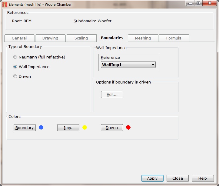

Interesting, so by volume fill I assume you mean simulating literally filling the speaker chamber with absorption material? Never would have thought of that. I tried the LEM approach by filtering the back-wave but it always gave funky results that I wasn't sure I could trust.
As for the port style, Are you making full 3D geometry block for the damping material, or is it just a 3D plane at the port location? If just a plane, I assume the 3D surface normals face inward toward the speaker cone?
Also, for both cases, where exactly in the software you defining the model?
Agree it is much easier to reason about the directivity with the graphs normalized. Can worry about pesky things like resonances later 😀
AKABAK is BEM (not FEM) so we mimic the effect of filling the entire volume by applying a wall impedance to all the boundary walls. Nothing wrong with using LEM for a sealed chamber as long as the chamber is not too irregular shaped or interacting with other components.
Depends what you are modelling. If its a smaller block of damping placed in the middle of a larger chamber then you will have to create the block and apply damping to it's walls. Normals pointing outward.
In the General tab add a wall impedance object (pic#1). In the BEM tab apply that wall impedance object to the BEM object (pic#2). Impedance will be applied to all surfaces in that BEM object.
"Interesting, so by volume fill I assume you mean simulating literally filling the speaker chamber with absorption material? Never would have thought of that. I tried the LEM approach by filtering the back-wave but it always gave funky results that I wasn't sure I could trust."

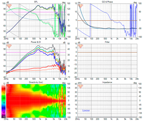

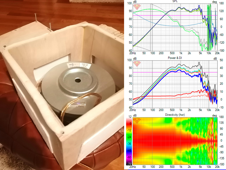

Felt
Here are measurements with felt. This particular felt is made out of plastic if I understood correctly, recycled bottles or something. Few millimeters thick, maybe 3mm.
Tried it on the big enclosure as well as on the small one. It looks like the felt adds the resistance or something on the big box, the acoustic low pass seems to be too low. On the small box, the acoustic low pass seems to be too high. But, the felt seems to have the right kind absorption coefficients since the DI is flat! It looks like the absorption "shape" is right but something else is now not right and I suspect the acoustic low pass needs to be adjusted. I'll experiment further, maybe tomorrow.
There is some kink on the DI around 500-1000Hz, not sure what caused it, have to see if it happens next time and try to address it somehow. These materials tested are very hard, they don't compress much at all in comparison to the Ewona and Melamine sponge tested earlier.
Attachments are
1. control from previous set, the sliced melamine on the ports, one layer Ewona backfill.
2. felt on the ports outside of the enclosure, one layer Ewona backfill. Felt inside the enclosure is bit different, same with felt on both in and out, but the trend looks the same.
3. small box, felt and backpanel. Without backpanel was even more dipole, with back panel this. Next time block top and bottom to get the acoustic low pass bit lower.
4. Also tried Echo Jazz Echoboard, but that seems to give too high attenuation. Gonna experiment with this as well, make it attenuate less somehow.
Polar maps are normalized and the same measurement setting as before. Trying to keep the setup constant and always include a control measurement to compare against. The control box didn't measure exactly like few days ago but it clearly has same characteristics, see post #321.

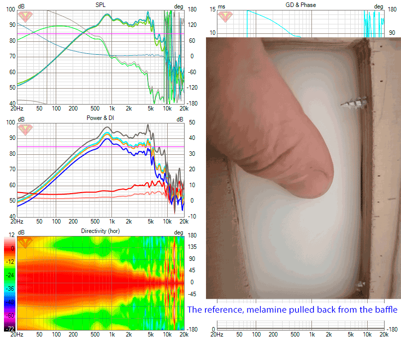

Anyway, tried few experiments on the weekend but not the ones planned. My graphs have turned into stair steps and I don't know why 😀 Maybe something wrong with the measurement setup or maybe VituixCAD update changed how the data is interpolated or something, didn't check the change log yet.
Noticed my jig was getting loose, tightened it up and ~1"/3cm change in the measurement rotation axis. Pretty dramatic droop on the jig didn't change the shape of the graphs at all although DI got bit lower with the more accurate, tightened up jig. Anyway, shows that stairsteps happen anyway, everything is setup the same like last two measurement sets posted earlier.
Depressed on the issue I started to fiddle with the melamine. Pulling the wedged melamines off from the baffle so much so they almost leave a gap on the port. This seemed to widen the pattern control bandwidth below 100Hz. Might be measurement anomaly. Anyway, thought to make another experiment with adjusted damping material with added slices of Ewona in the box corners where there was no melamine (which is was against baffle, like earlier, the control). This seemed to change some reflections inside the box. See the dance between 300-500Hz. notice how the power / Di graph straightens up there.
So, if any embarks such project just take your time to tuning the box 😀 Luckily, this kind of experiments with a prototype box are practically free other than tons of time and coffee, endless variations 😀 I'm not sure any of these scenarios differ much in sound. They would get pretty much the same treatment in the system crossover for example.
Attachments,
1. GIF measurement jig loose / tightened.
2. GIF control box with and without Ewona strip on inside corners.
3. illustrating the pulled back melamine, the melamine is pulled back from the baffle (right of the picture) to almost leave a gap to see the back of the cone.
