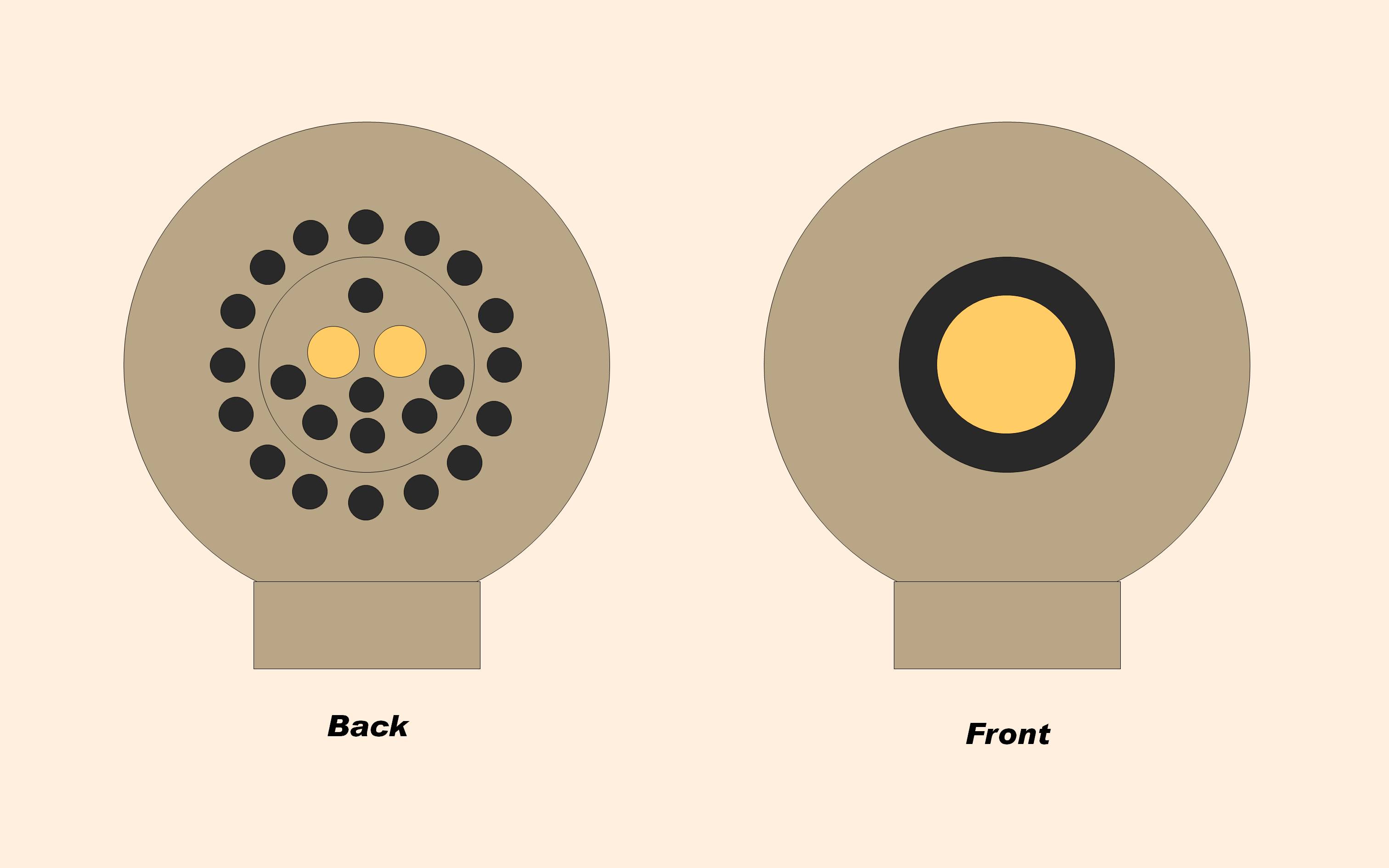

From a build/experimentation view I like the idea of holes in the back so that I can add new ones or fill them in almost at will, whilst still keeping a smart looking front face.
I will build my spheres from ikea salad bowls, 28cm diameter. Which will give a max volume of about 12l, but I can cut this down obviously.
These will mostly be desk monitors, they will get turned up sometimes to fill the room with sound but not anything 'loud'.
So help me out !
What volume / number of holes / wadding should I try ?
Is CHR-70 the right choice ?

after some reading around, it seems that aperiodic design may improve the lower end but only 'quality' not 'quantity' ie bass extension.
Seeing as I want lower bass, it's back to the bass reflex design.
I understood the advantage of aperiodic loading to be a reduction in required enclosure size. 12L is already large for the CHR-70 though, I think with aperiodic loading it could fit into about 5L and give a smooth response. Something I may try myself.
If you've got 12L of space available though, that'll be great for a nice low tuned bass reflex. Let us know how it goes 🙂
Playing with sims 9-10 litres seems optimum for a vented box for chr70. A few more reports back from beta builders (including us) of our dMar-Ken70 should confirm that... the first review was positive.

I really can't make up my mind. Current plan is while I wait for the drivers to lash up a 4.5l sealed box (= next size down salad bowl), and 2x 12l cubes with screw on baffles. One front ported baffle and one sealed baffle.
A flat baffle with the ring of ports around the driver will be much easier than doing the same on the spheres.
Then I will experiment with equalisation and decide between sealed or ported.
