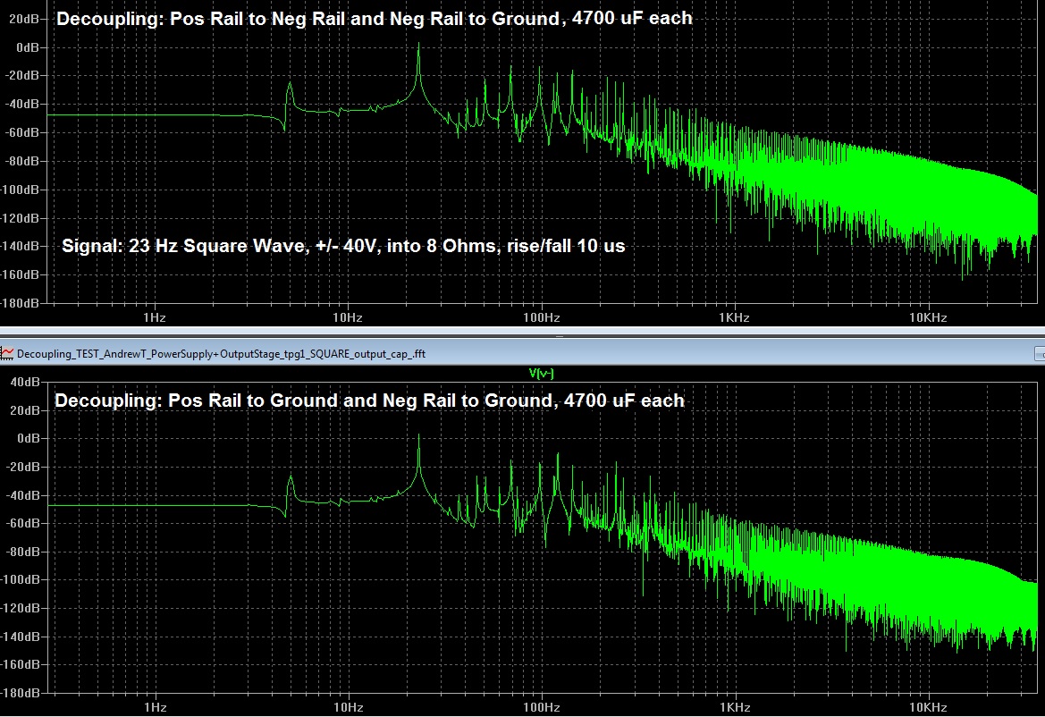

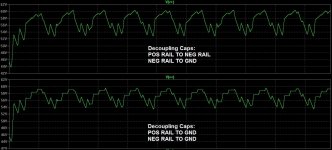

I threw together two simulations, one with decoupling from each rail to ground and one as you mentioned with decoupling from pos rail to neg rail and from neg rail to gnd. I used a +/-40V square wave output signal, into 8 Ohms, with 10 us rise and fall times and 23 Hz rep rate, provided by a Class AB BJT-based output stage model from Bob Cordell (via FAS42, way back when).

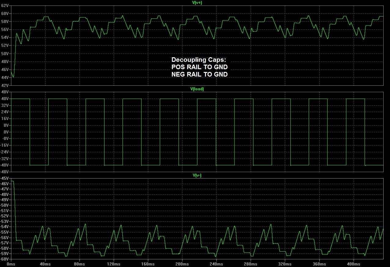

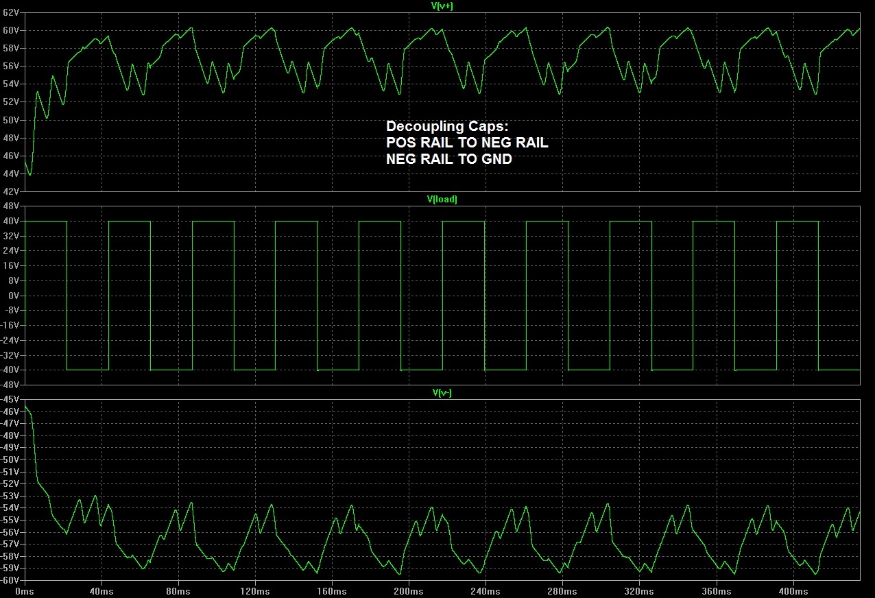

Attached are time-domain plots of rail and signal voltage (square wave at 23 Hz repetition rate). Mains frequency was 60 Hz (giving 9 different ripple patterns, depending on relative phases of signal and rectified mains).
It appears that decoupling pos rail to neg rail has significantly reduced the "stairstep" effect of the charging pulses, in the rail voltages.
Also attached are FFT plots of (the same) 3.6 seconds of data for each of the negative rail voltages. (It probably wasn't really enough data for an FFT, and I didn't time-align it to be periodic overall, but it gives an indication.)
From the FFTs, it looks like the 120 Hz component and its harmonics have been reduced in magnitude, by a significant amount.

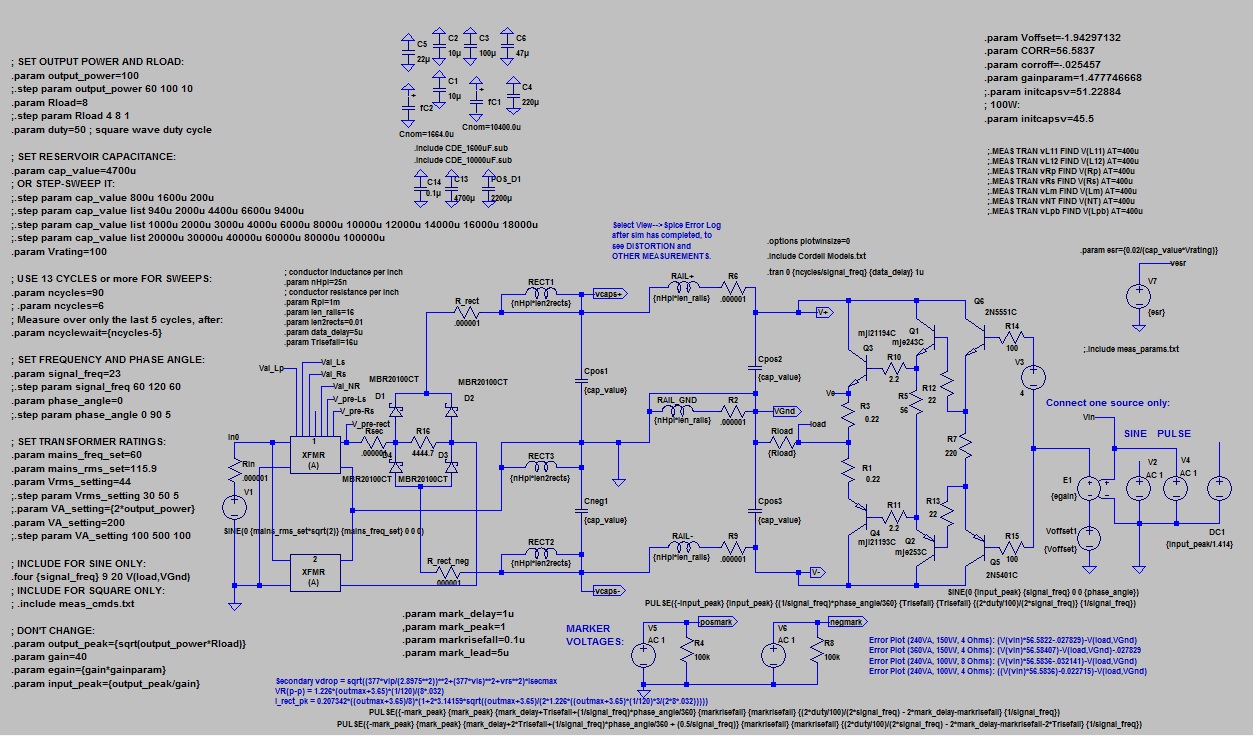

The power supply had one 4700 uF cap per rail and the decoupling caps were only one 4700 uF per rail (with ESR of 42.55 mOhm each).
Sorry about the messy schematic. It was last used for something completely different. For the alternative decoupling method, the bottom of Cpos2 was connected to the bottom of Cpos3, instead of GND.

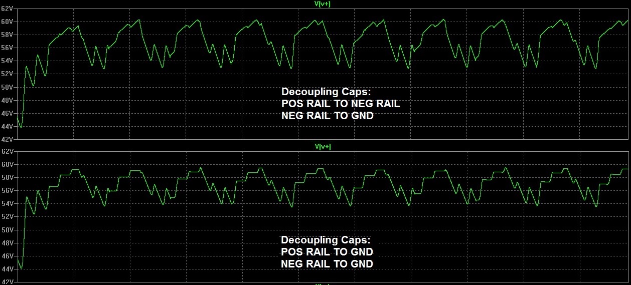

EDIT: Added fifth plot, with direct comparison of the V+ rail ripple, for the two decoupling methods.

It's only when that rail is not pushing the signal. The flat parts are between charging pulses. The rises are when charging pulses are recharging the caps. When voltage is lower, the rises are larger, because more of the charging pulse gets used. The stairsteps' rises thus taper off with an exponential characteristic.
