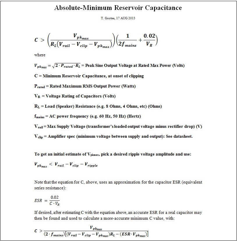

You can't just pull the capacitance value out of the air, or base it on your "opinion" of "the sound", and expect to have an amp with the max rated output power that the rail voltage would be capable of providing. Too little capacitance and the output will clip, well before the rail voltage limit. You can and should calculate the minimum acceptable capacitance, for a desired max rated power. If you then decide to use less than that, then you have to calculate the new (lower) rated max power spec.
The peak voltage of the output signal can only go up to the point where there's still room for the ripple voltage and the voltage across the amplifier itself to sit between the signal peak and the max rail voltage. Higher than that and ripple-shaped chunks get gouged out of the output signal. That's the onset of clipping. Higher still and the entire top of the output signal will get sheared off. The spray of high frequencies inherent in the sharp edges has been known to burn up tweeters, and blow the ribbon tweeter fuses of my Magnepan MG-3.6/R speakers, unless a higher-rated amp is used, so that it isn't approaching clipping at the desired (high) loudness.
We can also easily prove, mathematically, that too little capacitance means that there is a bass frequency below which the capacitors will run out of charge, before the next charging pulse comes along. The capacitance value needed, to be able to reproduce down to a particular bass frequency, also depends on the rated maximum RMS output power, which defines the peak output signal voltage and current if a sine wave is assumed.
But as abraxalito mentioned, music doesn't usually look like a sine wave (except maybe when there's a flute solo).
The most bullet-proof way to calculate the MINIMUM required capacitance is to assume that the signal could be ANY shape, and could be anywhere up to the peak output voltage and current that are implied by the rated maximum output power. To do that, we should always assume that the output signal could be constant DC, at the peak value. Then the amp will never be able to clip, ever, and will be able to handle even the lowest bass frequencies without ever running out of current.
Once you know the max rail voltage (from transformer output voltage and rectifier voltage drop at max current) and the load impedance and the "Vclip" voltage for the amplifier itself (given in LM3886 and LM3875 datasheets, as a plot versus rail voltage), then the minimum required capacitance and the max rated output power are redundant, i.e. if you have one, you can calculate the other. And if one changes, then so does the other.
I attached the formula for calculating the absolute minimum reservoir capacitance.
But it's a whole lot easier to just let a spreadsheet calculate for you. So I attached the spreadsheet version of the formula. You can change any of the numbers in the BLUE cells, and see what happens. (Save the file with the ".txt" removed from the end of the file name.)
Tom

The spreadsheet is a lot easier to use than the equation, and provides a lot more insight. It also gives the capacitance values to meet only the "DC at sine RMS value" type requirements, like most people seem to calculate for, in addition to the capacitance that will handle "DC at sine PEAK value" that the equation gives, which is how I think it should be calculated (and how it must be done, in order to be "bulletproof").
About the only difficult part, sometimes, is finding the Vclip value for the output stage, which is the voltage between the power rail and the amp output, when at the rated max output. It still amazes me that so many people forget that the voltage across the amplifier itself has to have room to sit between the top of the signal and the bottom of the ripple.

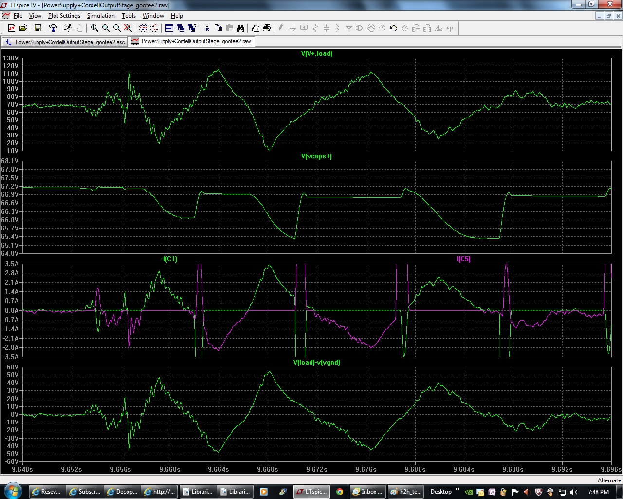

aspringv,
The attached zip folder should contain four files, including a WAV file for testing the WAV input to LT-Spice.
To simplify the setup and usage of the simulation, I replaced the transformer models with ideal voltage sources.
Besides the WAV file, there is a main .ASC file, a .PLT file that automatically sets up the plotting, and the Cordell Models.txt file, which contains the spice models for the transistors used in the output stage.
Just unzip all four files into the same folder, so the ASC file can find the other three.
If you want to use a WAV file input in another schematic, you could just copy and paste the voltage source that uses the WAV file, and then change the name of the WAV file by right-clicking on it. (I think it was entered originally by just right-clicking on the displayed voltage of the source.)
Note that there is also a way to set up a WAV file to be an output, on the schematic. You could LISTEN to the output of any simulated audio circuit! Unfortunately, they don't yet simulate in real time.
I originally used the included test WAV file to simulate DC servo circuits with power amplifiers. It had to be left fairly long (40 seconds) because some of my servos had very long time constants. You might want to download some free wave file editing software, so you can create shorter snippets of the parts of WAV files that you are most interested in using in your simulations, since they run relatively slowly when WAV file data is being used or produced.
In the attached screen image of the LT-Spice simulation, you can see that it would probably be sufficient to simulate with only the portion of the WAV file between 8 and 12 seconds, or even less than that.
Looks like clipping was just barely avoided, at around 9.668 seconds, in the plot detail that I attached. You can see that the voltage across the amp (top plot pane) gets down to about 10 V, while the rail voltage has fallen to about 66.15 V, and the signal peak climbs to about 55 V, at almost the same time. (I adjusted the transformer output voltage and the reservoir capacitance, to get it close, like that.) If you want, you can also plot the input signal, so you can verify when it clips, by comparing its shape to that of the output. Or, there are ways to do waveform math to make a new "difference/error" plot, that will be near zero but will spike when clipping occurs. You can right-click on any plot heading and replace it with any math expression you like.
