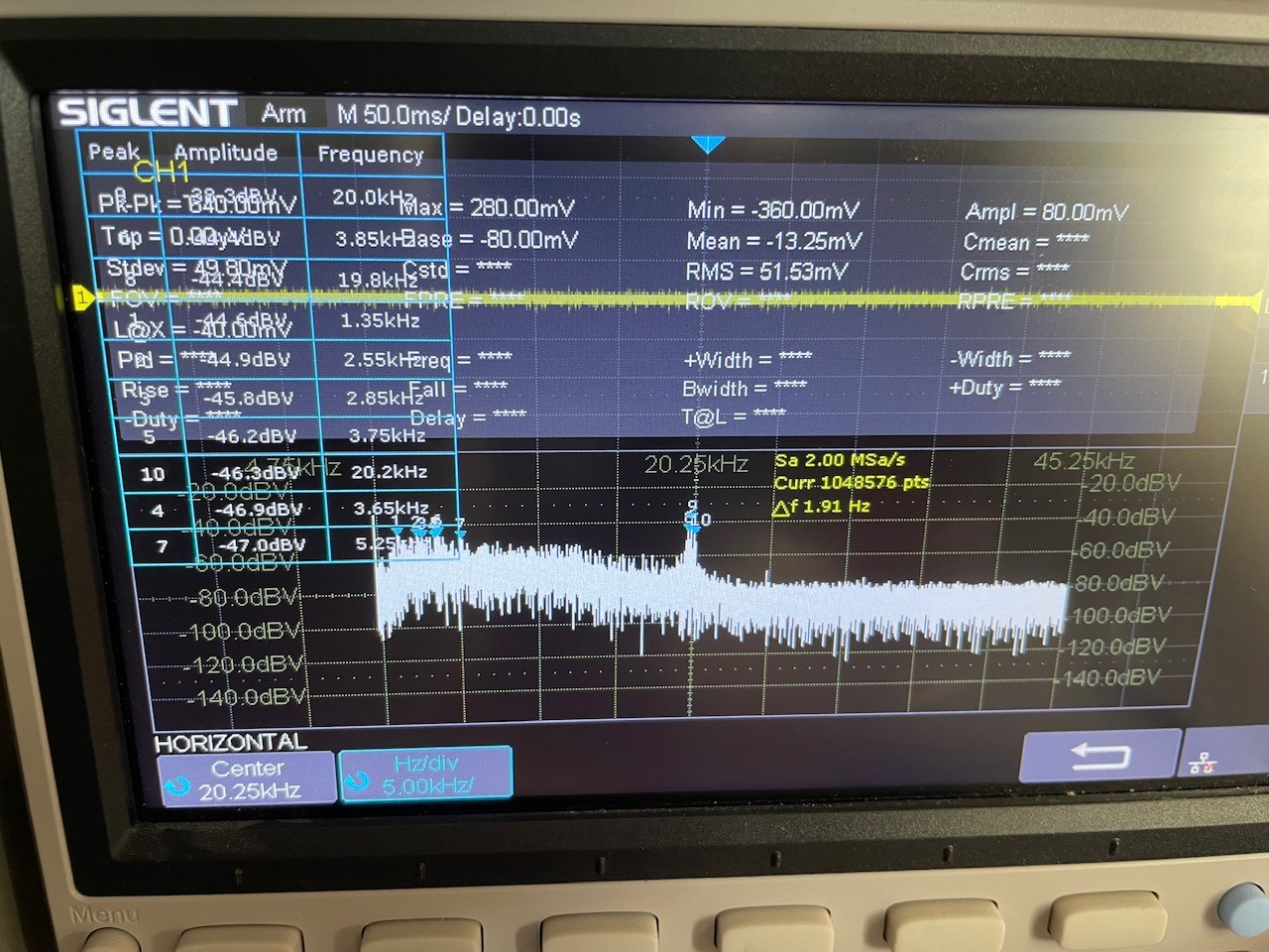

I’ve managed to nail most of the hum, only two issues at max volume:
I will try the normal techniques:
- wide band hiss increasing the noise floor (not so much of an issue)
- a small amount of 50/100Hz hum, almost gone
- a spike at 20kHz that seems to be coming through the elevated heaters, so I think this may be some oscilation:
- dc bench heater
- reverse the heater wires to give 180 from the B+ phase
- adjust the artificial tap resistances
- use a quieter B+ source for the reference.

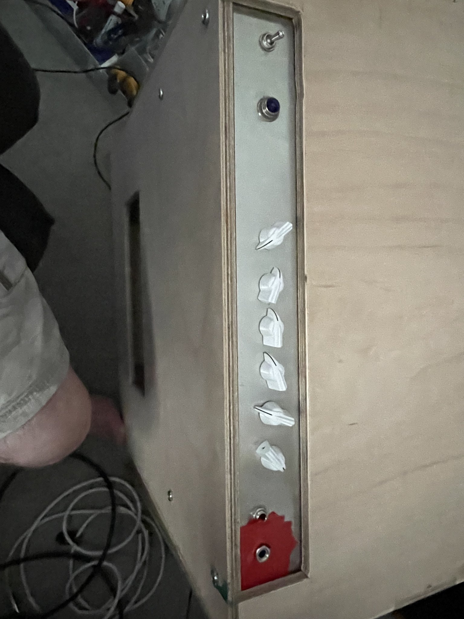

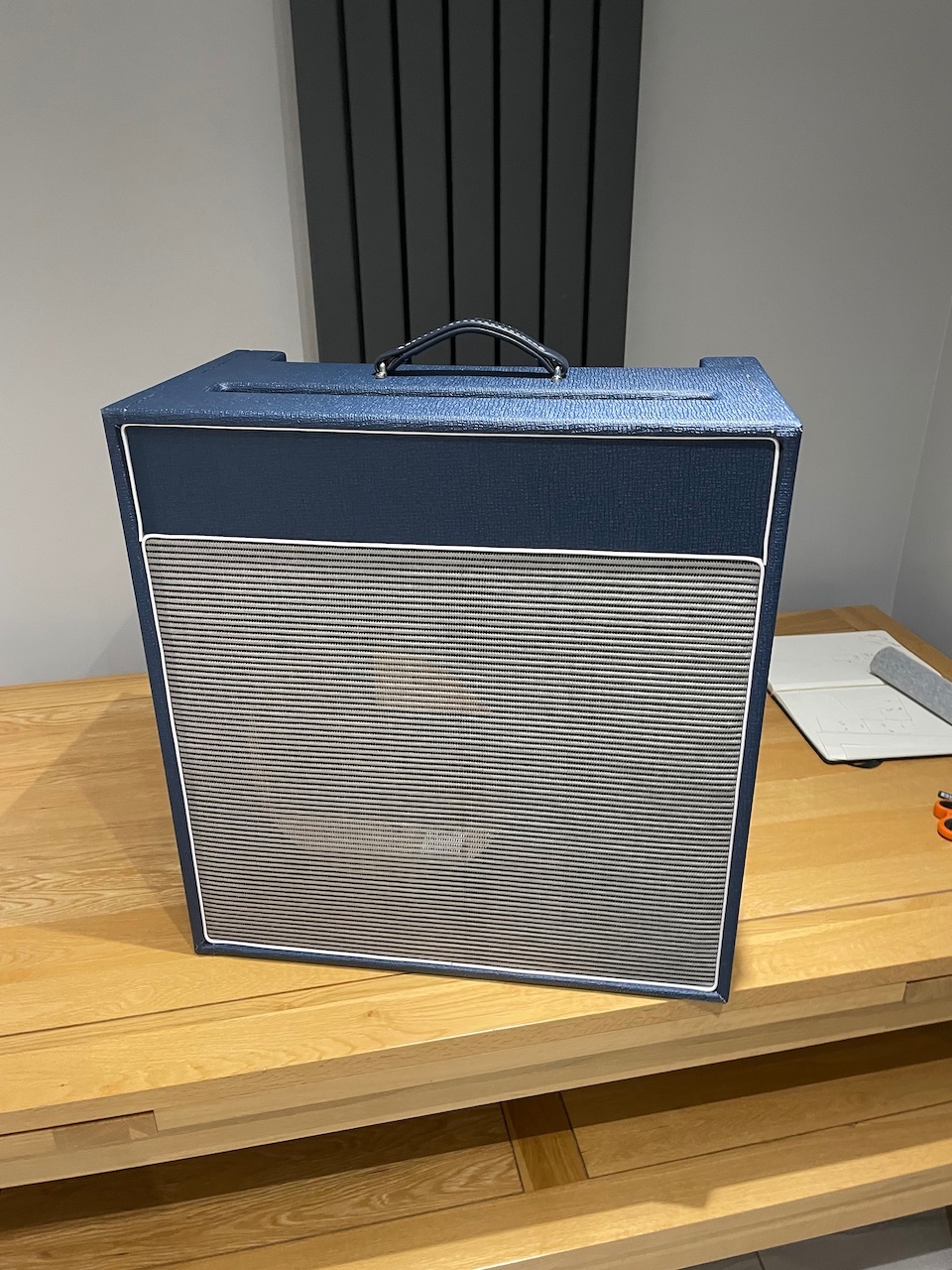

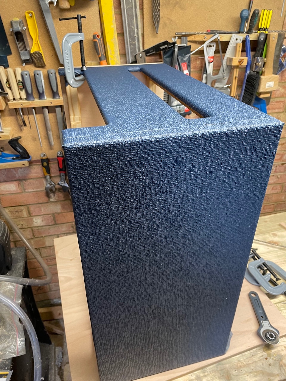

This has moved on quite a bit - this afternoon I managed to get time to put the can and amp together:
Also had a far shorter audio cord so detail has increased. Missing some bass and still need to order all the bits to finish.
Still nees to play around to get a feel for it.
Once the glue has cured, I’ll screw the back on.

Some astute people will see a few more switches:
1. Switchable tube/solid state rectification with the solid state adding a second 47uF cap into the power supply. A diode prevents the tube from seeing the additional 47uF.
2. Switch on the back enables switch between using 240V and 230V primaries.
3. mini switches on the front:
- attenuation bypass - this shorts the top of a 43% Vpp attenuator after the MV before the LTP. This also acts as a bit of a high cut low pass filter. I may add a complete bypass in future but a larger three position switch.
- asymmetric diodes / off / symmetrical diode clipping - these add a very subtle sparkle it's not like a hard clip
- tone stack bypass is another I have planned.
- three way cathode selector but... I have plans to make a switchable JCM800 / JTM45 front end. I have a first iteration design and that will allow switching between the JCM's cascade/cold clipper and JTM shared cathode parallel gain stages. A switch will select the tone slope and a further switch will switch in a pair of volume pots on the back.
- a switch will be planned as I've also got my spinal tap gain stage mod also planned. If that's too much I could always make that a reverb drive/recovery.
