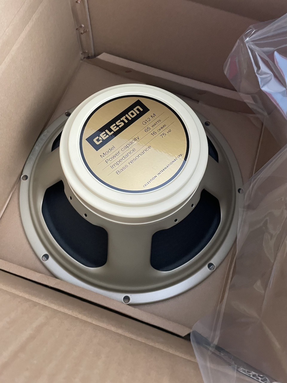

Just a quick update on the speaker piece - that took me down a rabbit hole. I spent last week watching comparisons between the Celestion Creambacks, great backs and the Alnico cream etc. I was thinking of a 10" cream back although the Alnico seemed to have more detail etc but perhaps not surprising given the double the price tag! The only thing with comparison vids is you don't know how long they've been using the speaker.
The G12-70, Vintage 30, Neodymium and greenbacks, blue etc seem to be quite lead/treble focused. I want crunch and good detail. The creamback seems more rhythm guitarist focused.
Now I suspect there's creambacks and creambacks with the different power handling models.

For the speaker choice - there's a reality check that 2W into a 100dB/W/m is going to be loud, very loud. So the search has taken me away from the alnicos and towards something with a lower dB sensitivity. In this case the current plan is a G12M-65 8R which is 96dB/W/m.
I'm aware that this is never going to get anywhere close to breakup, but I can look at attenuating the output transformer to reduce this further. The
Current options I'm investigating:
There is another facet that I'm interested in here - speaker frequency response. So my thinking is that the same switch could switch in a frequency response shaping network so that the resulting speaker frequency response at 10% is similar to the speaker running when the amp is running at full volume in a vain attempt to preserve the tone. However the attenuation and shaping is post build.

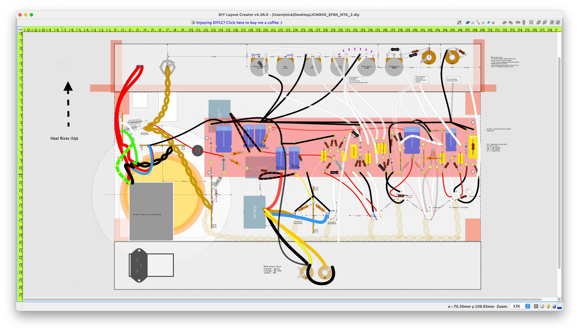

So I've worked through the power supply.
I found a 62VA transformer with 250V 120mA, 6.3V 3A and a 12.6V 1A. If I use a split rectified B+ (one for the pre and one for power) it means I can supply high voltage to the 12ax7 and LTP but supply a dropped B+ to the EF80s through a separate supply to allow for designing in some sag ability.
I'll run the pre section on the 12.6V as regulated DC heaters, but then leave the 6.3Vac heater to the EF80s and the EZ81 I'll add as part of the power section supply. This means the amp shouldn't be running the transformer over 75% on any of the secondaries.
There was a lovely 260+VA transformer with dual sets of 250V 400mA, 6.3V 4A and 50V secondaries.. but way overkill for what is needed.

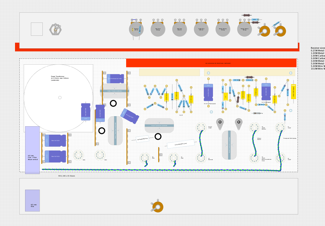

Next up I was thinking if I'm going to hand build this.. do it properly with some nice multi-colour-coded wiring, so I have a wiring colour scheme worked out this morning 🙂
AC mains - follow UK colours: brown (live), blue (neutral) and striped green/yellow (protective earth). The PE will have a grounded bolt to each detachable metal surface - the chassis, the speaker frame etc.
B+ red, 22/24AWG multistrand, 900V insulation, for the pre-amp section running at the higher B+ power supply. This will include B+, between Rplate and plate pin and screen.
B+ orange, 22/24AWG multistrand, 900V insulation, for the power section running the second lower B+ power supply. This will include B+, Rplate-plate pin.
Ground - black 22AWG multistrand/18AWG solid core, the lower the resistance and impedance the better. This could be bare bar or black wire.
Heater 6.3V AC - green, 18AWG solid core, twisted pair. Larger cross section for higher current.
Heater 12.6V DC - white(+)/green(-), 18AWG solid core twisted pair (note this may not be at ground hence not using black). Larger cross section for higher current.
Signal LV <30V - white 22/24AWG, shielded, 300V+ insulation. This should mean any front face controls should be connected with white wire apart from the power switch and 6.3V light. There's a trade off between capacitive increase in the wire that could harm frequency response and insulation/shielding to reduce noise.
Cathode follower elevated cathode - blue 22AWG multistrand. 600V+ insulation. The danger here is that the cathode follower cathode is sat at an elevated voltage V+ so I don't want black and I'm in two minds about blue too.
NFB signal - white or purple, 22/24AWG multistrand. 900V insulation to prevent any accidents inside the chassis then shorting to the output side of the transformer
Output transformer to the speaker jack - purple (+) and black(ground), 16AWG, 300V insulated. Larger cross sectional area for current capacity.
For the wire insulation I'm looking to ensure the wire is 85degC+ to prevent the tube pins form melting it.
The speaker wire, as it's external I'll connect with red/purple and black but connect through a 1/4" plug to the speaker itself - the wire will be probably the same 16AWG wide that is used inside the chassis. Depending if I get a pre-made cable or make one.

I did have a think about if I want to real point-to-point or current board. I'm opting for a turret board but I will probably split the pre and post sections so I can add a reverb section between, or run an external the power stage for experimental playing.
Someone on the telecaster forums made a very good point about heater hum - the 6.3Vac heaters are optimised for AC being bifilar (?) but the 12.6V not having this, hence using a rectified and regulation on the 12.6Vdc heater line. Works for me - I've built many regulators, so should be able to knock something up easily that will support the higher current with minimal voltage drop to fit.

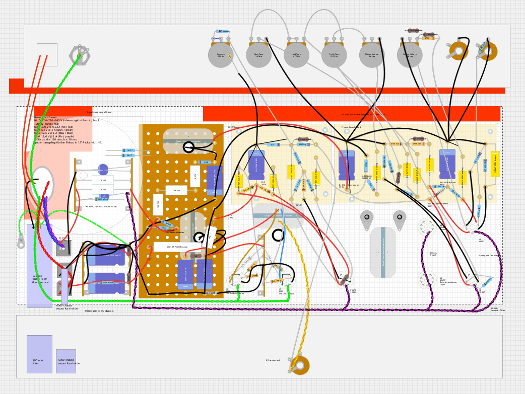

I've been working through this a little more ...
So this uses a 2x0-300V 150mA 139VA transformer that has more heater current - 3A of 5V (SS rectified to 6.3V) for the two EZ81s, plus 5A for the 6.3Vac for all the tubes and the reverb tank option. It also has a 50V so I could elevate the heaters too. The 5V winding would be attached to the rectifier cathode so it would be elevated to about 360V so that a heater to cathode wouldn't see a large voltage difference.
The issue is that the cathode follower cathode sits at 194V and the JJ 12ax7 datasheet states Ukf max is 180V. So it needs a good 70-100V elevation to survive long with JJ tubes (thinking ahead for ease of replacements). A cap can ensure that the CF heater is kept elevated during dips or warm starts where the rectifiers will charge B+4 fast. I can also make the 50V elevation a slow bleed (a few minutes) to match the EZ81 cool down.
So I need to find another option to light the power light on the front panel 🙁 I can't use the 6.3V as the bulb is grounded one side and the heater supply is elevated and the planned fender gem bulb holder isn't going to stand 70Vdc isolation to chassis.

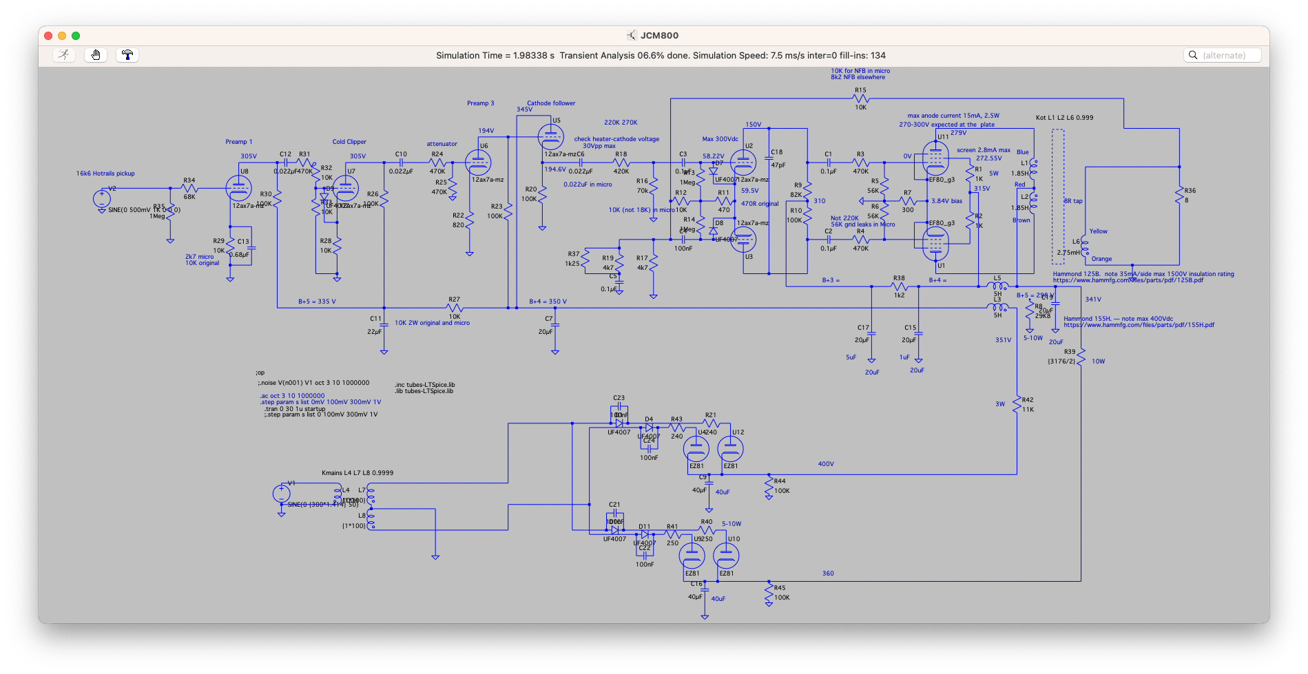

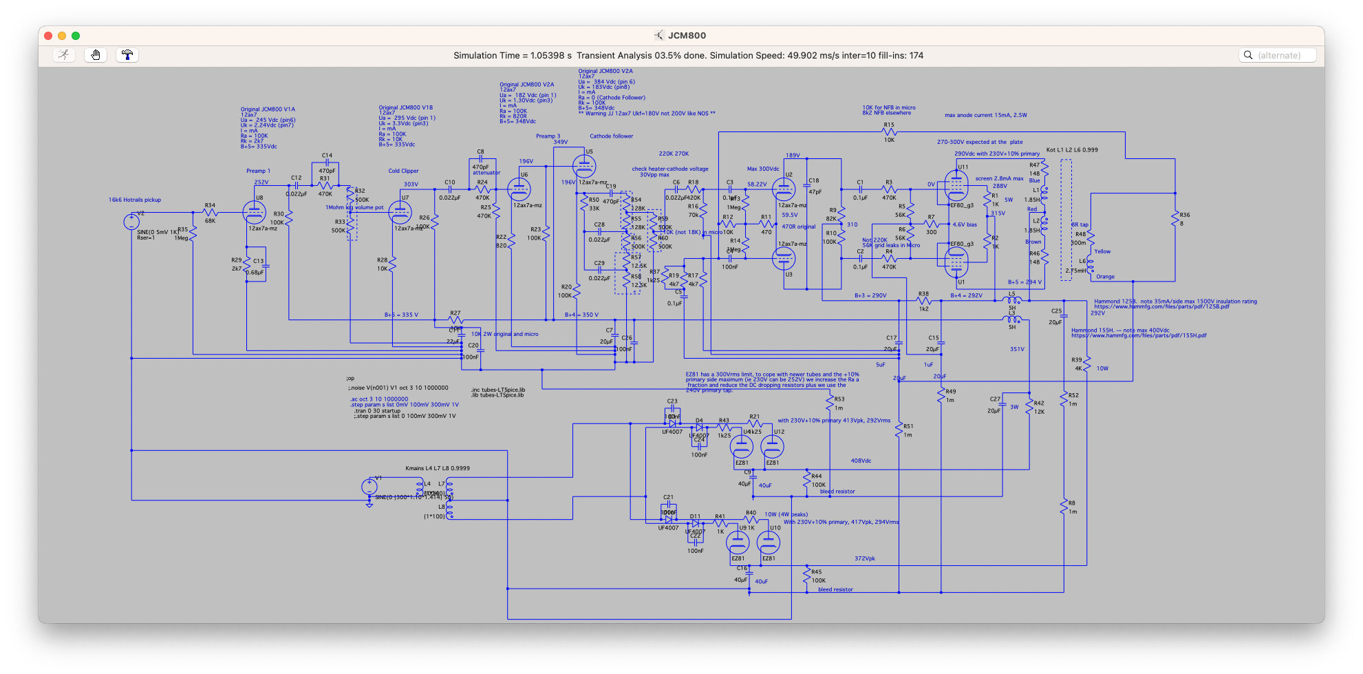

So I've sorted out a problem with my ltspice model (thanks @OldHector) and I've now added the volume pots and the tone stack into the model. Before the amp had way too much gain but the volume pots and tone stack now suck that gain out:
This also has all the grounded configured as I intend to connect it. So I'm feeling happier with this configuration. Ideally I wanted to model this ready for ordering the BOM Monday.
Rob has suggested using a 190-0-190 or a 200-0-200 toroidal. Robs build uses SS full wave rectification but the quoted max B+ is 289Vdc, whereas the JCM front end needs 350V (if the ltp is using a lower voltage).
If full a full bridge SS is used without the CT, then a single secondary of 0-275 or a 150-0-150 (ie 0-300) could be used to give 350Vdc B+.
A hybrid bridge could give that too. In either case the current capacity drops..
If I used a CT full wave like Rob, then I need a 275-0-275 (SS) or 300-0-300 for the same 350Vdc B+.

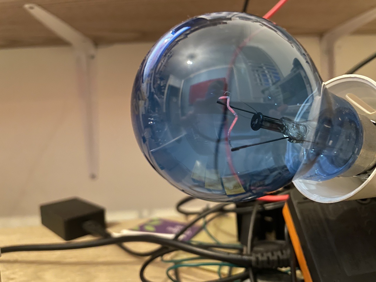

As I was going to purchase the majority of the BOM from one place, and I’d like to use a toroidal, to minimise emi as it will be used for low volume and high gain. Then I’m limited in choice :/
The ez81 is a good way to provide both drop but also load sag, my understanding is the SS will drop from 1.414 to 1.3x under load, but the tube will drop to ~1.2x.

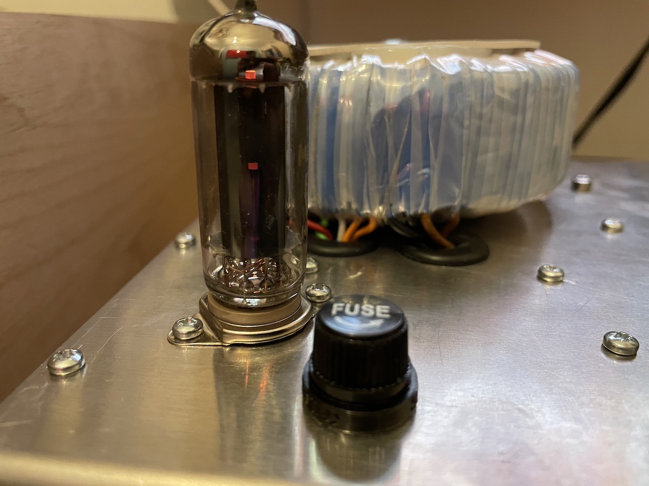

Where I am at the moment - using a 490x200 chassis. I have the luxury of an oversized cab for the 12" so this will fit easily. I'm trying not to go above 500mm so I have options for the cab if it's too large (currently ~26" horizontally).
Still work in progress but the size of components means I can see it will fit. For now I have sacrificed the second pair of sockets for the output tubes (I was going to try a some experiments but I can modify the chassis at a later date and patch holes. I have space to give 40mm between the tubes. I have switch to a two tube reverb and lose the octal socket as I'm not using the 6k6gt. For now these will simply be left empty but I wanted the space in place.
I'm also tempted to shift the tubes along one (I have a reserved spot) to make space for an in-guitar distortion tube (a tube version of a tube screamer) to add a little more optional 'chug' to the JCM sound.

I decided to simplify - this is an amp that can be modified as I go. A different transformer too:
I'll add a switch for attenuating, and I will worry about the reverb at a later date.
This has moved on a little:
So this is perhaps a little cover complex but:
- it has to cope with my 253V wall voltage into the 240V primary - a 5% uplift of voltages.
- copes with the EF80s being low voltages but the pre-stages being true to JCM voltages
- has mods - specifically V1b cathode switch between soldano, Marshall and grid clip, V2 mod (it has an additional tube stage - specifically for modification of the wave form rather than gain) and finally a diode/bjt clipper switch.
- 16R speaker - which along with the low frequency shy OT, is going to make it a puzzle to give it some EL34 slam in a micro format. I'm thinking here possibly making it hybrid to solve or replace the OT later.

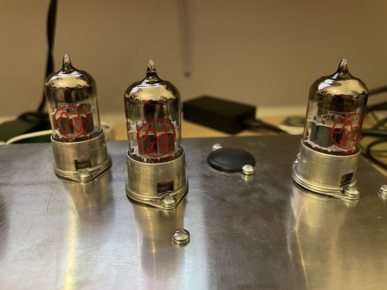

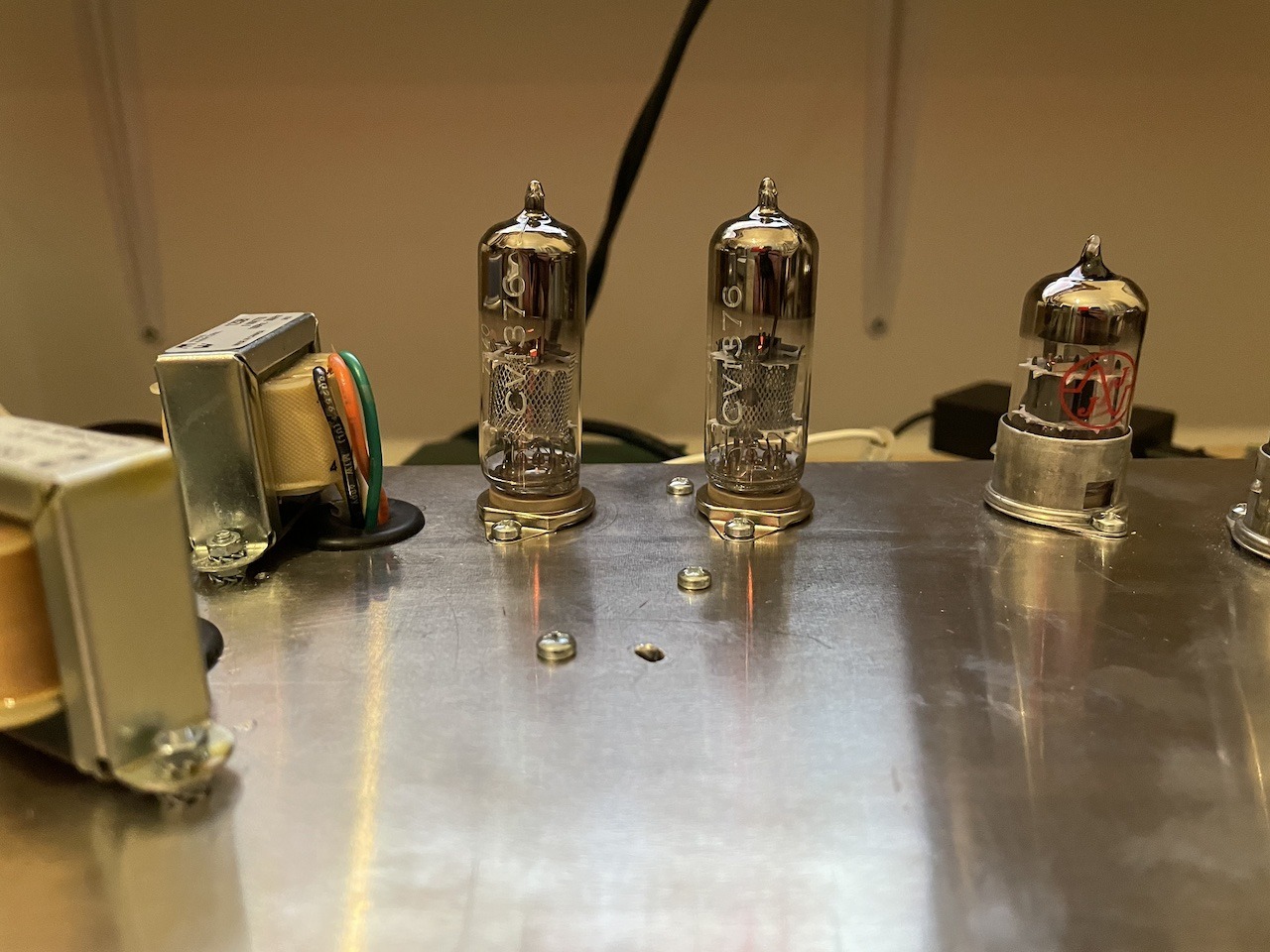

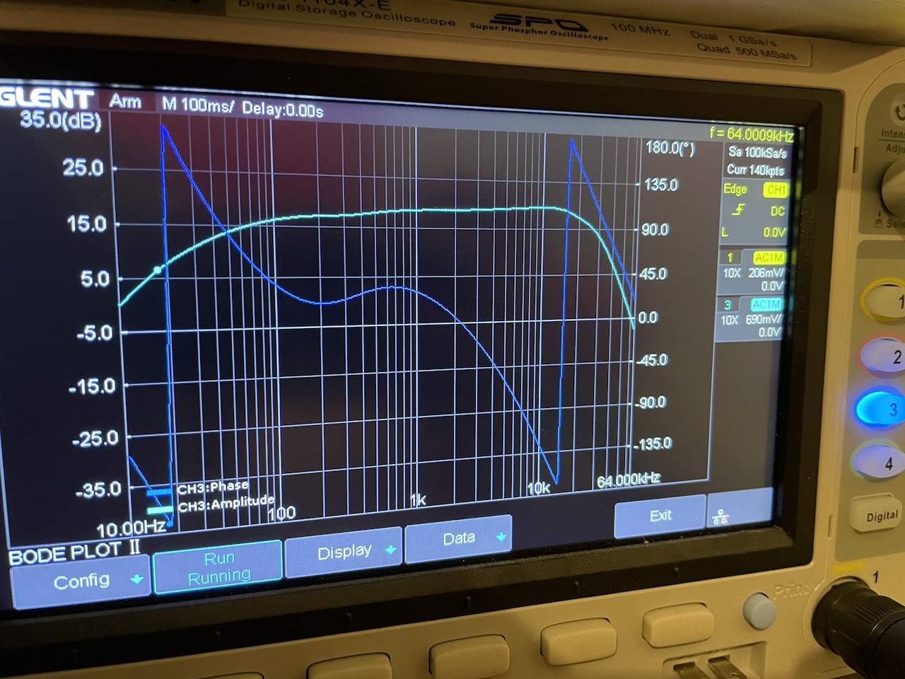

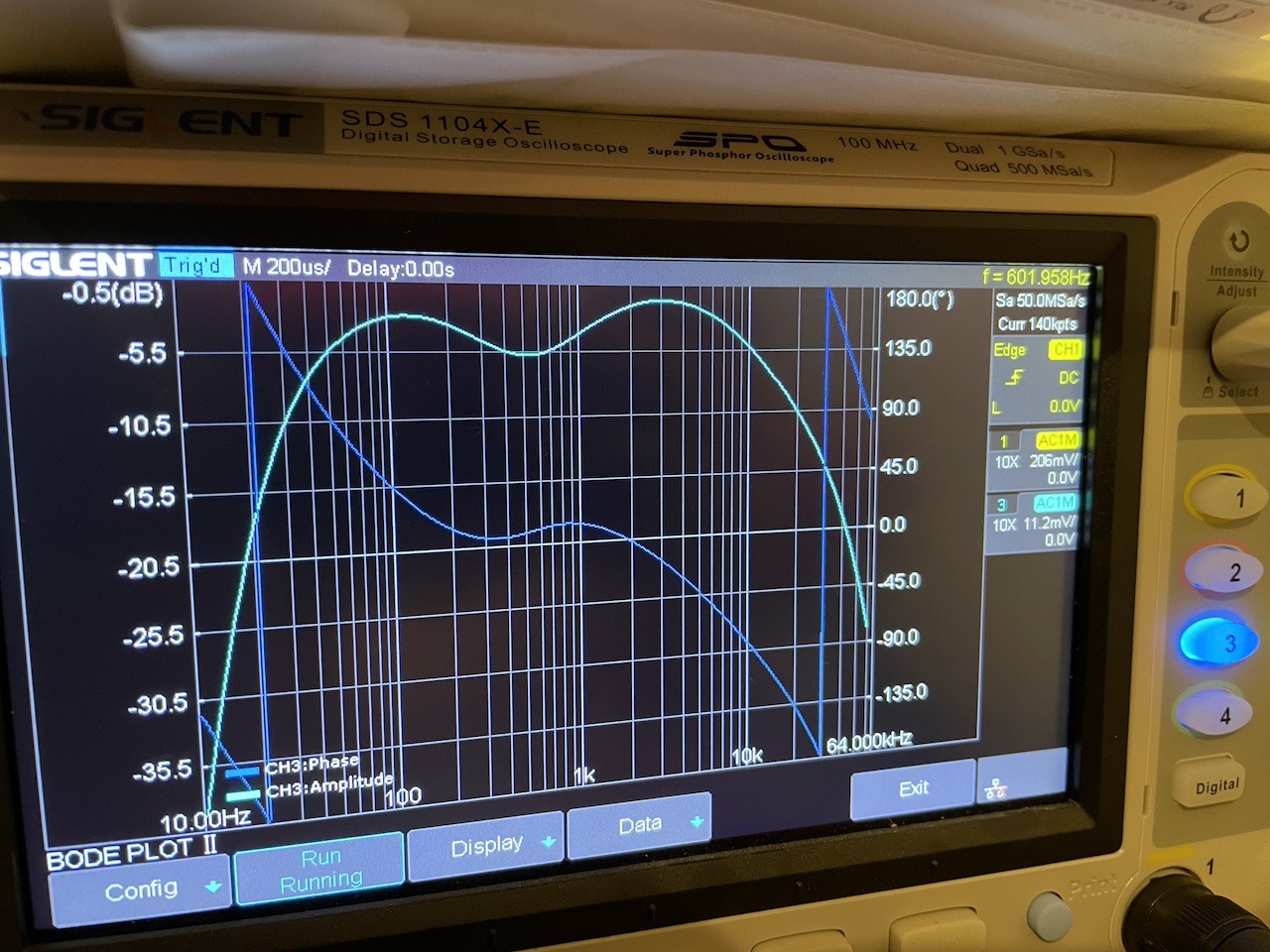

Well things have moved on a little..
I'd forgotten to attach the EF80 grids ... once that was sorted..
Now I have deliberately started with large dropper resistances as details of the transformer were basic to say the least. This is running at low voltages and can easily be bunked up.
I found a 100K resistor I missed off the order in the parts when I directed a dead SMPS a while ago which magically fit between the pins on V2 as the plate resistor. I'm also using a 5k6 instead of the 4k7 presence resistor and a 1M rather than a 25K pot for that. I need to order some more bits so those will be added.
Using the low gain input and a 16R dummy load.
Now turning up the present pot.
The high gain input is even better but for now it's time for bed. It's been a long day.
