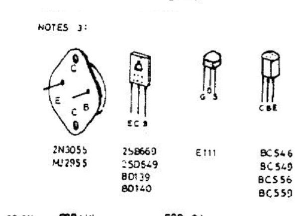

So it seems that a bad MJ2955 was the problem all along. What is strange is that the service manual shows the pinout of the 3055/2955 incorrectly. (see diagram). Maybe that is why i didn't pick up the problem with the transistor initially, I don't know.

Yes that NAD drawing of TO3 case is rather bad. Can't tell which end is the long direction from the holes. Base is the left lead on the bottom looking from the long direction.
